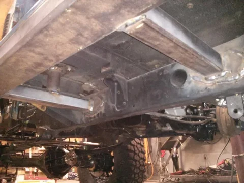

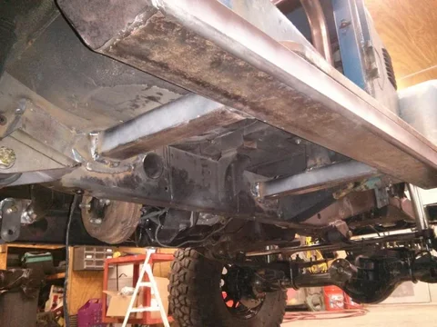

What length shocks you go with?
Where you mounting the tips of the rears?
14“ in the front and 11" in the rear. Was hoping to be able to fit 12" in the rear but couldn't make it happen without violating the Bossman 30 degree rule.
Tops of the rear shocks will be mounted to the back of the rear cross member.
Did you do new upper shock towers in front?
Also, what shocks did you get? I saw bill stein but what model/rate
Yes... f-250 towers in the front.
Billstein 5125's.
