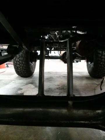

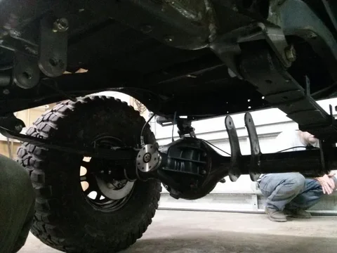

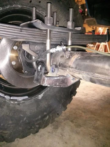

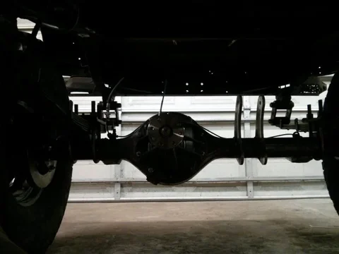

A few updates and a gallery of Jrob fab shots.

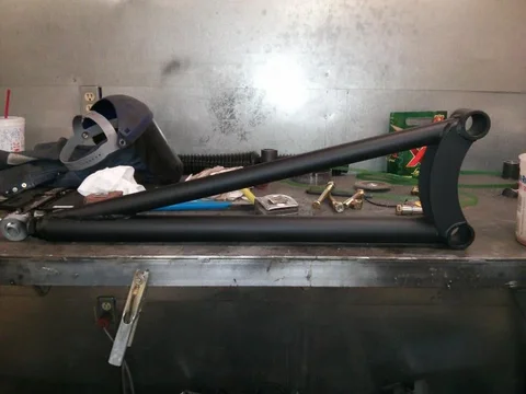

Anti-wrap bar...upside down with paint drying:
Wrap bar front and rear supports:
