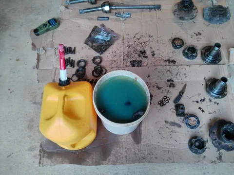

Got some 60 knuckles from Jason at CruiserYard...very well packaged and labeled.
Inventory:
Redneck parts washer:
I'm missing the metal split rings and half moon oil seal retainer pieces, so I'll have to find those somewhere.
Those should be in any knuckle rebuild kit.
You need to get one from CCOT to put all that back together
I've got a full front axle rebuild kit with knuckle and wheel bearings, but it doesn't have the outer pieces that fit behind the felt wipers. In fact, none of the kits I looked at include those. Maybe I'm missing something?
