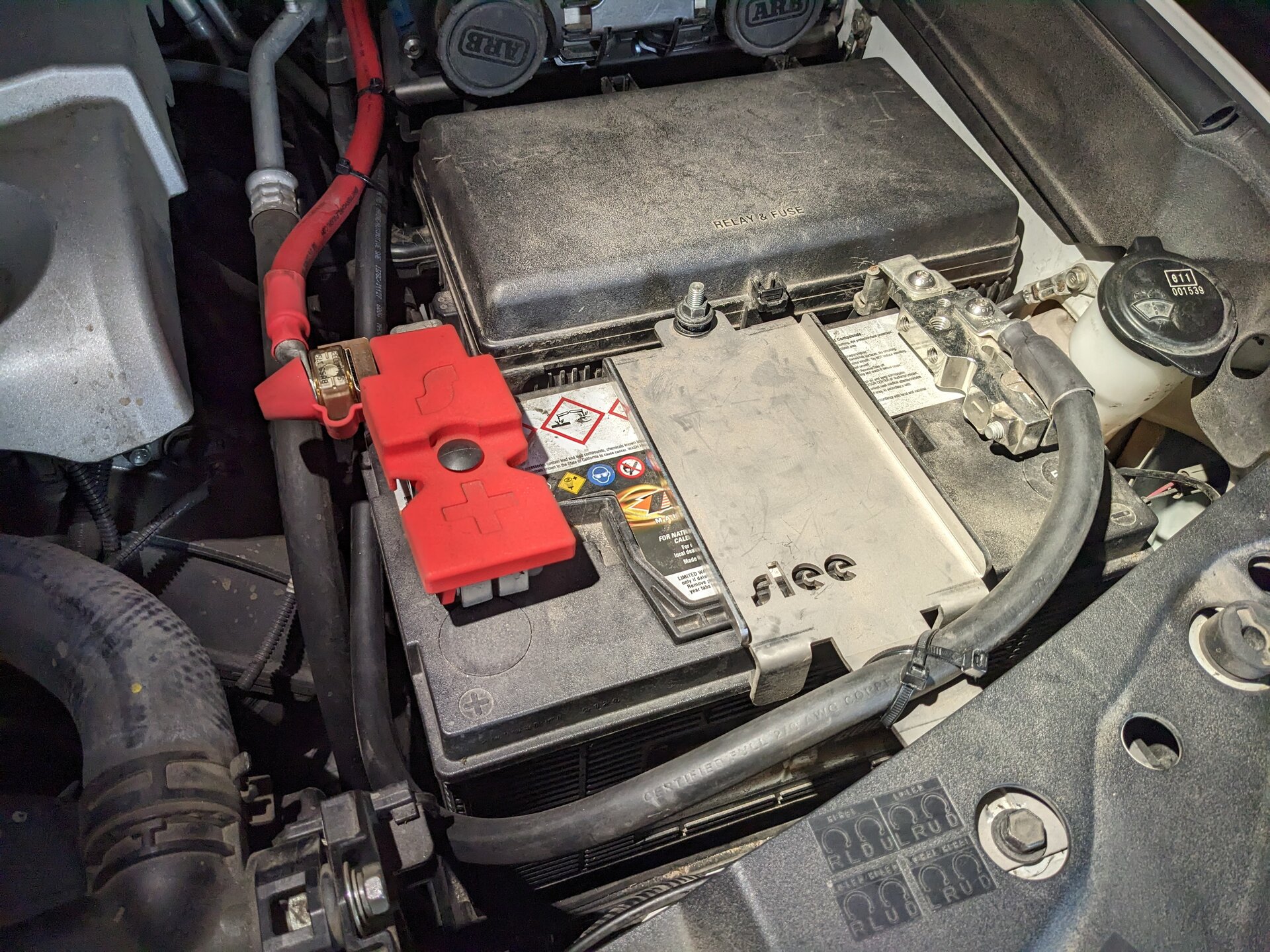

The mod I completed was the upgrade of the main battery to a group 31 Deka 1131PMF battery from Lowes. I used the main battery upgrade tray from Slee along with the Slee extended battery terminals and positive terminal cover. I've got an album of the process here. It's not as detailed as I'd like to get, but it's all I had time for. So far, I've not encountered any issues. My dashcam is able to run overnight without shutting down due to voltage cutoff and there's been no starting issues.

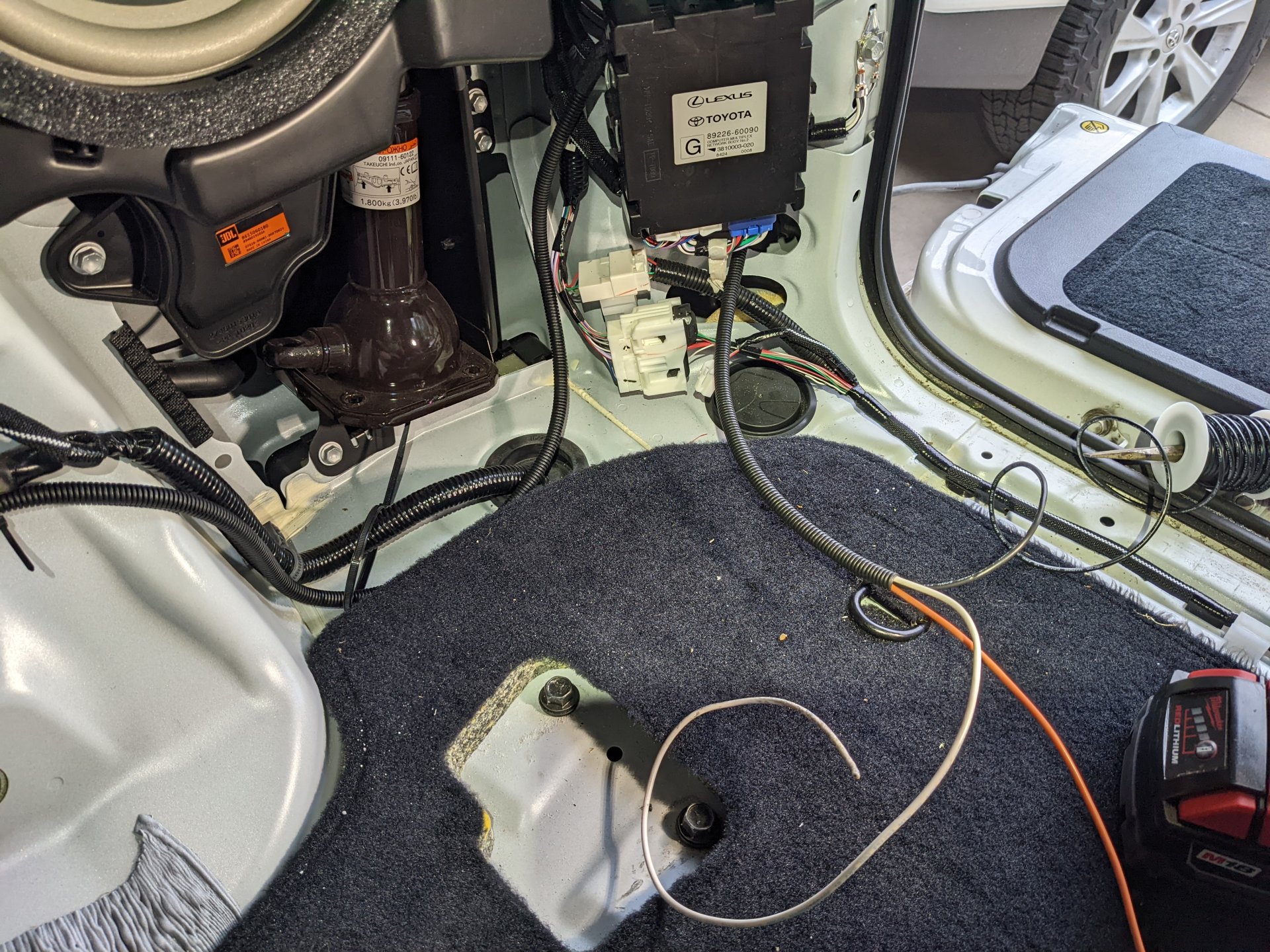

So what was holding me up on the drawer install? Electrical and comms. In my head, I've got an idea for how I want this truck to look. It's a mix of what I've seen on this forum, believe it or not. The idea was to run power to the back before the drawers were installed. I also wanted to have my GMRS and Ham antenna cables run down to the drawers as well. In the previous post, you saw me temporarily install the Gamiviti MultiBrackets on the stock roof rails. The idea was to use the Ford grommets I posted about earlier to be the ingress point for the cable into the hatch and interior of the truck. I also wanted to install two red/white lights on the hatch, like we've Eric Sargent put on Cruisers. I had placed an order for Whelen lights and they have arrived. I went through the massive project of pulling interior trim and hatch trim so I could run wiring for the lights and the antenna cables:
Here you can see the two antenna leads on the left, and red, orange, white, and black 18 gauge wire. The wire was put in a 1/4" split loom for it's run inside the hatch. I don't need rattles chaffing the wire and causing a short. You can also see in the top right the L shaped rubber grommet. This is the Ford grommet and it fits perfectly in the stock hole. At the top middle where I used the factory boot to run the wires and antenna leads. This boot has the window washer fluid tube in it. There was plenty of room for the wiring, but running it through the boot was a lot of work. It took a long time to get my wire pull through the tight corners. A tip for those doing this, you can see the white plastic ring that's still in the boot hole on the hatch. That should have come off and I should have clipped that back on the boot _before_ putting the boot back in place. I didn't realize that and it took me a while with small picks and needle nose pliers to get the boot wrapped back around that white plastic while it was in place.
Here's a couple shots of the interior rear passenger panel removed and you can see more of the split tubing I used once I got into the headliner. That split tubing ran from the boot ingress point, above the headliner and down the D pillar and over the wheel well.
You can see in that last photo the two split looms coming out behind the middle row passenger seat near the wheel well. One of the antenna leads was shorter than the other due to turns it had to make coming from the roof rails. But that's a problem for another day.

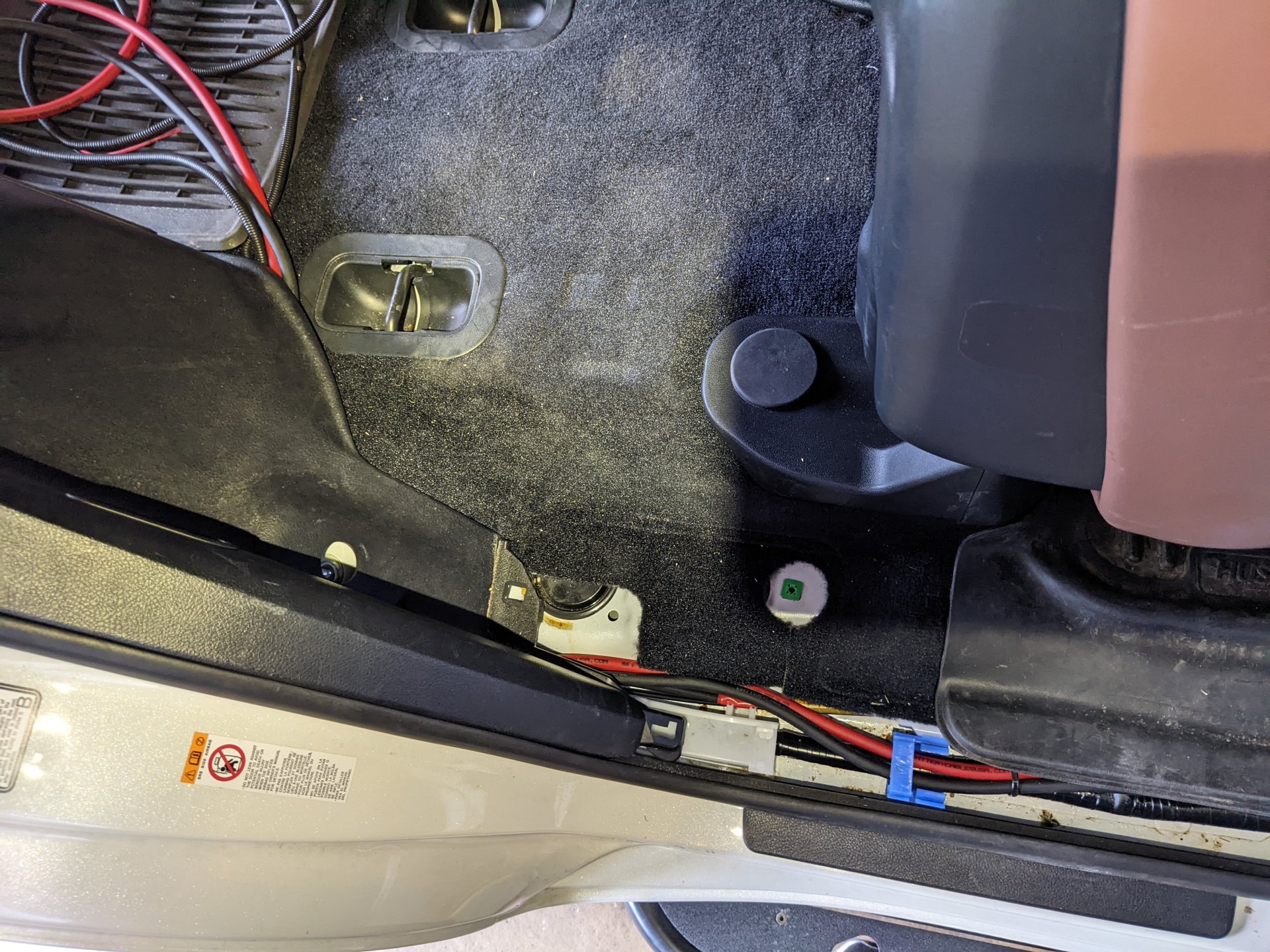

Here you can see that I started by removing the door sills from the passenger side. I decided not to run the wire through any loom simply because this is _thick_ jacketed wire. It's from Battery Cables USA from their Extreme Dual Jacket series. I started from the rear and ran the wire through the factory harness strap downs.

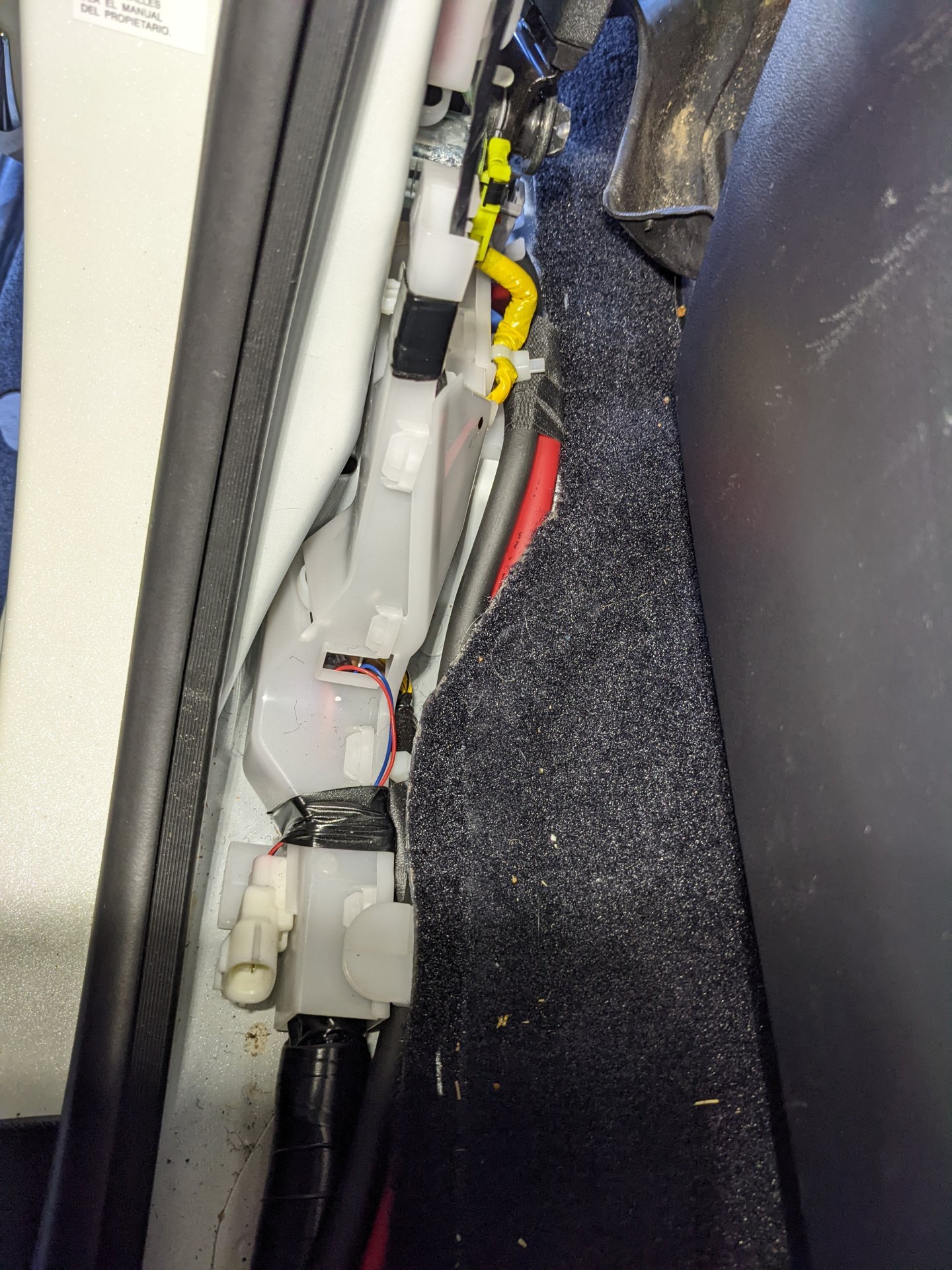

Here you can see the wires passing by the B pillar. It was a very tight fit, but it did fit.

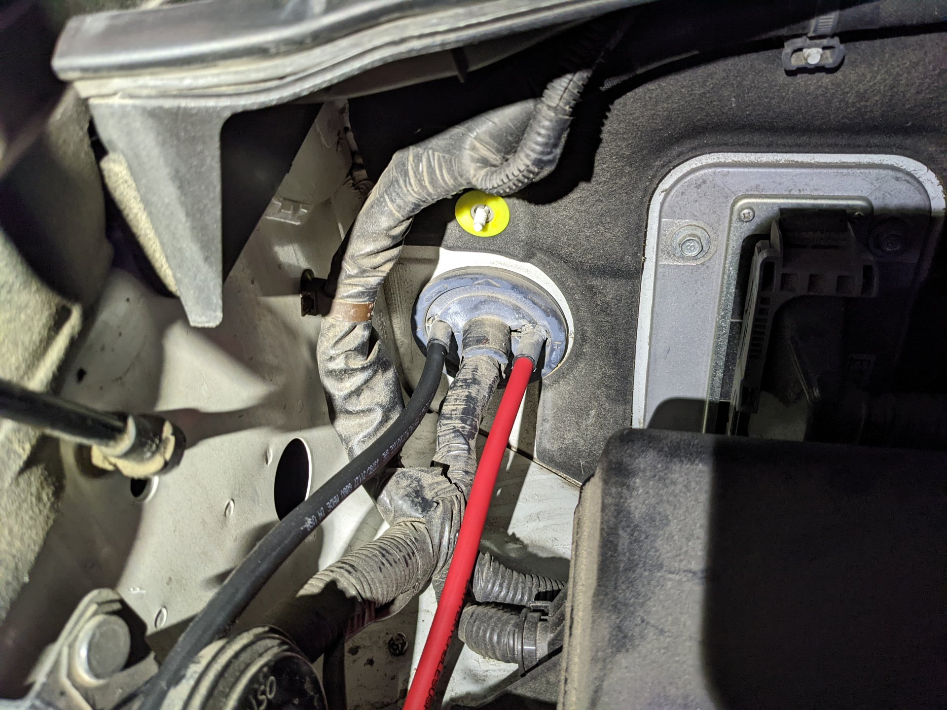

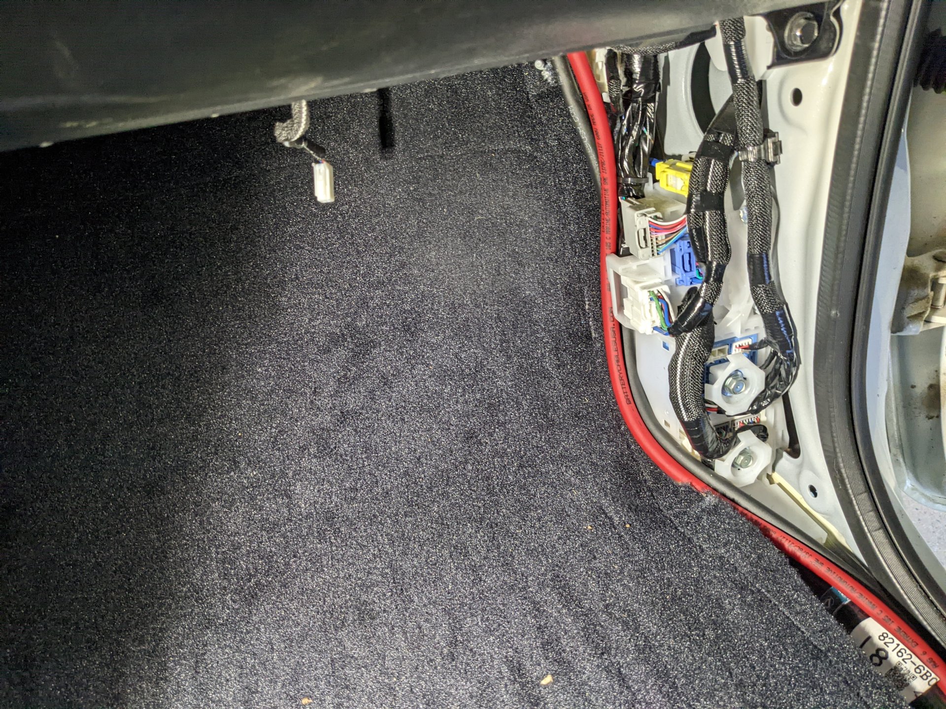

The cables followed up the foot well and passed through the firewall in the stock grommet location. I snipped off the two nipples and used some dish soap to lube up the wire. They passed through the nipples easily.

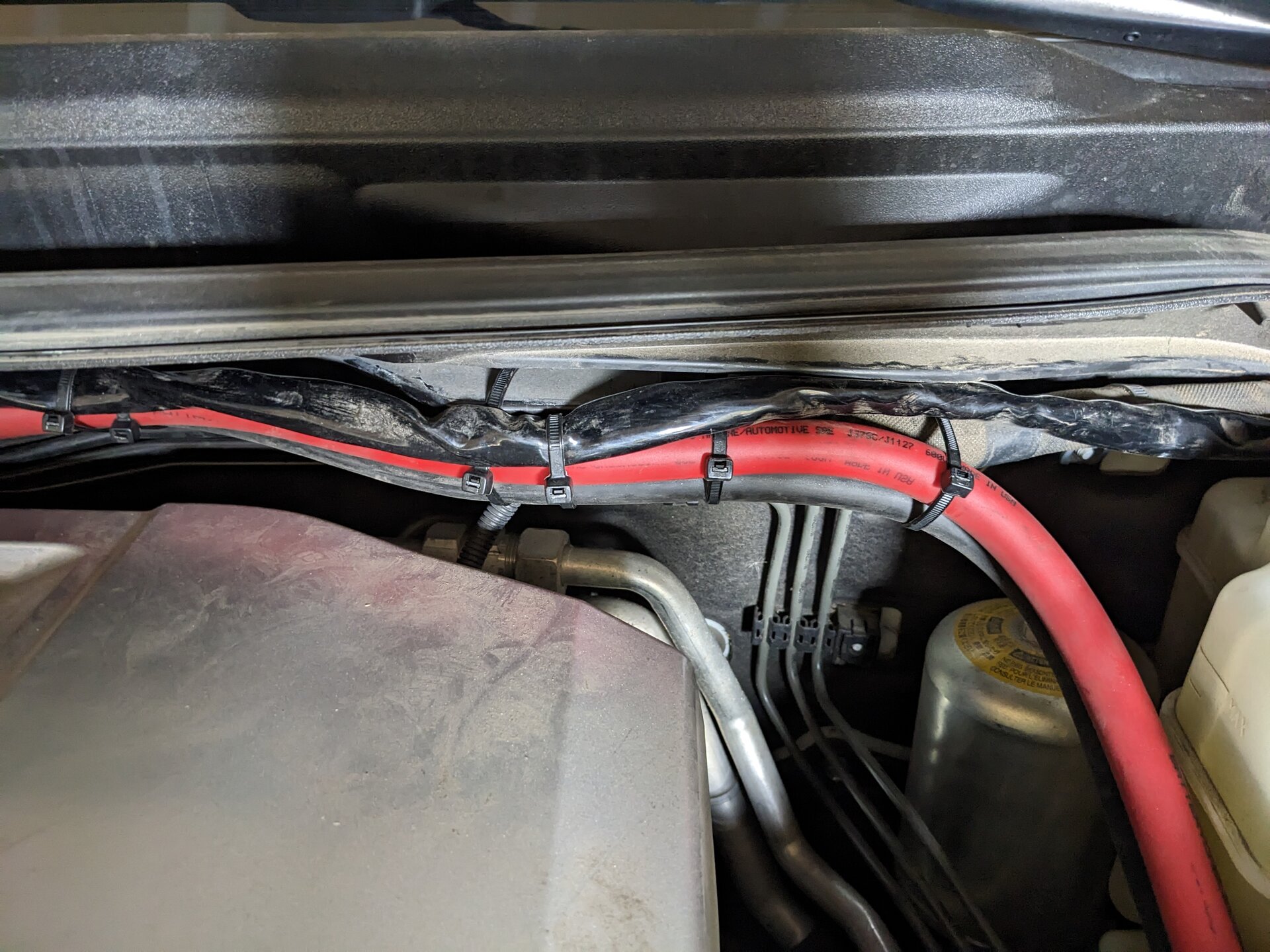

Here you see them entering into the engine bay. They were tight coming through the nipples so I don't see a need to use silicon on them for water intrusion protection.

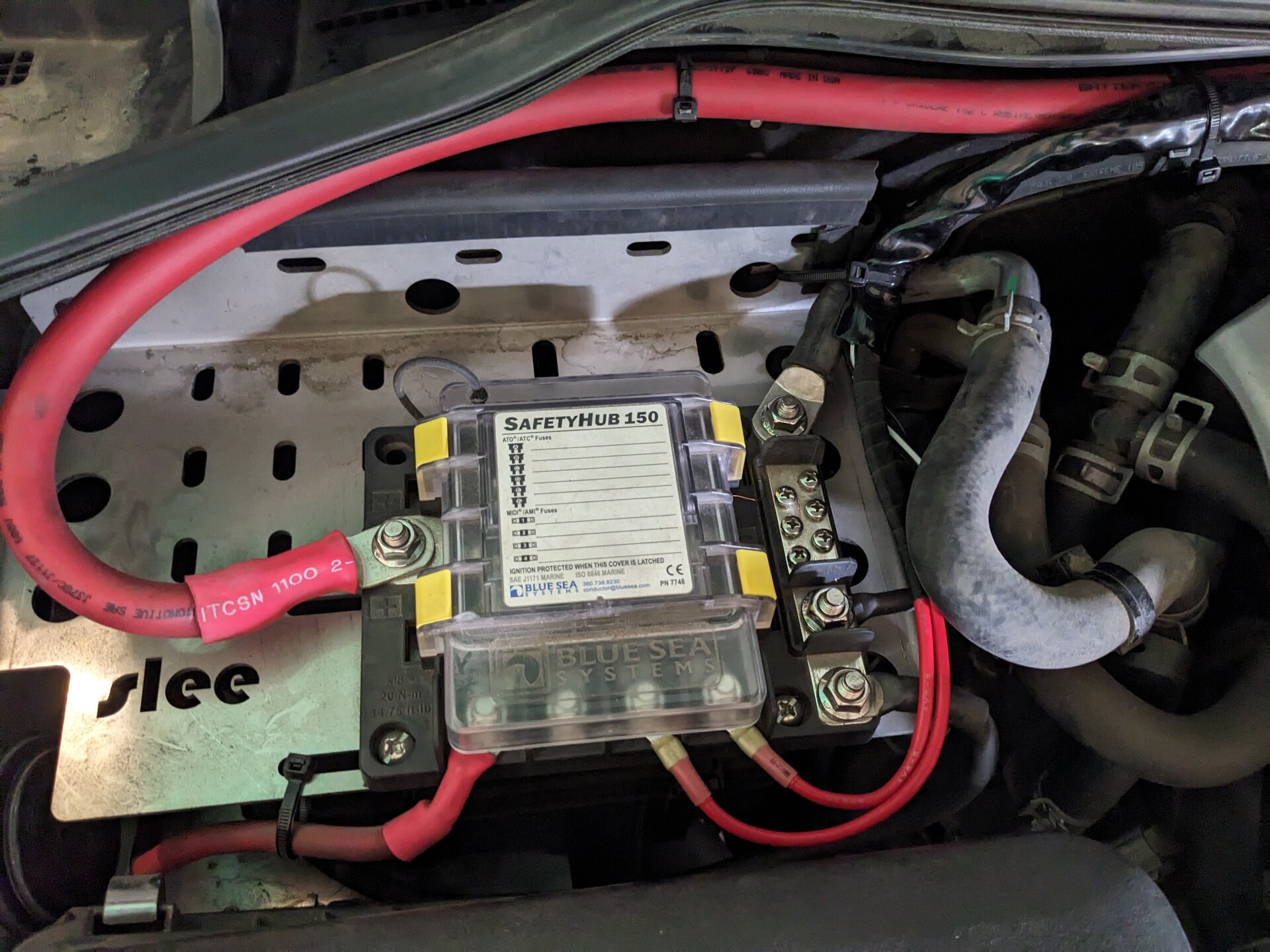

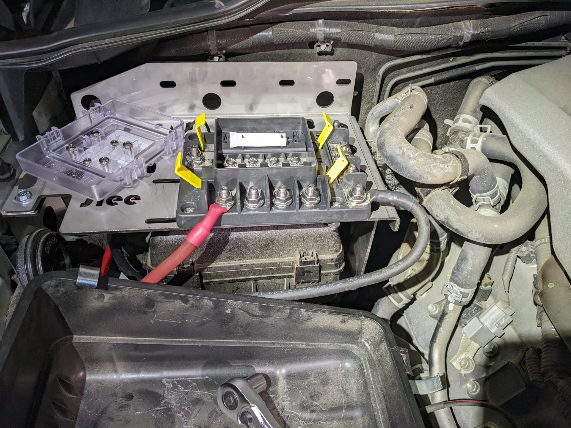

Here you can see their final position mounted to the SafetyHub 150. The lugs were crimped with a hydraulic crimper and I used adhesive lined heat shrink to protect the cable jacket. As you can see, the SafetyHub is not charged. I have some 1/0 gauge wire that I need to run to the main battery. I was thinking of running the wire along the back of the engine bay and zip tying to the factory harness that runs there. However, I'm trying to think of the best way to run the wires to the battery once I get to the driver's side of the bay. If anyone has any ideas, I'd love to hear/see it. I want the cables to be as out of the way as possible, but 1/0 is pretty big cable. I spec'd 1/0 gauge because in the distances I was looking at, it could handle 150A without issue.

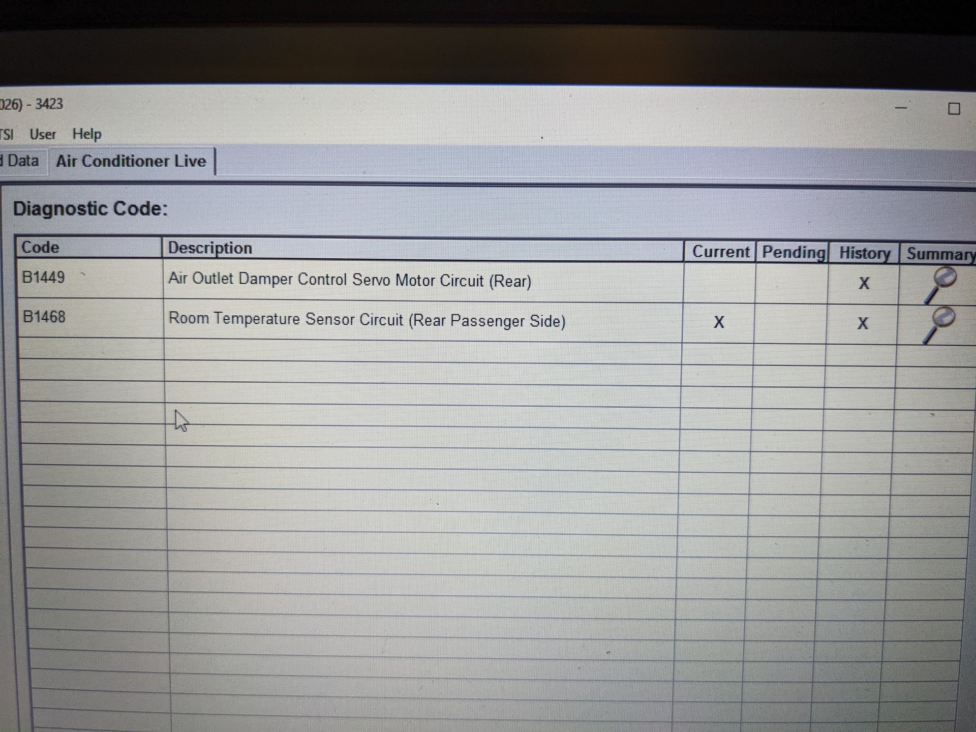

I had an issue. The AC in the rear of the vehicle was blowing hot. It had been doing that for a while; most of the summer of 2022. This became an issue on a very warm day on the way home from a soccer game where the little dude in his car seat was getting blasted with hot air. I decided that it was time to get to the bottom of this. I did what any sane person would do, and started searching for posts here on Mud. I came across several threads mentioning an HVAC servo motor issue most likely caused by an HVAC computer firmware issue. To diagnose this, you could go to a dealership and have them plug in TechStream and get a diagnostic code, or, you could do it yourself with hacked TechStream software and sketchy OBD tool! Obviously, I chose the sketchy method because it's way cheaper. Last year I purchased a TechStream ODB tool from vxDiag. Back then, I installed the cracked TechStream software on a dedicated laptop that will never touch my internal wifi. I plugged the tool in and turned on the truck. I saw this:
The error that people were referring to is the above error B1449. This error is kicked if you run into the HVAC firmware issue. So I scheduled an appointment at the local dealership. They couldn't get me in for nearly a month. Great. So I waited. But, what is that other error code? Room temperature sensor circuit (rear passenger side)? Why does that sound familiar? For days I was thinking about this. I found out where that temp sensor is located (under the cup holders, in a cubby on the rear passenger trim piece). Why would that be not working? Remember above where I took out the rear passenger trim piece in order to run the wires for the hatch lights and antenna leads? In order to take out that trim piece, there is a single harness connection. Guess what connects to that two-wire harness? The Room Temperature Sensor (Rear Passenger Side). Crap. I had an idea of where the sensor on the trim piece plugs in. Here's a photo of it:
Its hard to see, but it's sitting loose next to the black floor grommet in the middle of the photo, directly behind the loose split loom with orange wire in it. I didn't want to take apart the entire drawer system just to plug the harness back in. Hell, at this point, I wasn't even convinced that this harness was the cause of my AC issue. So I sat and stewed for a while. Then, about a week before the dealership appointment, I decide, ya know what, just pull out the jack cover and see if you can get your hand up in there. So I tried it. And I could feel the dangling plug, and I could feel the corresponding plug on the trim piece. After about 10 minutes of fidgeting, I was able to seat the connector. I waited for the next day and tested the AC again. It worked perfectly. It's continued to work perfectly since that day. I was so pissed at myself. This whole time (since summer 2021 maybe???) the AC hasn't worked because I forgot to plug in a harness. I think the harness was forgotten back at the end of summer 2021 when I removed the trim piece for a second time to try and replace a nutsert that I incorrectly installed during my Victory 4x4 molle panel install. Incidentally, I fixed that nutsert when I ran the wires for the light/antenna leads this summer. So that's perfect now too.

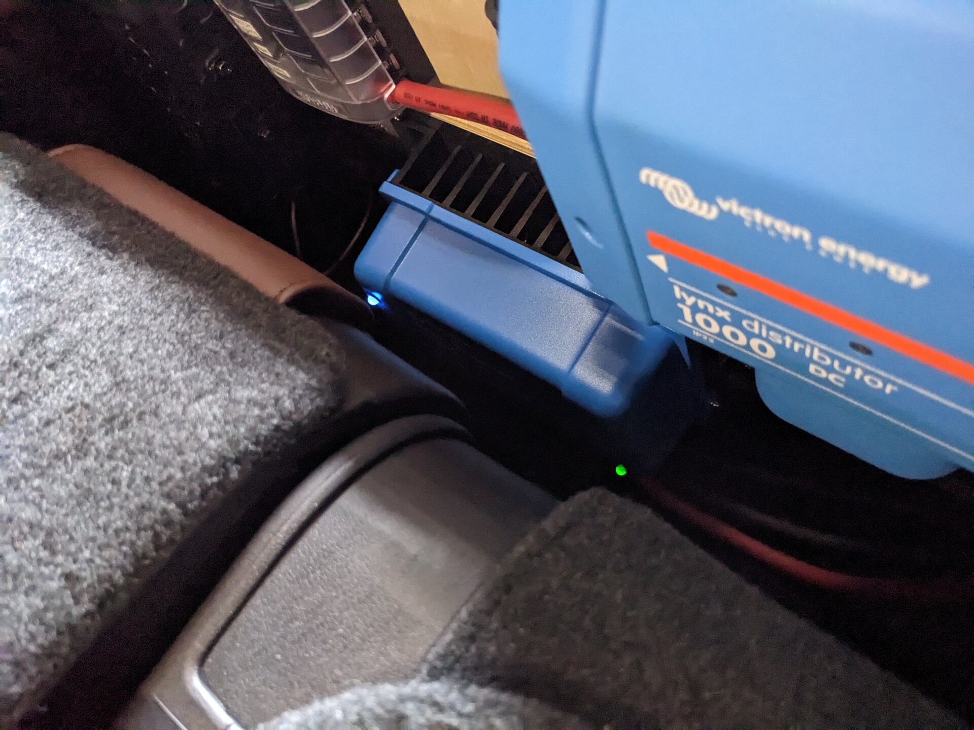

  • Victron Orion 12/12-30 DCDC charger w/ aluminum backing plate (heat dissipation and non-flammable contact point per the manual)

  • Victron Lynx Distributor (this is much easier than fabbing up a smaller fuse block)

Victron really put a lot of thought into this distributor. It has the exact amount of fuse terminals a DC system would need, even to accommodate two methods of DC charging. I have the vehicle's negative running to the bottom middle "sytem-wide" ground mount on the Lynx. The vehicle ground is the same as the house ground because I'm using the Non-Isolated Orion charger. The Orion then has it's negative OUT going to the Victron's negative bus bar in position 3 (counting from the left). The Orion positive (which supplies charge to the battery _or_ to act as a power supply if there's no battery to charge) then goes to position 3 positive bus bar utilizing a MIDI 60A fuse. All connections to the Orion have been made with crimped ferrules and heat shrink. I have left enough slack in those cables to add a Victron solar charger directly next to the Orion and under the Lynx. That solar charger would then mount to the same aluminum plate and connect to the Lynx in position 4.
One of the ways that Orion knows to start charging the house battery is by sensing the voltage on the vehicle's battery. While this does work, it can produce undesirable results. What if I wanted to charge the vehicle's battery? The Orion would see that as a higher voltage then kick on it's charger. This would have the effect of essentially draining the vehicle battery in order to charge the house battery. There is another method to kick on the Orion's charger. Another smaller gauge, fused wire will be run from vehicle ignition to the Orion's L trigger port. When the vehicle's ignition is on, a higher voltage will be detected on the wire running to the L trigger. This will tell the Orion to start charging the house battery (or for the time being, to turn on as a power supply). Using this method, I won't rely on the vehicle battery's voltage as a means of starting/stopping the Orion.
Position 1 is being used by the Blue Sea 12 fuse block. That fuse block currently has both radios fused in, as well as the runs for the Whelen lights that will be installed on the rear hatch. I have the lights, just haven't had the proper weather to install. The fridge will also get it's power from that fuse block. When I purchase the 100Ah LiFePO4 battery, I will also purchase a Victron dedicated shore charger for it. That will also live under the driver's wing on the Trekboxx. It will be wired to the Blue Sea fuse block as well so that it can be fused properly and charge the battery.
Position 2 could be used for an inverter at some point in the future.

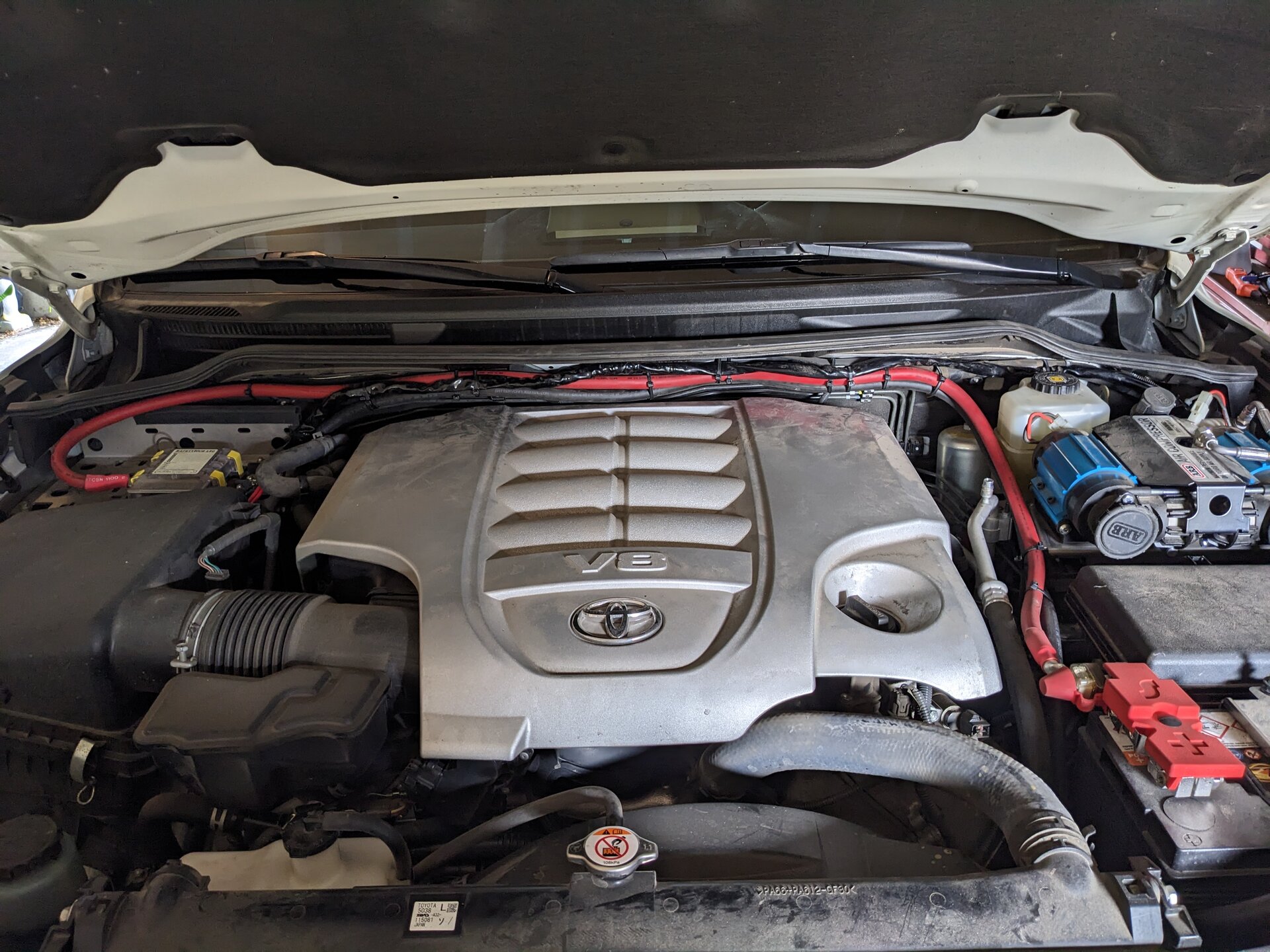

It's been a while! I finally was given some time to finish the wiring from the starter battery to the SafetyHub 150. Here's a photo of the completed work:
This was a lot of work. I know it doesn't seem like it, but I tried a different routing path. You can't really see it in this photo, but on US Driver's Side in the engine bay there's a plastic shroud along the top of that fender. Behind the shroud there are fender mounts that are nearly perfect for running the negative lead. Unfortunately, I scaled up my leads to 2/0. According to Blue Sea, they only needed to be 1 gauge for 150A @ 9ft with 3% loss. I went way overboard. But if someone were to get a 1 gauge, they could go through that side and use rubber grommets for the mount pass-throughs.
Either way, this is what I came up with. You can see that I went to great lengths to secure the leads away from anything major. There is a potential rubbing point for the negative against the battery, but we'll have to see how that goes. I should probably get some plastic tubing to put around the lead at that point. You might also notice that on the L side of the refrigerant line, that the cover is missing. That was lost to the engine bay somewhere during this install. A new one is on order. If you're curious about the part number, that's 88375-30290.
Here are some photos of the leads on the Slee extended terminals and then tucked up and zip tied to the wiring harness:
Here you can see the final termination on the SafetyHub 150 that's mounted on the Slee Accessory tray. I added some plastic/rubber edging to the sharp edges of the tray. This edging has metal tabs in it that hold the edging securely to the tray. I got this edging from Gamiviti. It was originally intended to go under the plastic air deflector to protect the paint above the windshield. However, that deflector hasn't come anywhere near the paint, so I re-purposed the edging. It's on there TIGHT. It will not come off.
There are two different devices being powered from the Hub 150.
  • On the right you can see two positive leads that run to the ARB dual compressor. I moved the power harness from connecting straight to the battery (cluttered wiring) and using the ARB odd sized fuses, over to the Hub 150 using two MIDI 40A fuses.
  • On the left, you see a larger gauge wire. This runs to the back and connects to the Victron Orion 12/12 30. I've got a 60A MIDI fuse on the Hub 150 to feed that device.
As soon as I popped the 60A fuse on the terminals, the Victron sprung to life. It's been 9 months or more I've had it, and it finally is alive! That was a great feeling seeing those lights!

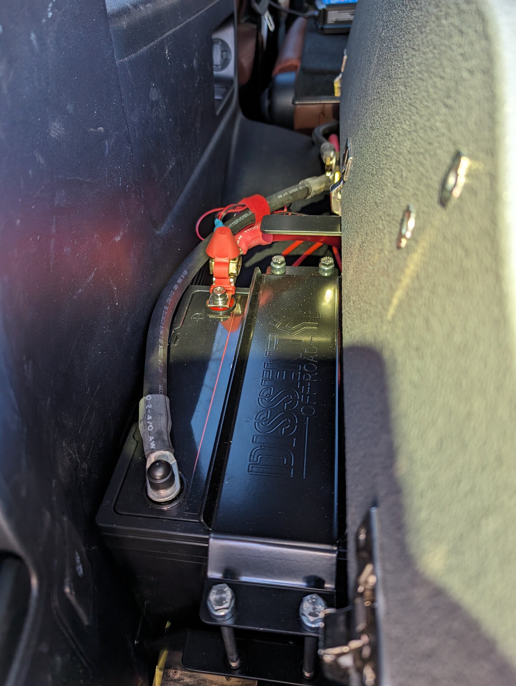

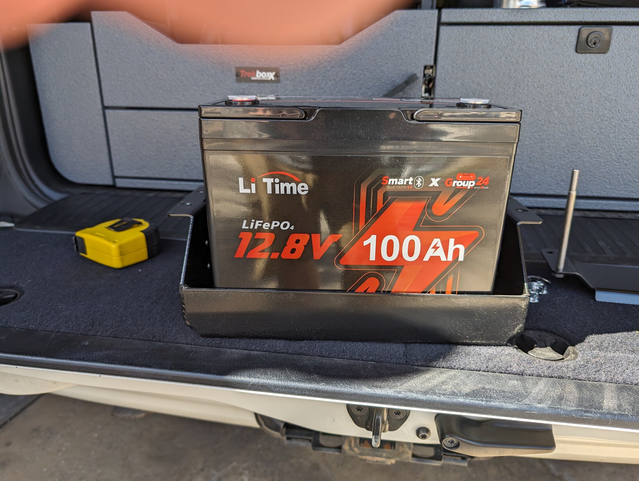

I cannot believe how long its been since I've posted an update! My life has been unbelievably busy immediately following my last post. But I haven't been idle. I've slowly been continuing my build. One of my goals for the build was to take the truck out in the wilderness for several days and have a comfortable experience while having a reliable vehicle. I had been wanting a fridge in the truck not only for the wilderness days, but also for normal days, or family road trips. I could have run a fridge from the starter battery, but I was nervous that I could run the battery flat. I'd been wanting a house battery. Specifically, a LiFePO4 battery. However, I could only really put the battery in the driver's side wing of the Trekboxx. I couldn't find a battery that was affordable and could fit the size restrictions I had with the drawer. With my TrekBoxx I received a battery tray. It had dimensions that seemed reasonable:
WIDTH 6 13/16"
LENGTH 12 3/16"
However, while keeping the TB lined up evenly in the back, the battery tray never sit completely flush on the floor. It sat slightly on top of the plastic trim. This meant my vertical height was limited to around 10 3/8". This really limited me on battery option. Back in Feb/March of 2024, Li Time introduced a 100Ah LiFePO4 Group 24 battery. This battery had low temp cut off and Bluetooth. But it being a Group 24 sized battery meant it could fit into the wing! So I jumped on it. Here is the battery sitting in the tray:
As you can see it fits wonderfully in the tray. So I went about installing the battery and tray in the wing. You can see what I mean when I say the tray didn't fit perfectly between the plastic wheel trim. I had to put a scrap piece of plywood under it to lift it a bit, and then got some machine screws and T nuts to attach the tray to the drawer.
Now with the tray mounted securely, the battery and tray clamp clear the bottom of the folding wing with room to spare!
That battery has not moved, nor have I had to tighten anything since I installed it in March of 2024. I drove around for a few days to make sure it was nice and secure. Next it was time to wire the battery into the rest of the power board. Apologies for not getting more photos of this process. It was too much fun!
I used 2/0 cable from Battery Cables USA (along with their lugs and heat shrink) to wire the battery into the power board. As you can see above, I've also added an MRBF fuse block and fuse to the positive side of the battery. This is a required safety feature in case some wires get crossed along the way. Its hard to make out, but I've also added a Victron 500A Bluetooh Shunt on the negative line. I bought this well before I bought the battery as I didn't think I'd be getting a battery with BT capabilities. I will say though, after 14 months with the Li Time app on my phone, I'm very glad I have the BT shunt. It is much more reliable than the Li Time app. One of the quirks of the app is that it will only register power usage if it's over so many hundreds of milliamps. So whatever Ah are listed in the app might not be accurate due to the slow draw of some devices like the radios. The Victron shunt is much more accurate. I did have to adjust the settings of the shunt. Specifically, the Peukert Exponent, which I set to 1.05. I found that on some website, possibly DIY Solar Forums, but I don't recall. I have the shunt's current threshold set to 100mA. I could lower that too if I wanted, but I haven't had the need yet.
The last safety piece of the puzzle was a disconnect switch for the battery. If I ever had to do any maintenance on the board, I needed a way to turn off the output from the battery. I could do this in the Li Time app, however, I'm not going to trust that app. So I put in a Blue Sea Systems 6006 m-Series Battery Switch.
This sits between the battery positive and the positive bus bar of the Lynx distributor. Perfect! In a previous post I showed the Victron 12/12-30 DC DC charger. Before the battery, the charger was set to POWER SUPPLY mode. It would power the Lynx distributor when the truck was running (when the charger detected greater than 14V on it's inputs). It was time to change the charger to CHARGING mode! I did that through the Victron app, changed it to CHARGER mode. I started the truck and after a few minutes, the Orion started putting 28A into the battery! Hooray! But I wanted a backup method of charging the battery. We'll get into that in the next post!

After I got home from that pickup, I finished the lighting install. I'm thrilled with the results. There's a ton of light and having the red light is just fun!
Now we have lights for the camping trip! But, I have more power needs...
