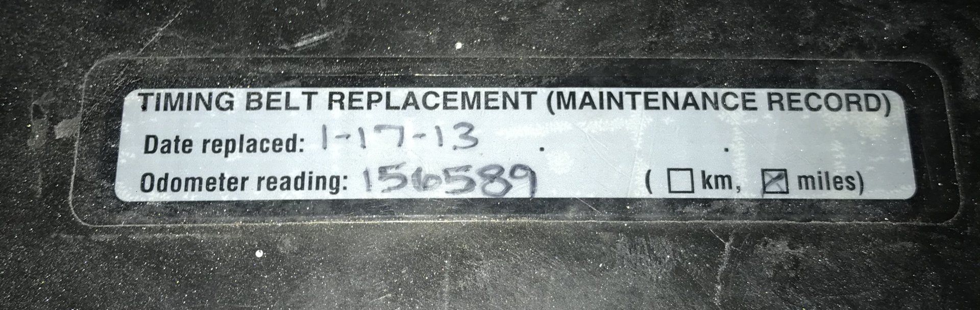

@mongoose2231 i just read your write up and finding it very helpful. I will be seeking for your guidance very soon as I will perform the nerve racking task of replacing the timing belt and water pump on my 2006 with 234k mi on it.
According to the sticker, last time it was replaced was:
Thank you in advance.

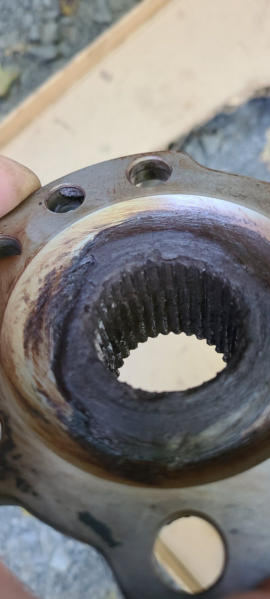

So yesterdayI employed the use of a puller and managed to get the drive flange off. Wasn't pleasant, whatever I found in there! I am inclined to believe that whenever a service was performed on the vehicle, the drive flange gasket was never put back, replaced. It's scary to think, since this truck has always been serviced at Toyota, according to the paperwork.
Check out this mess!
Now, the passenger side was in great shape. What was meant to be a quick bearing check and adjustment turned into about $700 worth of repairs in parts only! I am glad I opened it up though, could have been worse.
