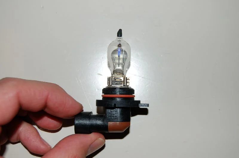

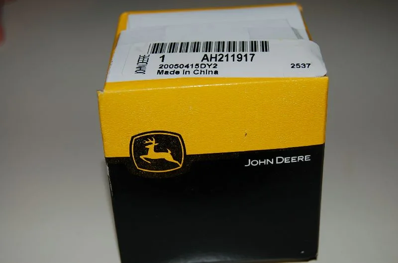

I bought the John Deere HIR bulbs, I used http://jdparts.deere.com/ to order them for $12.50 each. I actually had to call the dealer and reorder as they have never had anyone order over the web and had deleted the email they got with the order from the jdparts website.

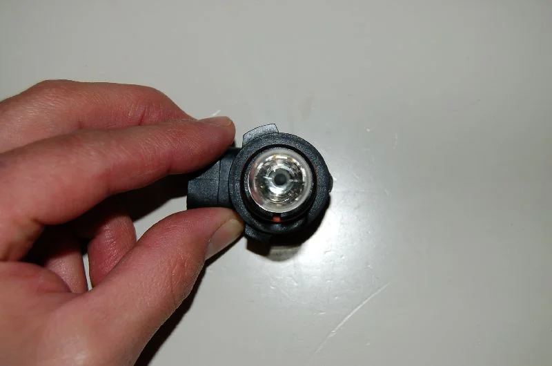

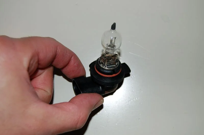

These are John Deere part number AH211917. They replace the low beam lights, and are also known as 9012 bulbs. What I got when I picked them up, was Toshiba bulbs which made in China (PRC). The printing on them says: Toshiba HIR2 12V 55W, and DOT 9012. They do require you to trim one tab, which you can do with wire cutters, or some other implement on a handy leatherman. I replaced my dead stock bulb today, and the HIR is definitely brighter, though I have yet to see them at night. I will try to get pics of that later.

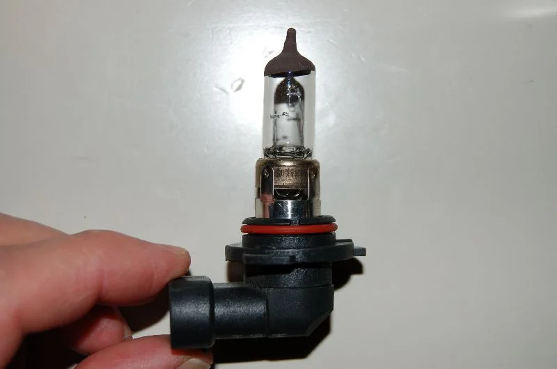

**Stock/old** bulb below:

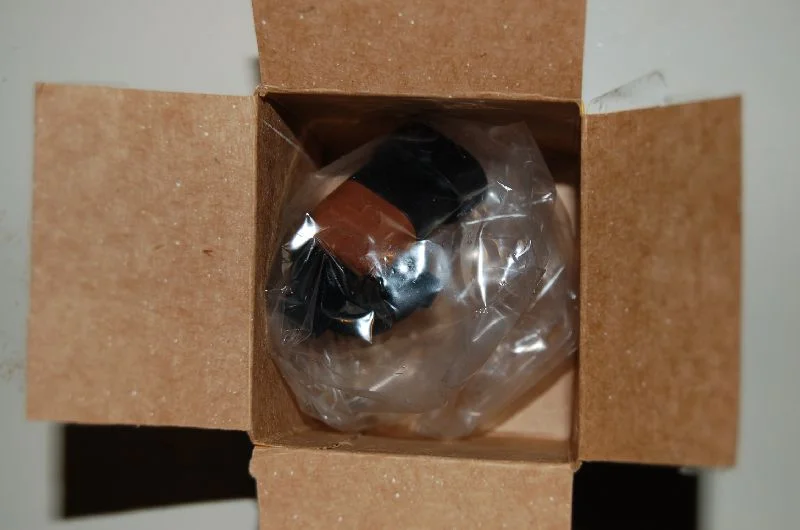

Box the new bulb came in:

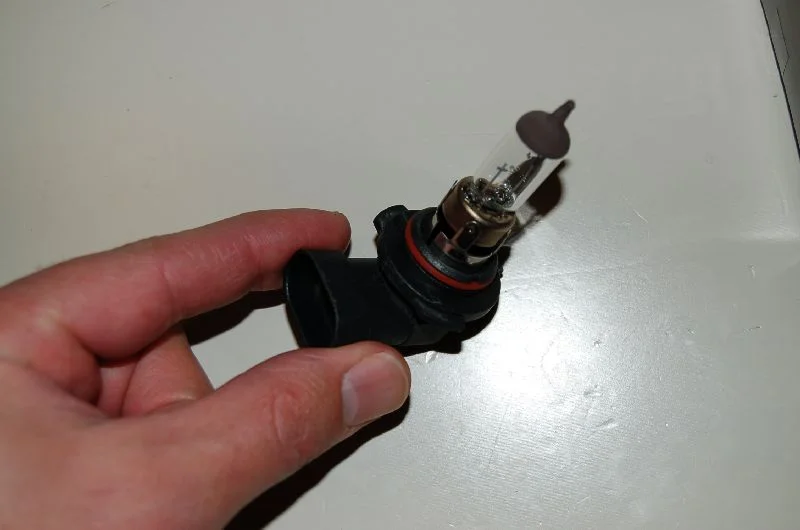

New John Deere HIR bulb (Toshiba):

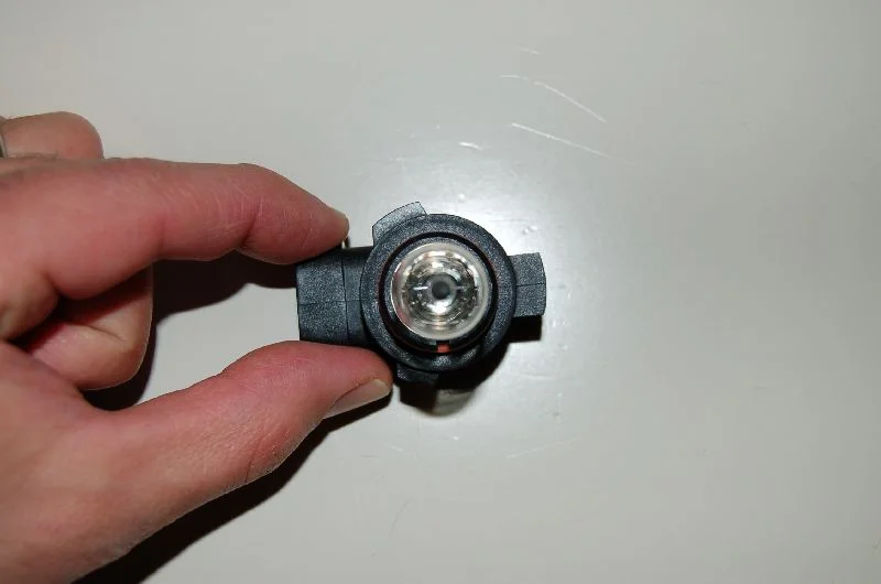

New HIR bulb with tab trimmed:

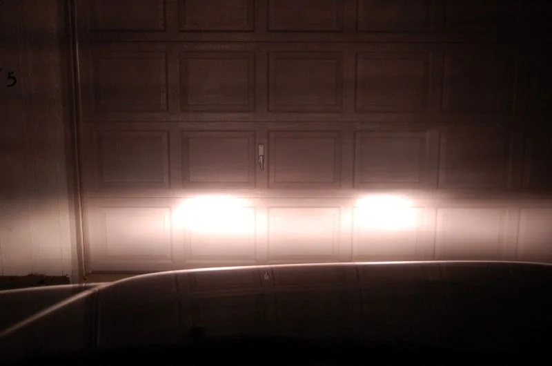

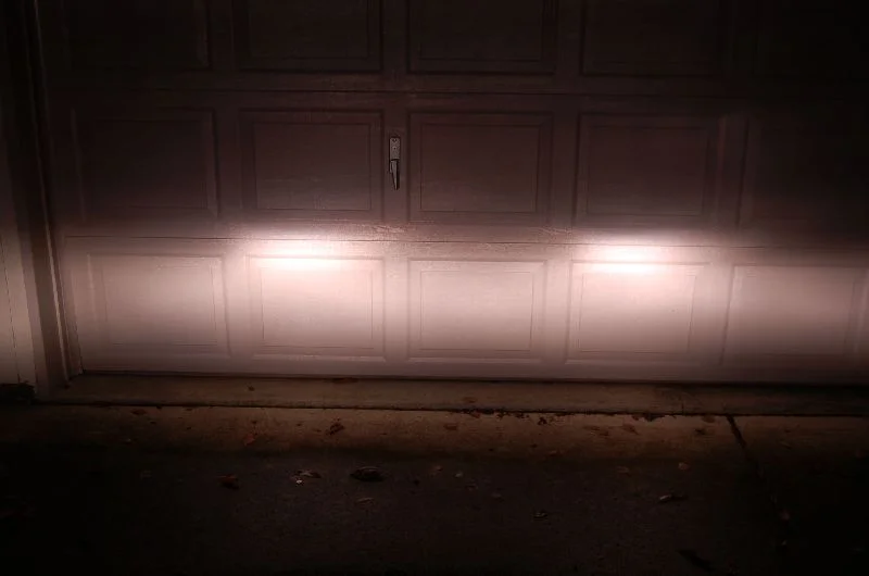

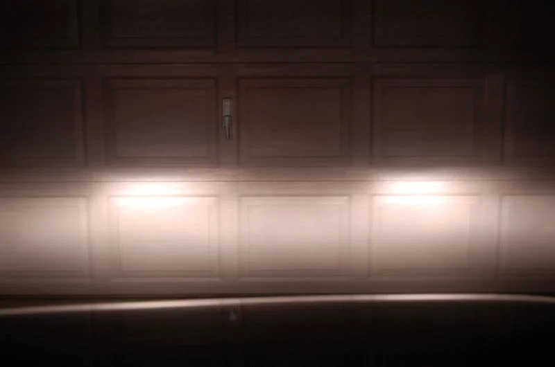

The pics are not that great, and I have not seen them on the road yet, but there is a definite but somewhat subtle difference between them. The focused beam is a little brighter, but I noticed the surrounding light is more noticeable/brighter than stock.
***US driver side HIR, passenger side stock***

You trimmed the tab completely off? Interesting.
Not sure why you would do that since it's so easy to cut it to the correct shape. I think you will have problems with the bulbs popping out of the sockets on rough roads. Just my take.
It's a very tight fit in the socket after trimming the tab. With the other two tabs "engaged", there is no way it will pop out, I doubt it will even move. I was going to try to shape it like the original bulb's tab, but the plastic is kind of brittle and just broke almost comletely off, so I just smoothed it out.

I had good luck trimming my JD HIRs' tabs to approximate the 9012 tabs with a Dremel tool cut-off wheel.

When trimming the tabs with sidecutters (dykes), nibble a bit off at a time so you don't have the entire tab break off. I've done about 12 of them this way with no problem, it just takes 1 minute to trim instead of 10 seconds.
