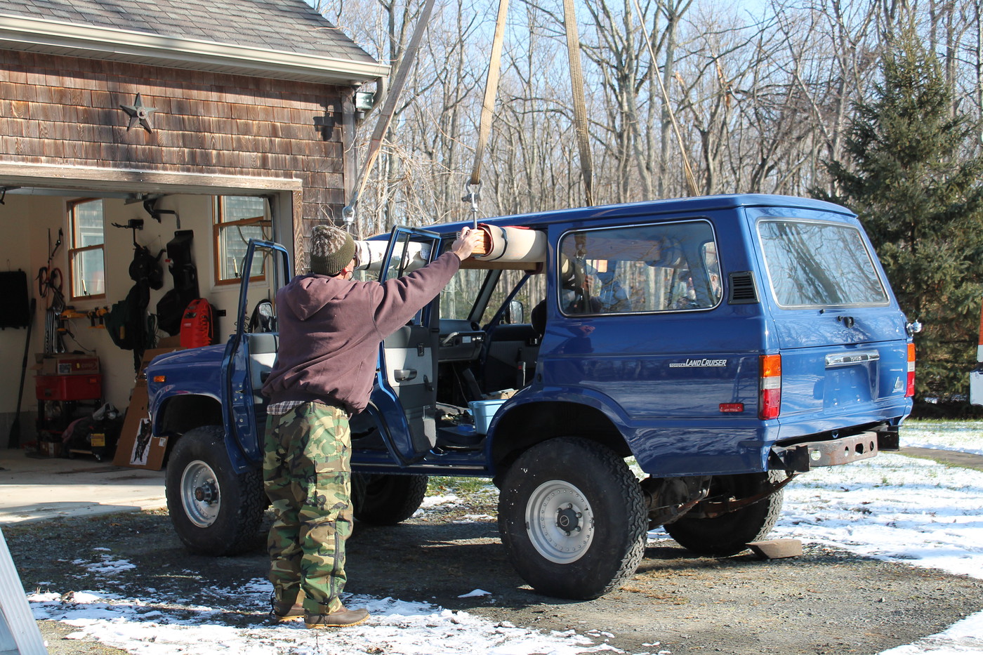

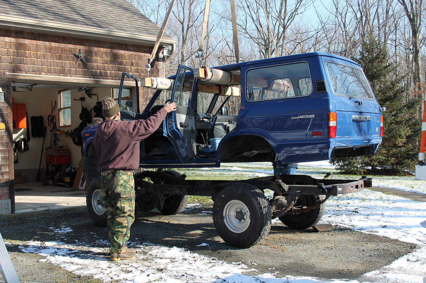

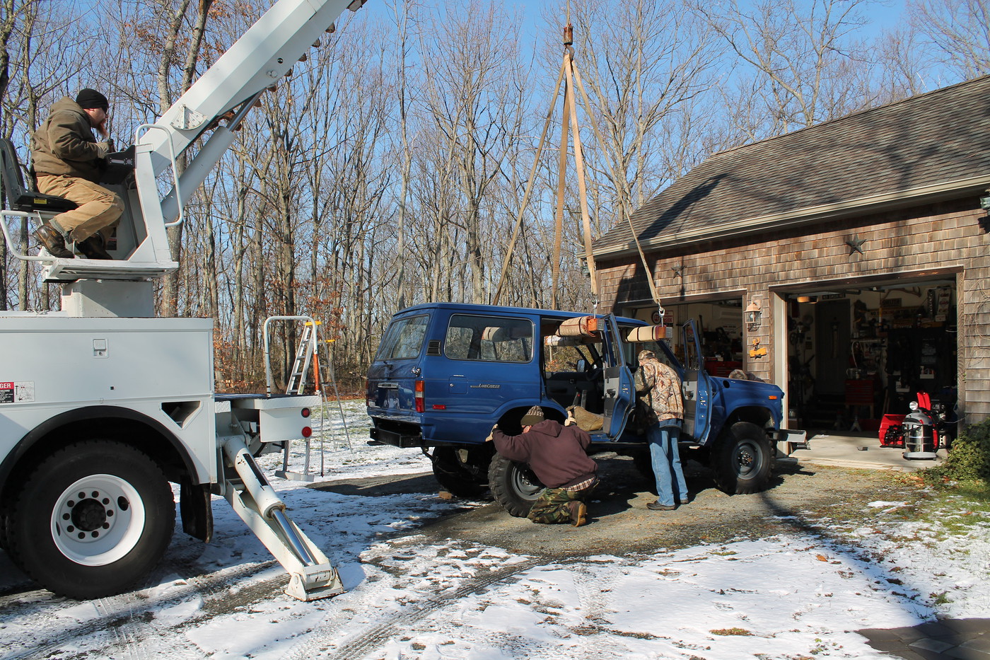

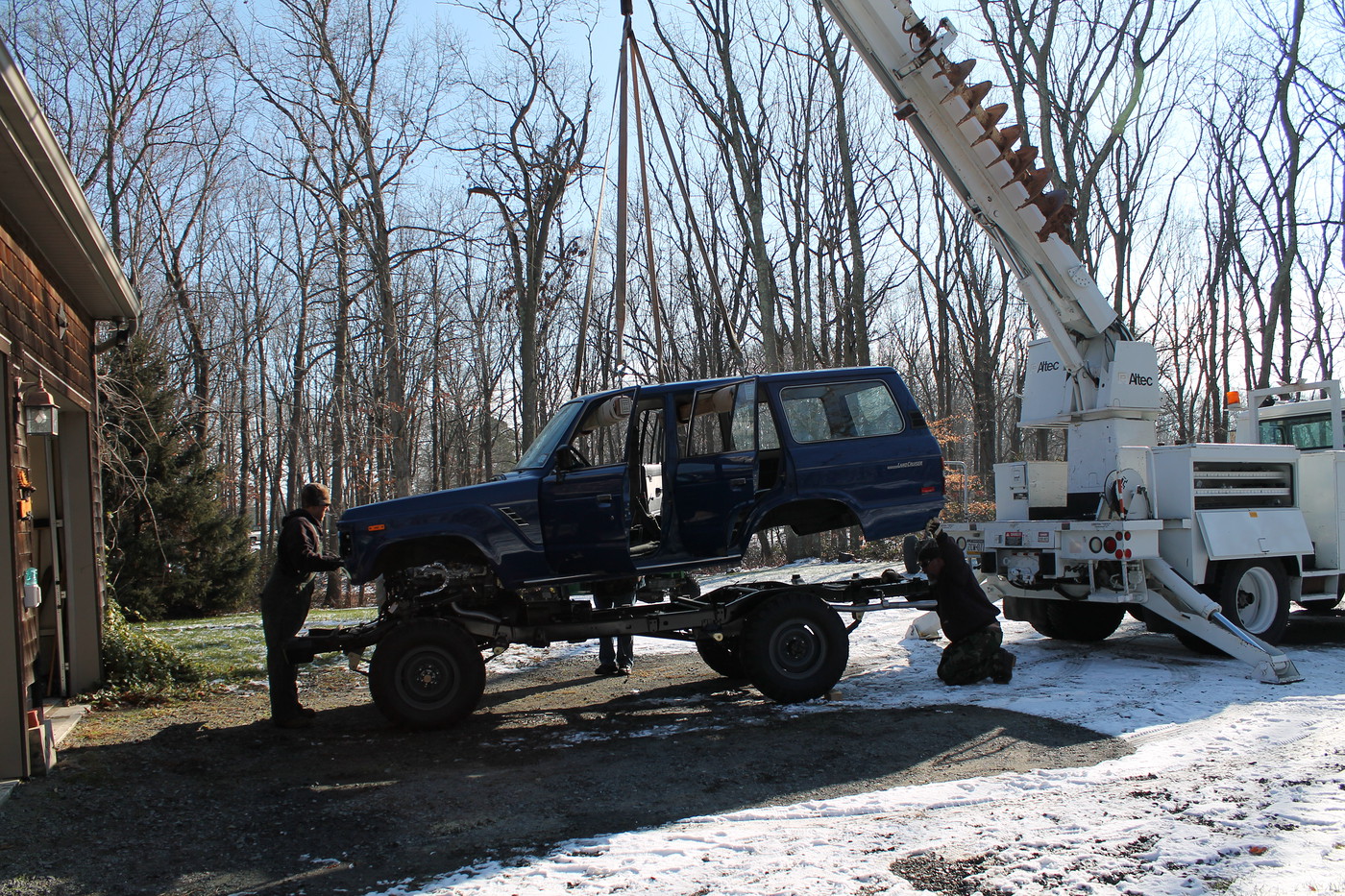

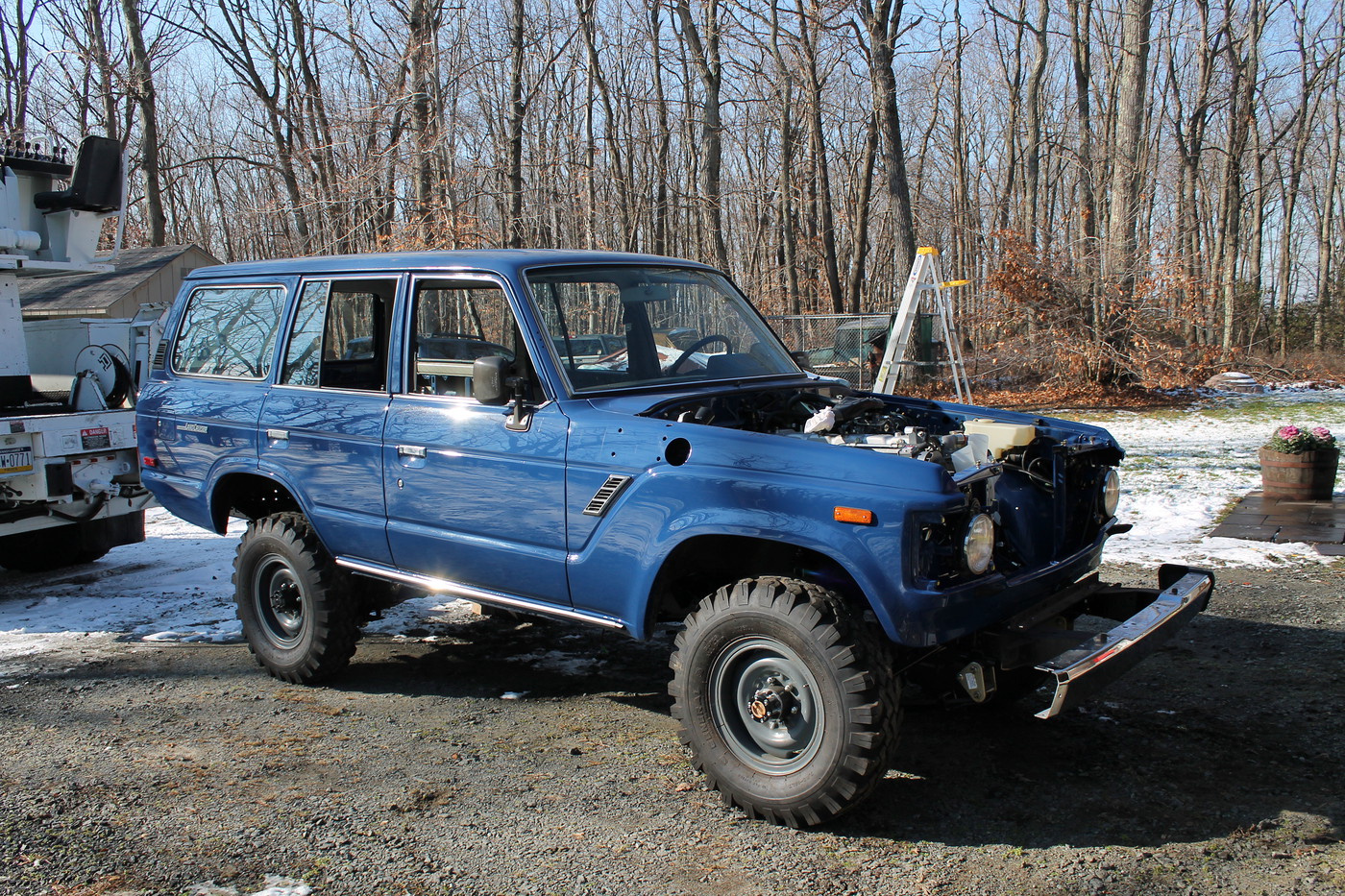

Joe's '87 60 Frameoff Using '88 62 Frame

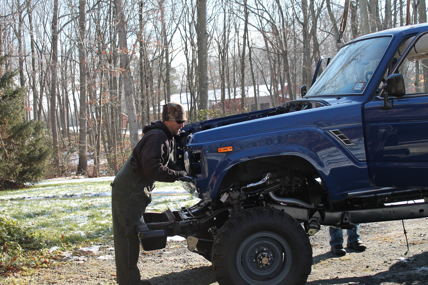

Here's a question...

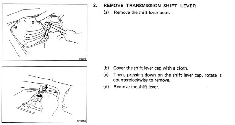

Are the early transfer case shifters bent different?
The one on the transfer came from Georg. It hits the back of the hole in floorpan. In a quick looking at my original 87 transfer case on the floor, it appears to have a little dog leg bent into it. I am going to have to change the shifters i believe.
Thoughts?

First and foremost, good work putting the new body down on the frame! That's a hell of a good feeling.
I would expect that the early and late t-case shifters are different simply based on the fact that the late shifter would have to account for the extra transmission length.

Joe IIRC, the 81-5/85 shifter were different from the post 6/85 thru 87 shifter. I think the later was a thicker shifter with a larger hole in the shift plate to compensate for the larger shifter.
Hope I have that correct.
