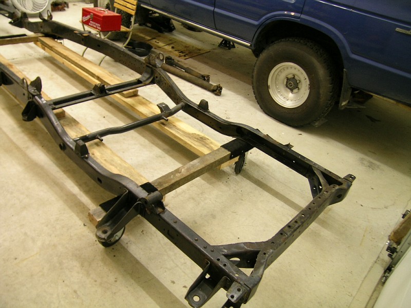

Joe's '87 60 Frameoff Using '88 62 Frame
Joe the rig looks sweet, is the body going to get stripped down as well?
Thanks my friend.
No, not SKINNER stripped down like.
My buddy has the body at his home shop now. He's gonna remove any and all rust, and paint it.
I took pretty decent care of the truck so my interior isn't shot. Gonna do some interior stuff like a tuffy. Would like a drawer system in the back as well.
Nice work on the frame and restoration. I am working on my '85 and the rear frame cross member is rotten. Just curious is to whether the rear cross member on the 62's work on the 60's. They look different.
thanks
The 60 has the curved crossmember only.
Where as the 62 is much beefier with the curved section, then an outer rear of frame rail crossmember over top and welded to the curved one and over the top of the frame ends.
Are they exactly the same, not sure. My 60 frame is at my buddy's so i can't measure it compared to the 62 frame in the garage.
It appears from the pics that the 60 crossmember comes flush with end of framerails.
On the 62 frame, it appears inset because the outer covering crossmember curves in a little.
