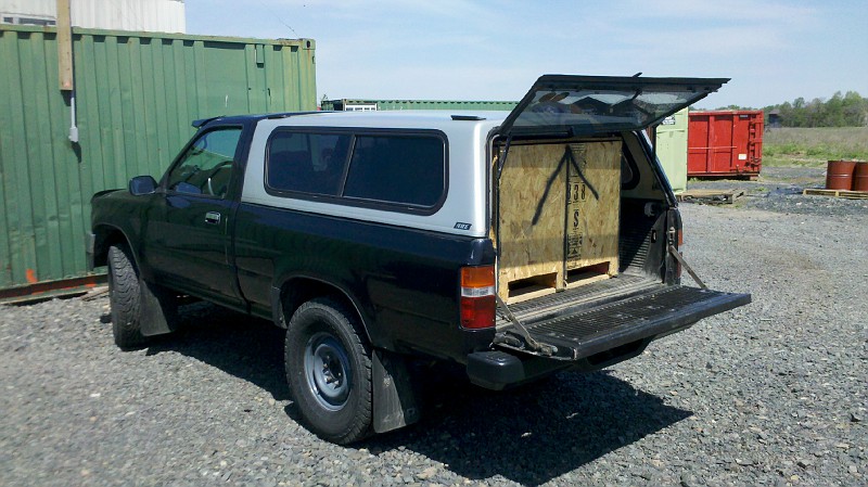

Yep. I last drove it to work when my son was born and he's gonna be 10 in march. I didn't want to drive it in the salt winters anymore so i picked up a Toyota Mini 4X4. The inspection ran out on the 60 and it sat in my mom's garage for like 5 years. Got the itch to resurect it almost 5 years ago. :hillbilly:

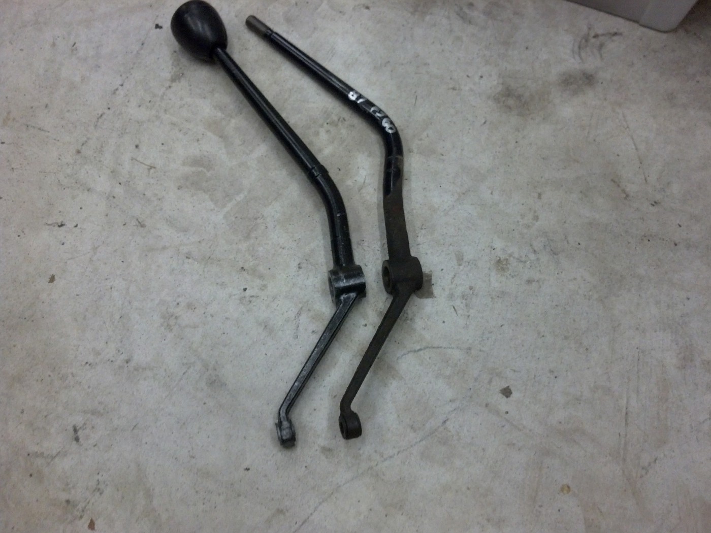

All transfer case shifters are not created equal!
One on left was on the rebuilt transfer case i put in and had problems shifting it.
One on right was the original shifter that was in my 87.
I believe that one will shift much much easier. :hillbilly:

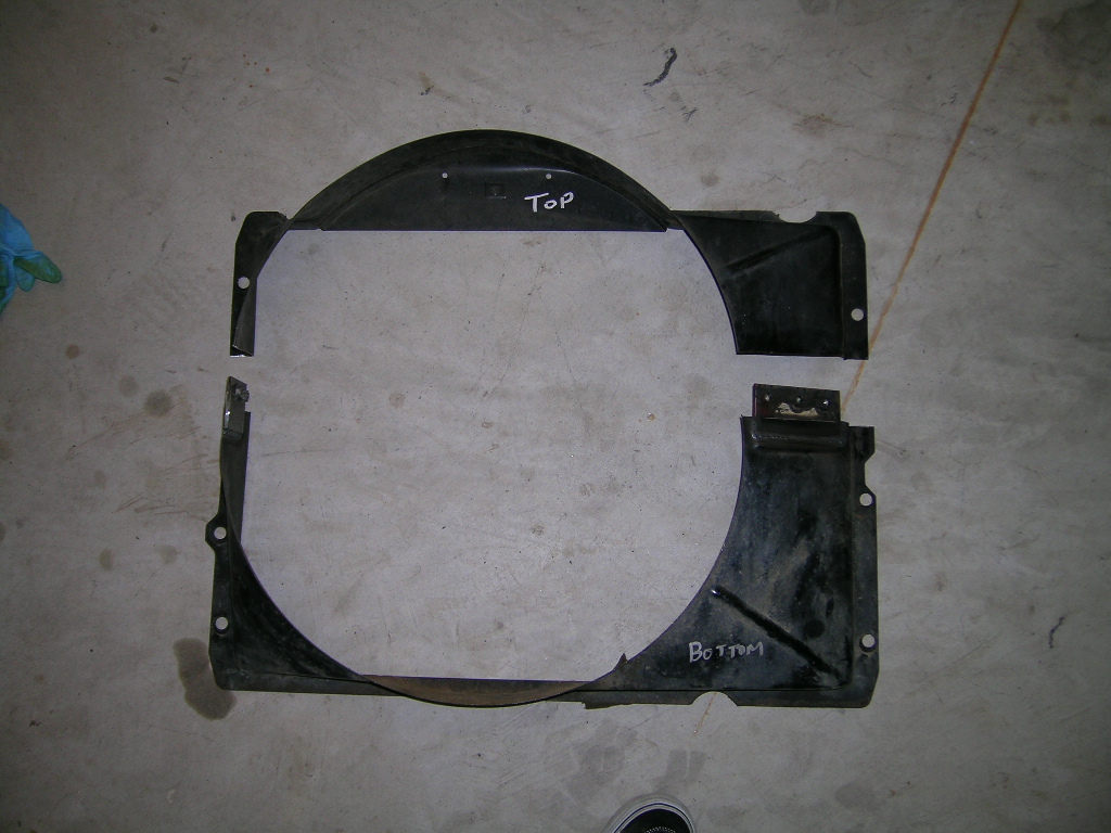

At the present time i am not far from engine fire up. I made a two piece shroud. I have been waiting for the weather to warm up so i can paint it but after looking at the s***ty forecast for next week, i went and dropped it off at powder coater. I want to get shroud all mounted so i can put top rad hose on and fill the system with the juice.
