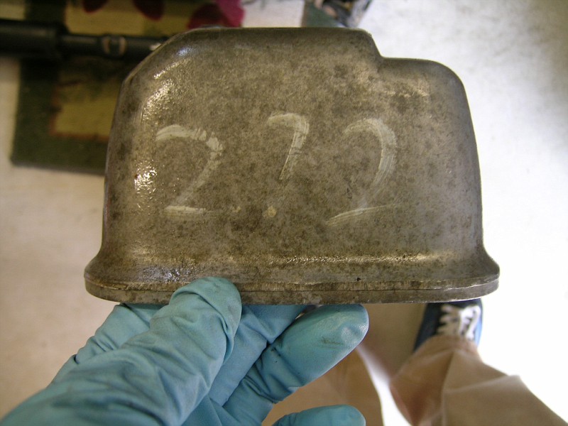

More than likely either an engine number or even a part number from a lot of parts.
Gotcha.
I'm gonna pretend it was an Arakawa rolling chassis number though.
I thought it was cool when i found it on the back of the valve cover so i re wrote it in crayon on the same one after it was powder coated.:flipoff2:

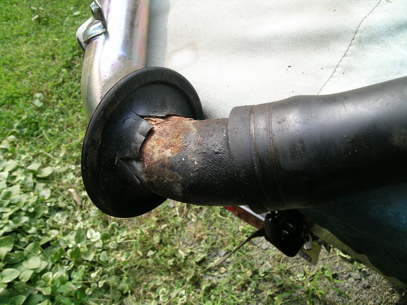

Got the parts together and the exhaust run. My buddy tigged the front downpipe that had a crack around the weld on the manifold side and cut off and sealed up the air tube hole.
Got some NLA hanger parts from Godwin that were in great shape. I wanted to run a factory set up so i could do it in the garage by myself and have everything bolt up. Another buddy did the last couple custom bent tailpipes but that would entail bringing the truck/chassis to him.
Sam at Lowe sold me the tailpipe for $204.45. Was not sure i wanted to get a tailpipe shipped for fear of damage but figured Lowe was on the east coast so i'd give it a shot. Came wrapped beautifully with no damage. Cheaper than my buddy could do it for.
