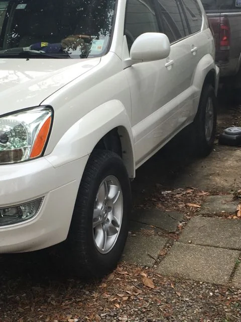

Well I haven't made any more progress on the suspension. Took off the running boards this morning. Also added some little interior mods for my pal Luna. This evening when my xenon depot hid kit comes, that will also be installed. You can finally see that the spacers have been installed now that the running boards are off. Tires got pushed out a few weeks with my holdup on the suspension. Got quoted 300 dollars on getting the coil overs swapped by the shop I use in New Orleans yesterday, think I'm going to pass on that one. Got it up on the jack stands again last night and I don't know if I trust myself trying to sawzall off that top bracket.
