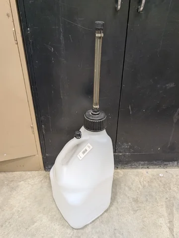

My situation is different than most. My FJ62 lives in a rural area. Sixteen miles to the closest gas station. Price always much higher than stations forty miles away in the opposite direction. One time I went to the location to fill it because of time constraints. They were low on fuel and limited to $10.00. After getting back I hadn't gas anything. For this reason I haul gas from our main home. Have a number of different spouts for original jerry cans.. The FJ62 has one of the spring loaded doors for the narrower unleaded gas and all spouts are a pain to use.. How I fill the cruiser is my setting the can on the open tailgate. I have a clear tube the just fits inside the spring loaded door. Push it in at least a foot. The other end has a check valve. Get it to start syphoning by lowering and raising it and keeping it in the fuel. When it's getting low I move the hose to a corner lift the can so it's the lowest point. Much easier than dealing with new spouts. Even easier than the old spouts as well.
