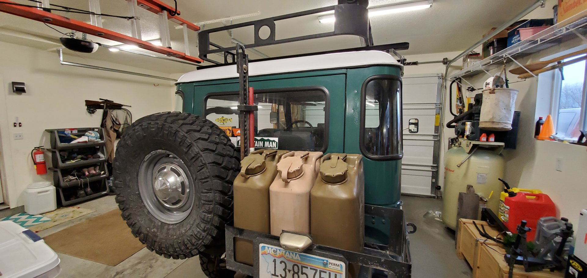

For the longest time I’ve wanted the find a way to attach a Jerry can to my 72 fj40. Mounting to the driver side rear door isn’t an option because the upper swing door needs to open. So it needs to be a separate swing out Jerry can carrier.
I’ve considered purchasing a tire carrier from later models to configure into a Jerry can holder. This was my plan until I saw a Jerry can mounted to a stock fj40 which has the three swing doors on earlier models. It looks like the Jerry can is mounted to the hinges of the stock left hand door. I’ll provide photos.
Does anyone know what sort of mounting door this is? I’m hoping it’s not fully custom or that it’s at least something I can buy.
If I was super confusing and need to explain more let me know!
I also added a photo of my rig to show the similar setup I’m working with.

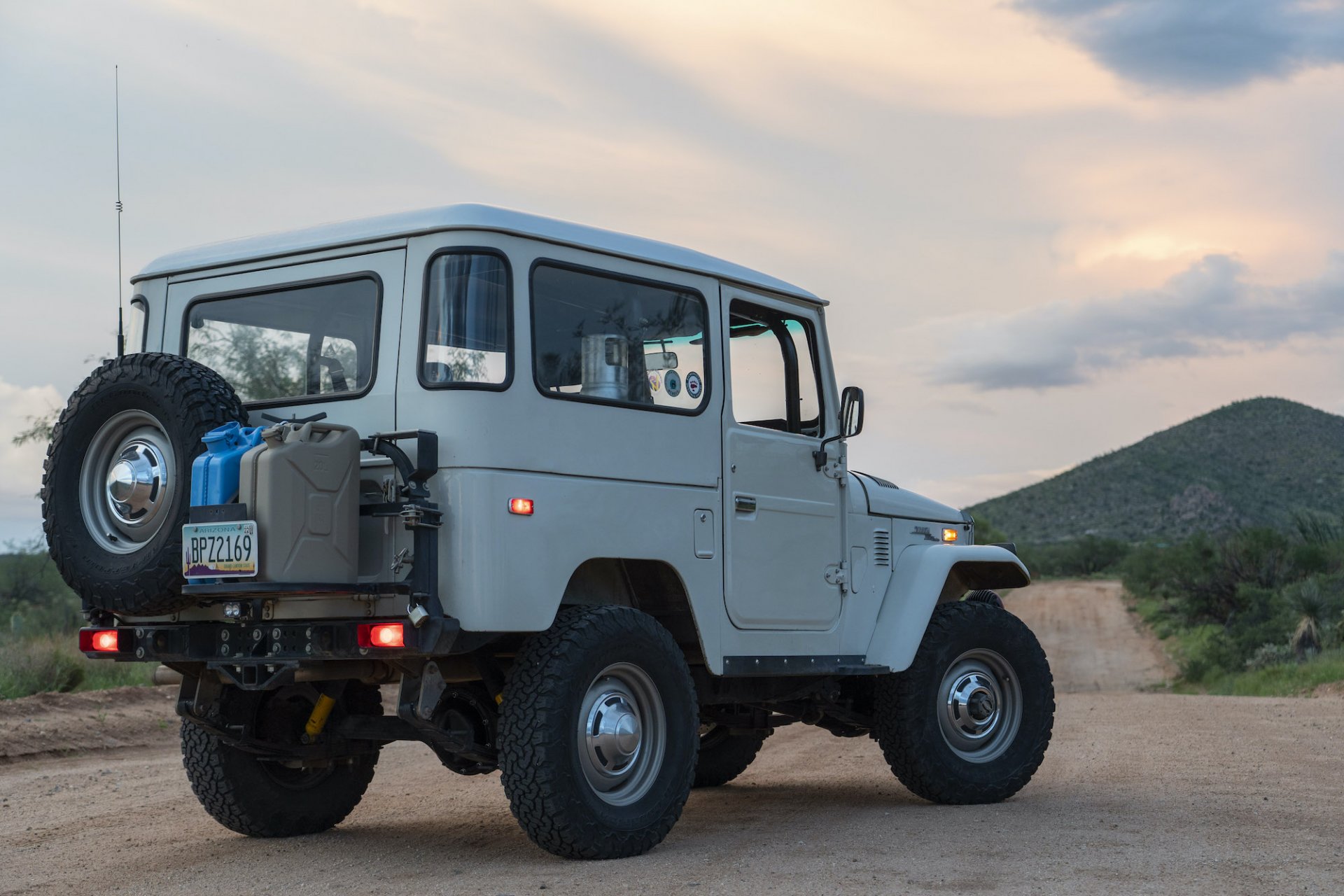

I simply added a second tire carrier to mine, which is much stronger than the door, and made it into a gas can holder +. Swings well out of the way for rear access and has worked great for years.
Hard to see but I have a `76 tire carrier on the driver side and a '68 carrier on the passenger side.

Yup, that's a 4plus rack. I'm not sure on the basket, I know it's a 4plus but I don't know what model it is for.
I found it for a smoking deal on CL.

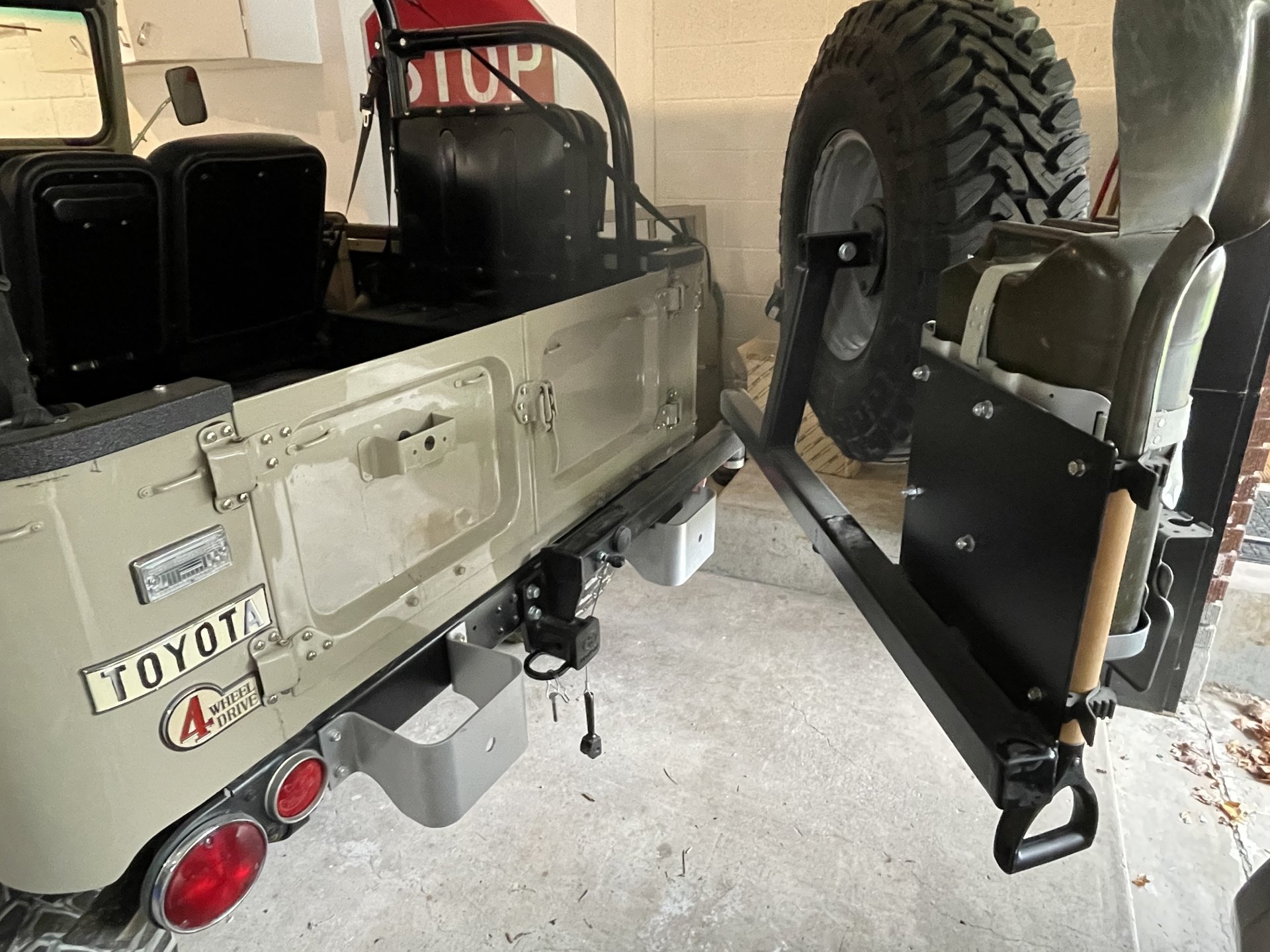

Alright, it’s been a while, but this past summer I put together a solution that I think worked out great. I decided to extend my 4plus tire carrier and add a mounting plate for a Jerry can/shovel. The addition itself (not including the can/shovel) only cost like $120 if you go the cheap route and coat it with rustoleum rather than powder coat it.
Also put a few inches of square tubing shimmed inside right under the weld. It fit super tight, so that weld will likely never fail. Also found a way to mount the right bumperette, so the back end it definitely rounding out. All we need now is the license plate lights and we’re good to go.
