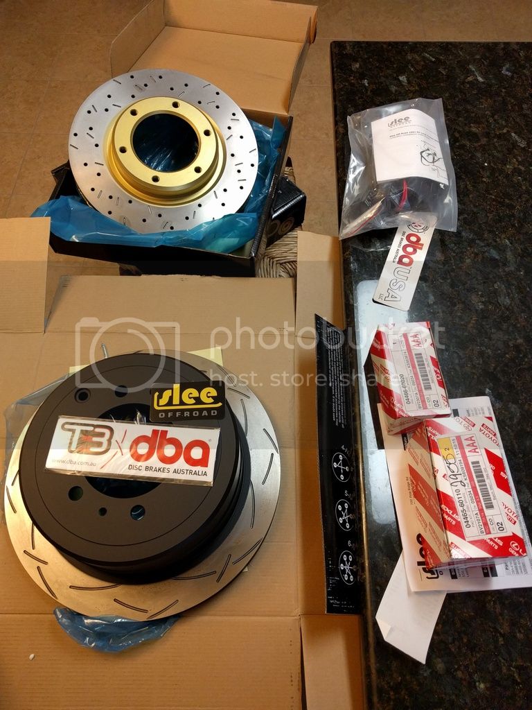

Back brakes - Done
Slee Headlight Harness - Done
HIR2 9012s (low beams) - Done; Note 1: here I thought the 9012s would work for the high beams too, but the hole is a different size. At least I got the low beams right, couldn't really care less about the highs so much. Note 2: I can see at night, yay.
Rigid D2 driving lights - Done

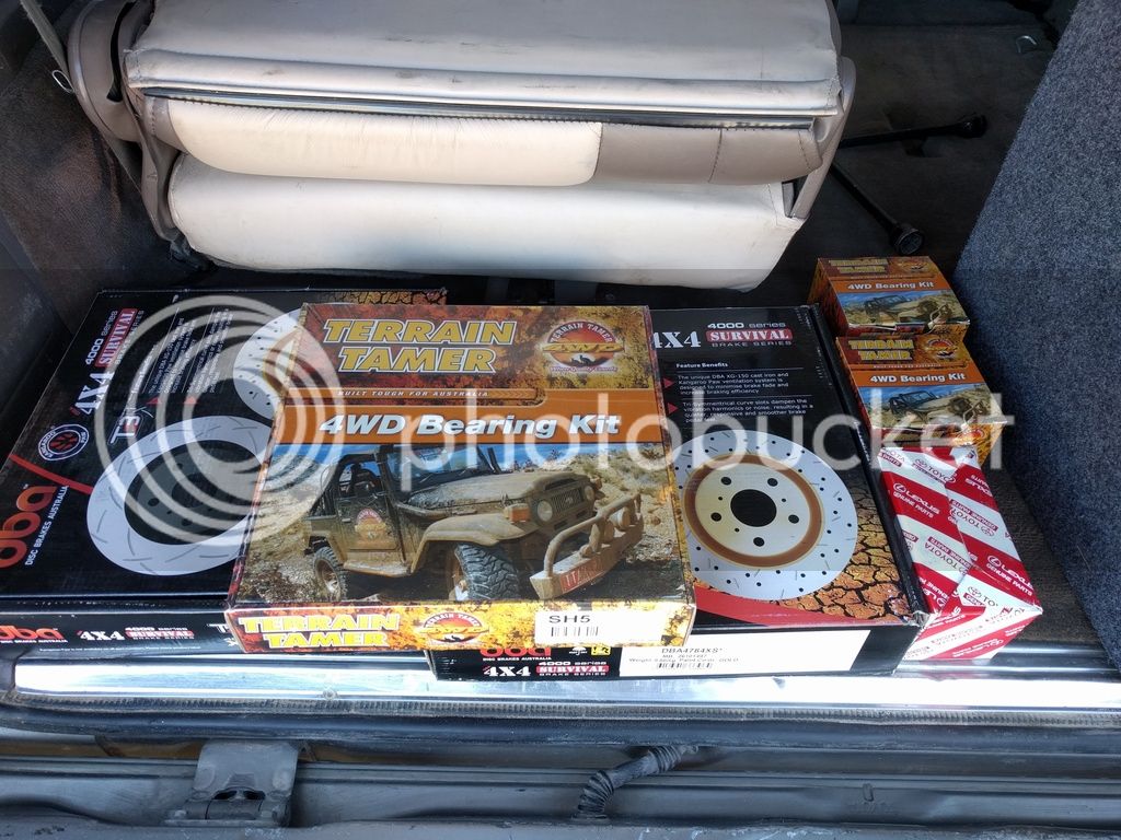

Front brakes... decided this was too annoying to jump into this weekend as I'm traveling M-F, so I'll do them in two weeks after I source the 54mm socket from Amazon.

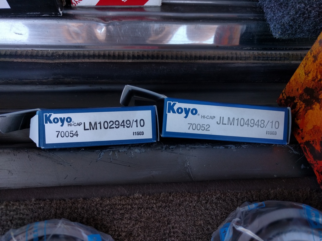

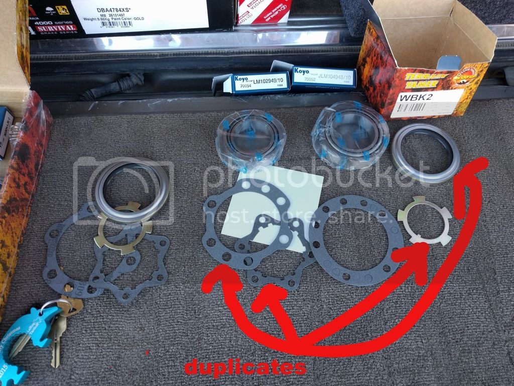

Picked up a knuckle rebuilt kit and wheel bearing kit from Cruiser Yard; everything going on this weekend.
Picture to show duplicate parts you get going with both kits vs a couple stand alone parts. I.e., you could buy the pictured bearings standalone and have everything. The dup seals and gaskets are cheap, but so are some of you (and I have no idea if it would even be less expensive) -- it's not bad to have extras.
