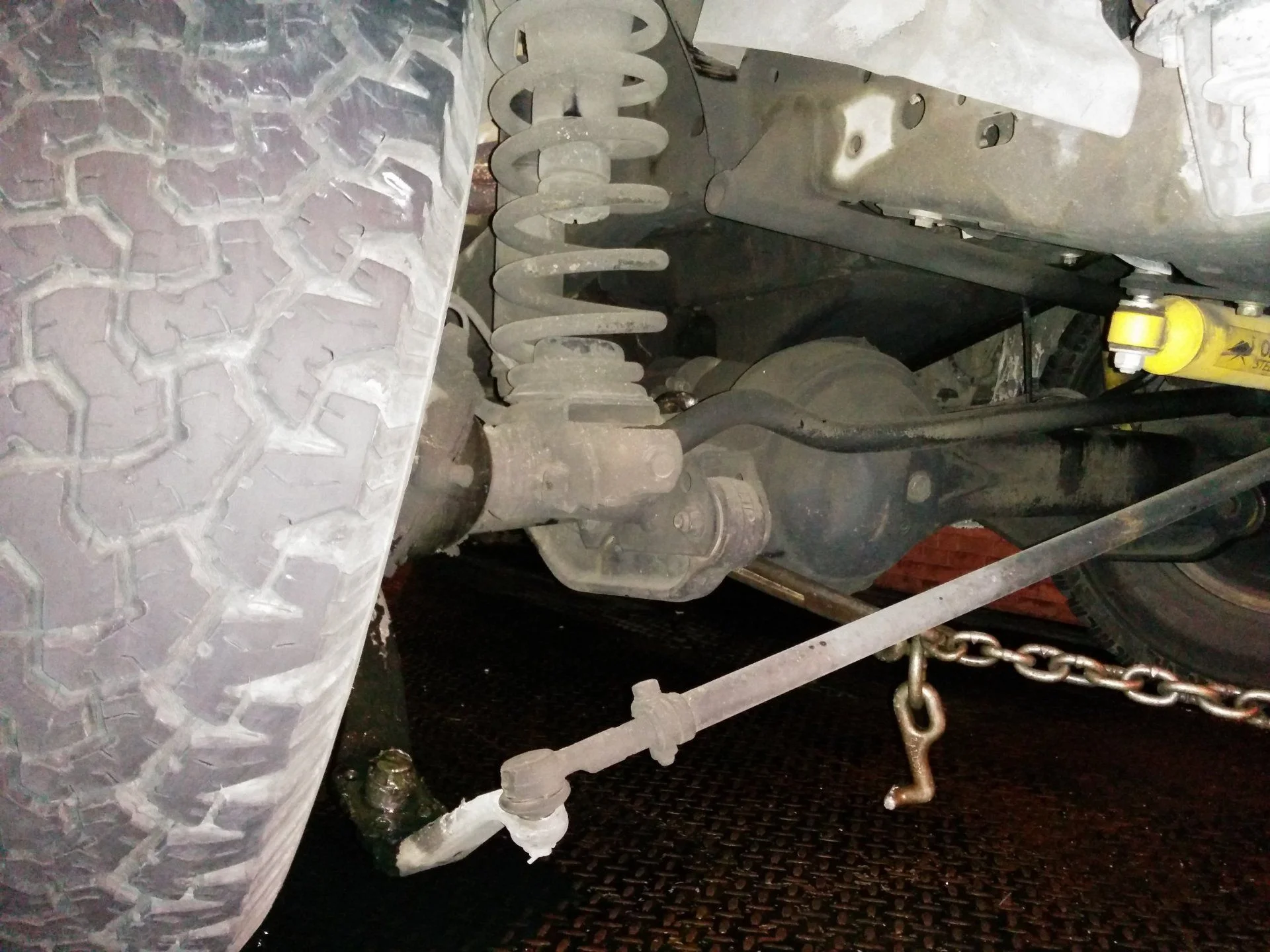

1st UPDATE W/ PICTURES :eek: Didn't even make it home. Dodge Ram tried to beat a light, I hit center of the side of the truck bed at about 45mph.

Looked like the ARB and drag link wer toast how's the front clip and frame??
Q panel bent pretty good and hood a little bit from bumper pushing in the headlight light fixture. Birfield joint is puking fluid (nothing else was though). The linkages for steering are done.
Control arm mounts on frame and frame itself looked ok, but could be a bit tweaked up front where the bumper is attached. It was dark and once it was on the flatbed they got it out of there pretty quickly so I didn't have too much time to see what all was broken.

It's at the shop now at least. Taking a look in the day -- both control arms are bent. Frame looked ok.
As for repairs, it definitely needs:
New axle (to make things easy)
New Control arms
New Steering linkages
New Q panel/valence
New Hood
New headlight housing
New ARB
New Front Rotors (shattered) - Rear will probably go on too.
New Front Caliper (bent)
That's all I know for now.

One thing that puzzles me is that when you T boned a pickup truck, how did the axle/control arms get damaged? In order for the front control arms to bend, you had to have contacted something with the front axle housing, no?
If you look at the picture of the truck, I went about a foot+ into the bed with the ARB. The passenger wheel/tire got caught on the axle of the truck, which pulled -- and eventually ripped it apart -- in the direction the truck was traveling (from driver -> passenger).

Ok, gotcha. Makes sense now. OUCH!!!
You should be able to pickup the control arms and the axle housing from this forum I bet. I have to wonder if your axle housing is damaged or bent in anyway now that you explained the accident in more detail. Sounds like the whole thing moved toward driver side which *shouldn't* bend anything. Usually the way folks bend their front axle housing is when they pretend to be Bo and Luke from "Dukes of Hazard"!! Even then, it's usually only at the extreme ends of the housing where the swivel ball resides. A simple and short truss (less than 6") seems to be the cure for this ailment, if you can call it that.
