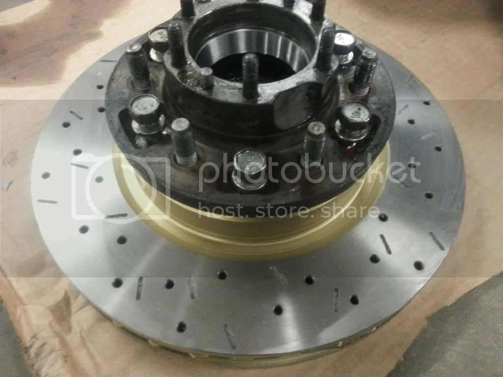

Brake & rebuild job coming along:

Update:
1) Passenger side brake caliper is bad (piston seized). Drivers side is 'ok' - ish. Starting calls tomorrow, I guess.
2) Drag link and/or ends are bad. Need to update my order with slee for the ends to include the drag link.
3) Stainless brake lines from Slee are on backorder.
Result:
Looks like it will be another few weeks to get this thing working properly, I had to use an old brake pad to get it out of the garage where it's been living for the past 3 weeks to make room for my Jeep.
I got my TRE's and drag from Kurt at Cruiser Outfitters, I know a lot of guys who went rock auto/pep boys/AA/Napa for them as well. When I did my calipers I stacked coupons on AA buying them one at a time and kept the OE's to rebuild down the road since the OE rebuild kits are cheap from Beno or Dan.
I just picked up from Slee since I needed new lines as well and already had an order going.
As for the calipers, Autozone had refurbished ones for $49 after core charge, picked up driver and passenger -- should be here tomorrow, but no sense in doing it until the lines arrive next week, so it will continue to sit until then.

Yes, I believe they are remanufactured OEM ones. I can verify tomorrow. Time/cost wasn't worth it to do the rebuild kits -- and since the piston was seized I figured "new" ones would be the safe way to go regardless.
Picture, drivers side all back together (before spending 2 hours unsuccessfully on the passenger side).
Finally arrived.
Slee drag link and ends going on tonight, then I will have Annie back in my driveway to replace the brake lines and calipers this weekend -- really need all those core charges back (almost $400).
Just have to decide what color to spray paint them -- supposed to be 70's here thurs/friday so perfect weather to do it.
