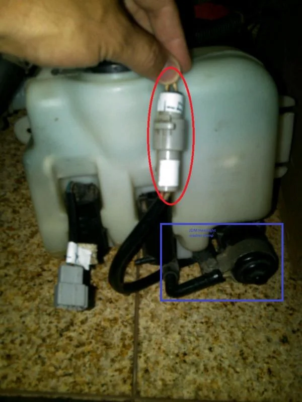

I just happened to have a JDM washer bottle collecting dust in the garage for several years (thanks Giraffe). It's pretty much the same as US bottle but with one more hole for the washer pump. The install for US bottles will be the same minus running the ducting and mounting the head light washer nozzles & associated wiring.

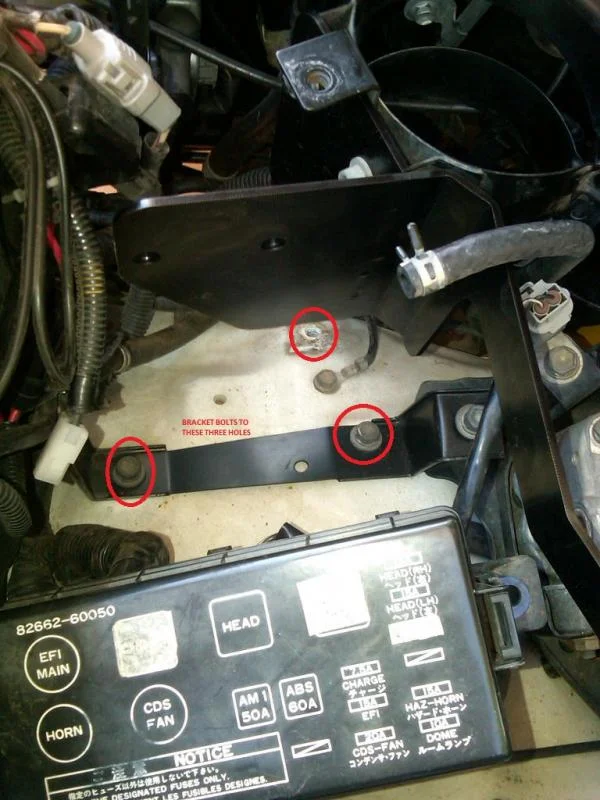

There are several steps here. I'd start with removing the battery and tray followed by the charcoal canister & fuse box bracket. That way you have plenty of room to work. Also remove the corner light so you can slide the back washer bottle in.

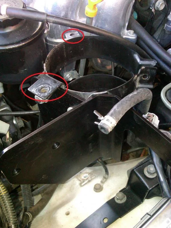

Finished install of Landtanks Charcoal Canister Bracket (pic borrowed from his thread)

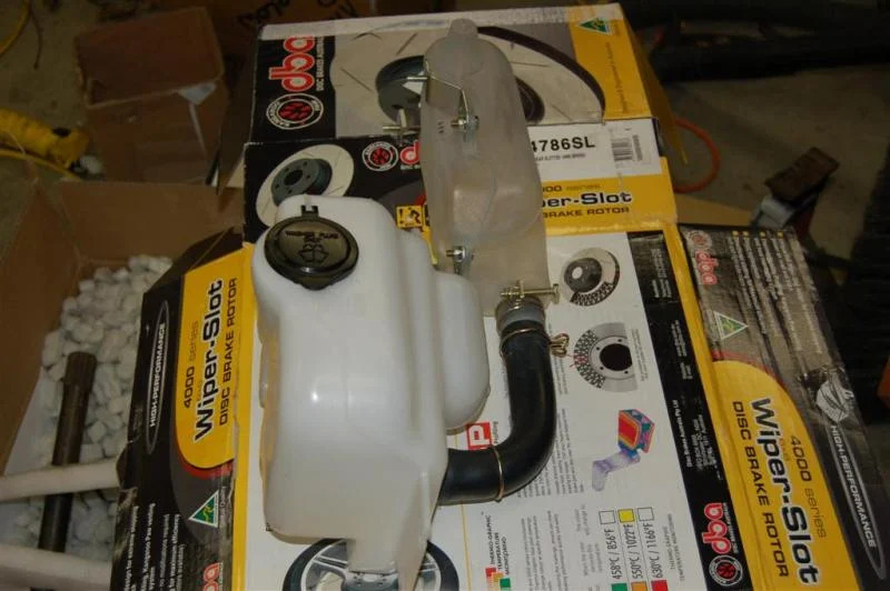

the JDM bottle
the JDM bottle
