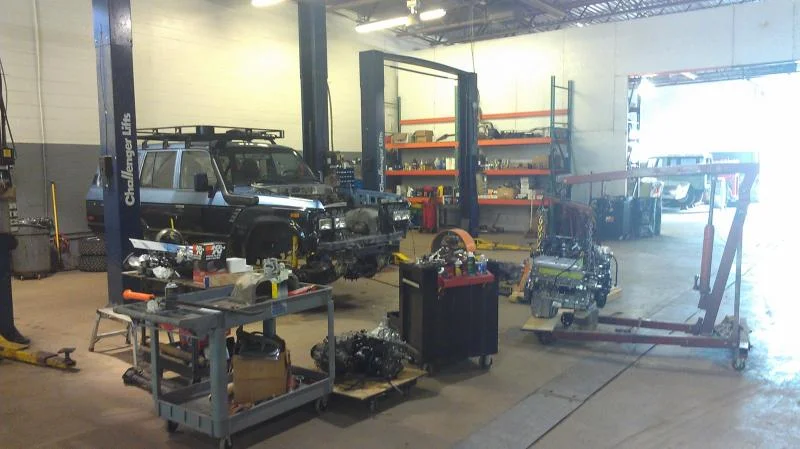

IPOR started a week ago with the prep work. Next week the drivetrain starts to go in the truck.
To make the truck more powerful and ever so slightly more fuel efficient, the engine will be a turn key 5.3L Vortec. Behind the Vortec will be an H55F and a newly-rebuilt manual transfer case from an 85 FJ60.
I had planned on going the diesel route, but as the main international driving I plan to do now is in Mexico a Chevy engine will be very easy to get parts for. And it should end up being a little more cost effective in the long run. Well, here are a few pics to get started...

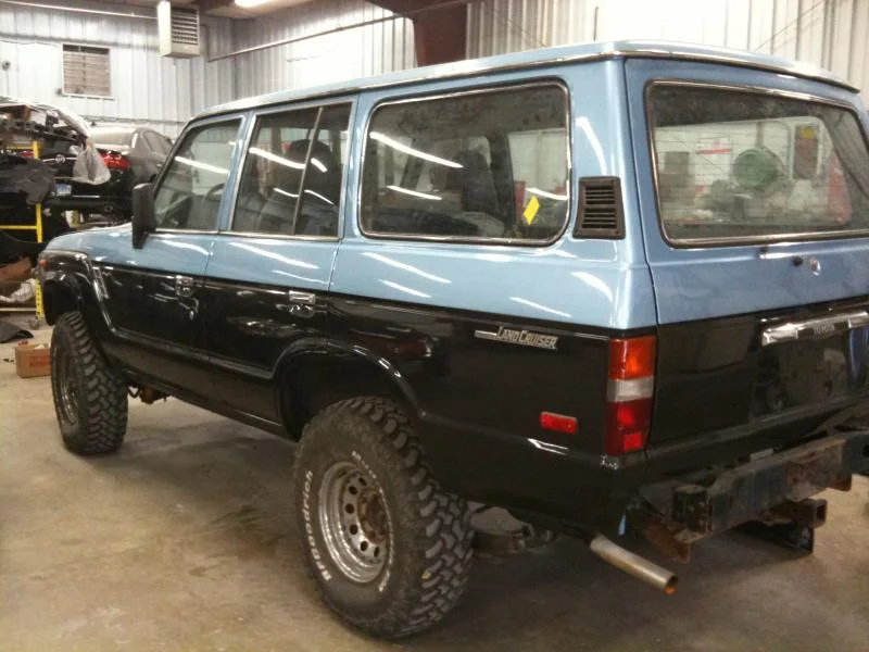

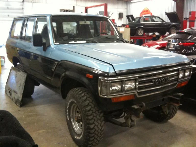

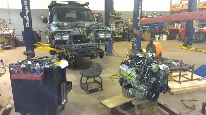

1: Just dropped it off at IPOR
2&3: In the shop with Vortec

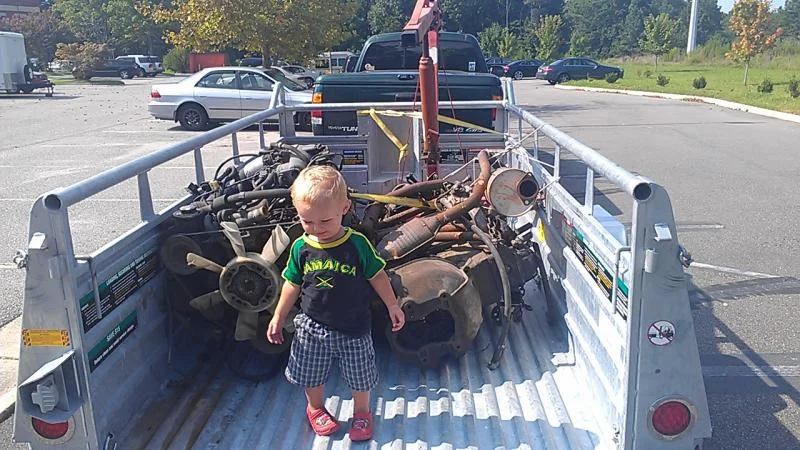

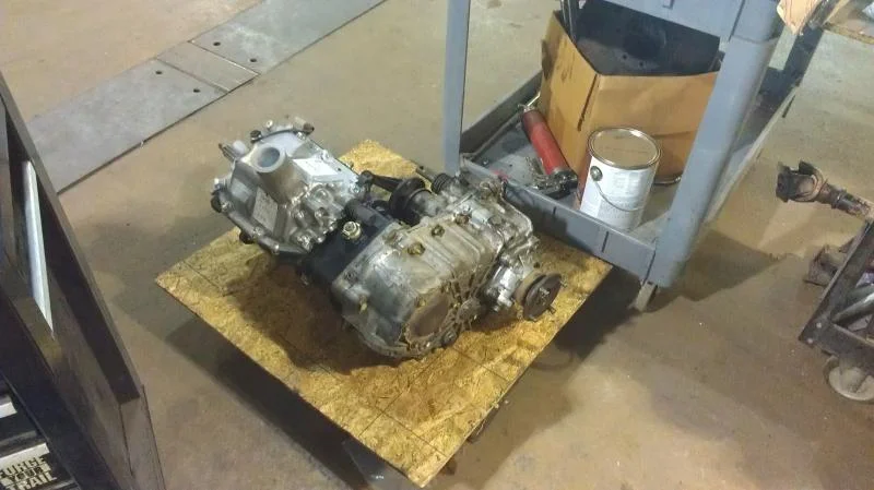

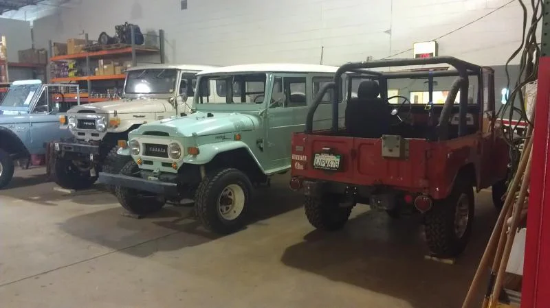

1: H55F and 60 transfer case
2: Some friends in the shop ;p
3: 2F and 3F with A440 and transfer case coming home. Anybody need some parts??!!

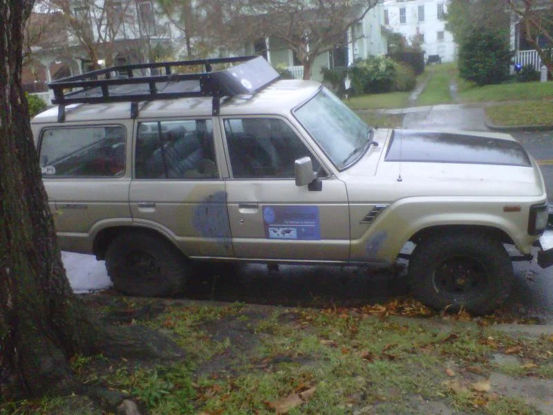

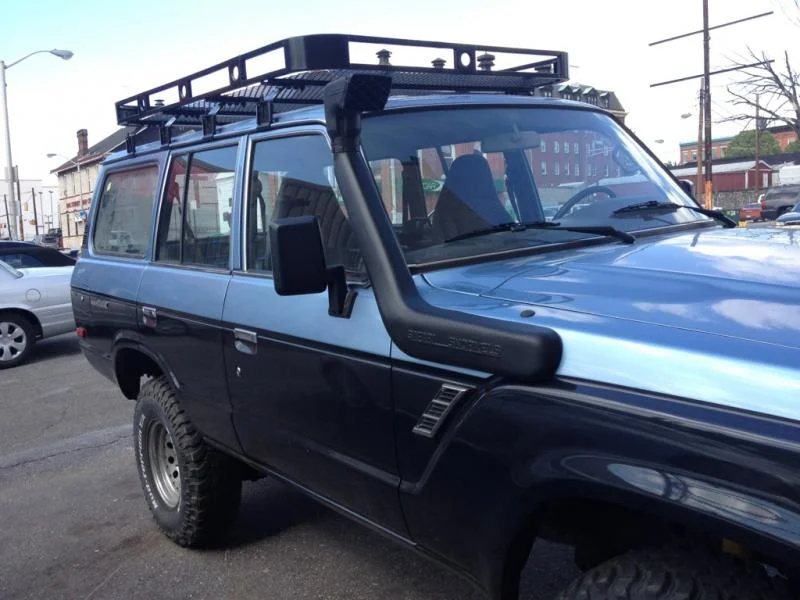

Sweet ride. Any better pics of that new paint job? Looks like two-tone blue?
Will try to find a few earlier pics and post. It had a factory two tone with that silvery-blue on top (had an 89 4runner the same color) and a darker blue on the bottom.
My buddy picked two colors that are a little more blue than grey for the repaint. I really really like it! I'm more of a white or desert tan cruiser guy...but it looks great. In fact, I bought sliders just to be sure I don't wreck the rockers :).

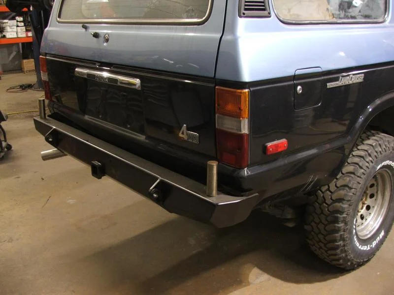

Parts awaiting install
-ARB front bumper
-4plus rear bumper with jerry holder
-Safari snorkel, installed but not connected
-may steal the winch from the other 62?
-MAF rock sliders

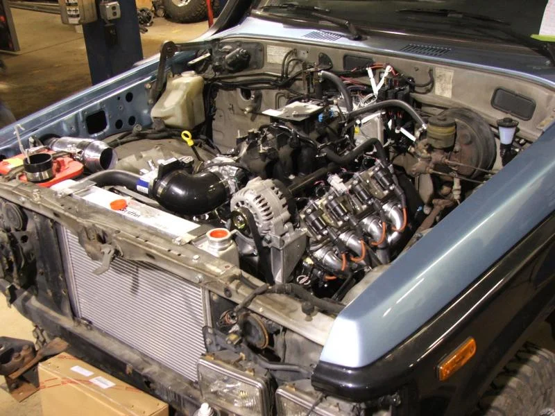

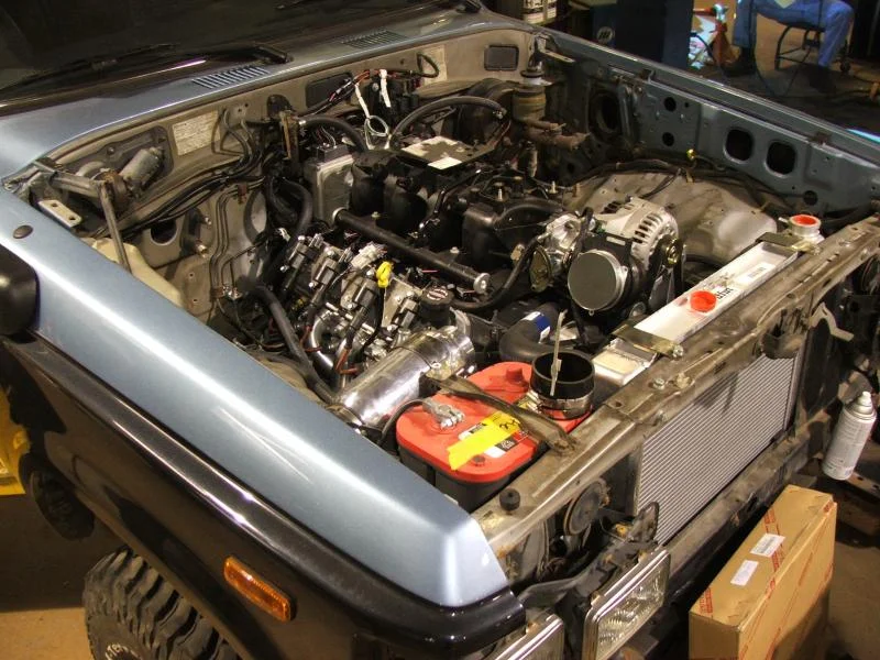

Got a few teaser pictures from Iron Pig today. Haven't seen the cruiser in a few months, so it was much appreciated.
New Vortec in place and nearly completed:
