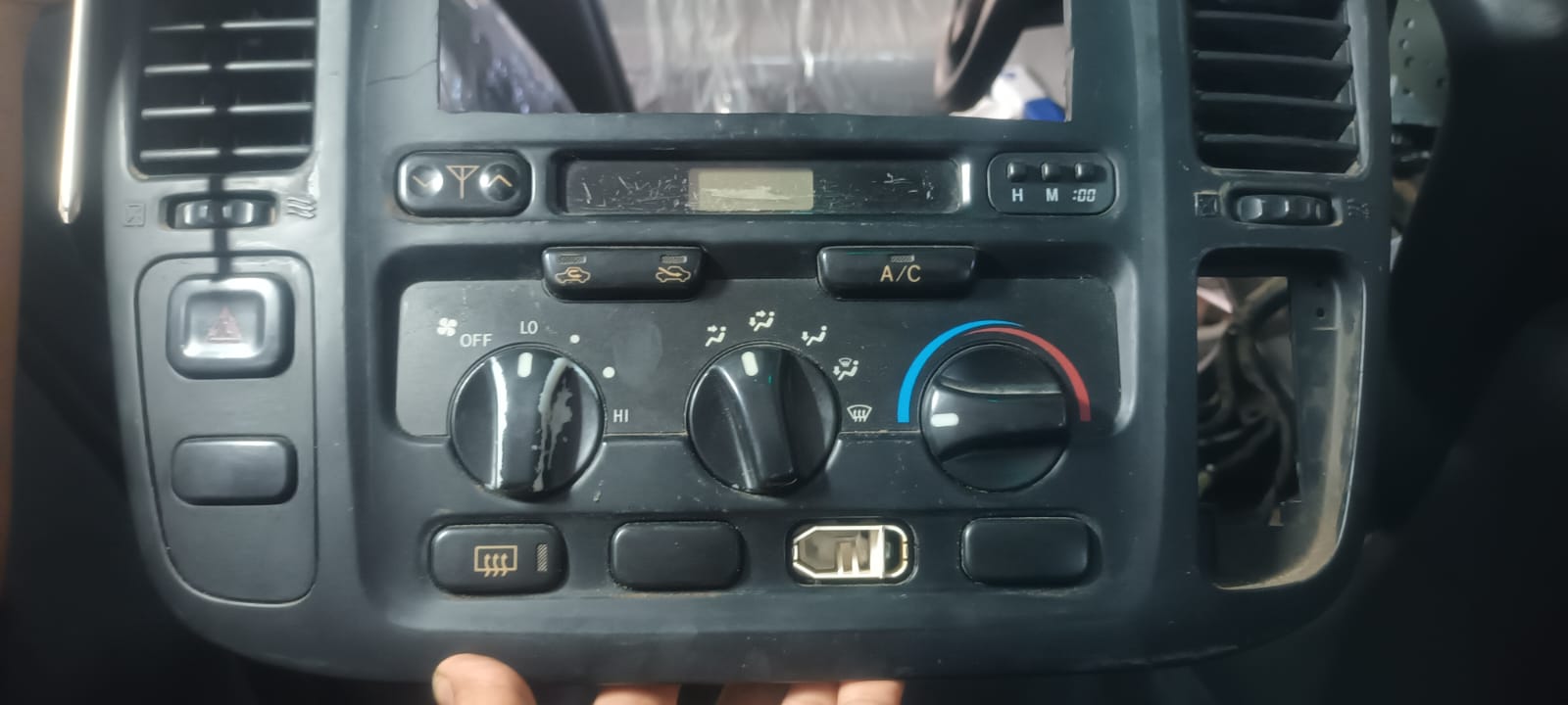

Well most controls on the front Control Panel we're not working, the A/C worked on one mode only HI fan and that's it. "AC" button was not pressing in, resistor switches were rotating towards eternity and the air was neither cold or hot.
So the control panel was taken apart, and to our surprise someone decided to have paper tissues jammed behind the buttons in hopes of making it work. obviously that didn't work well:
so that was put aside until we sourced some new resistor switches and A/C buttons.

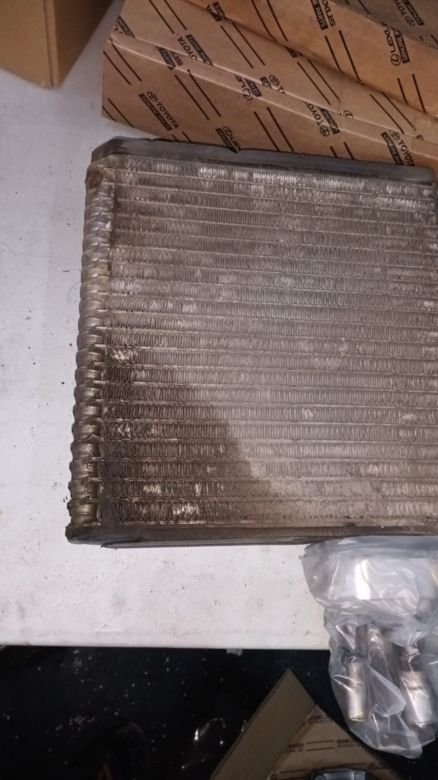

the rear A/C unit was working just fine, blower was doing it's job and evap seemed to be ok from the visual inspections, however no air was coming through the vents.
the control panel switch was toast and the expansion valve was not expansion valving, so a new valve was installed:
After having a complete closed A/C system, the guys started pressure testing the system and with no surprise the front Evap was leaking, new Evap is on it's way:

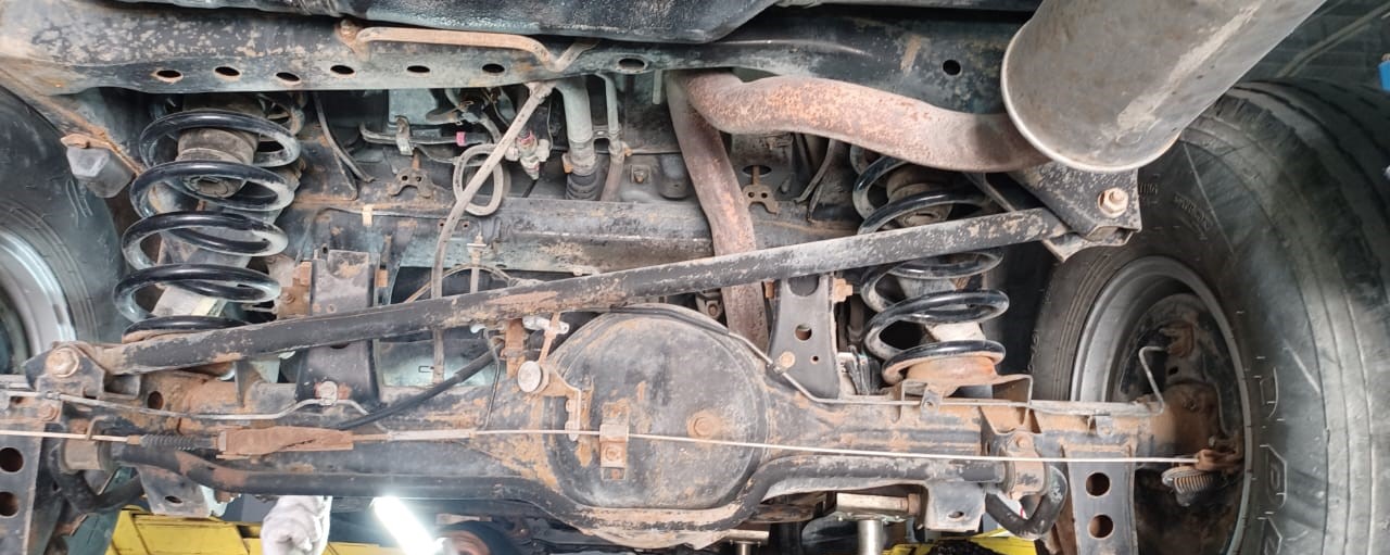

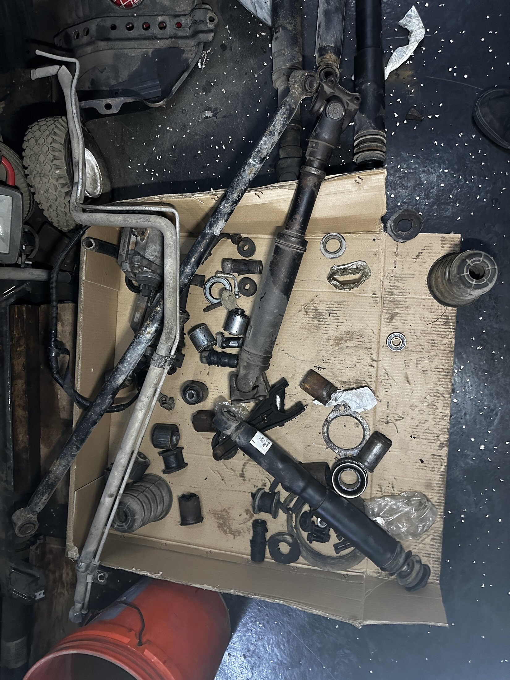

All suspension bushing on the LC have been replaced or are being replaced
Some of the old bushings that have already been replaced and the old track bar:
new track bar installed:
old blown shock absorbers:
new OEM shock absorbers installed:
new stock front drive shaft boots installed:

  • Rear suspension refresh
  • Rear axles got a refresh
  • rear drum brakes rebuilt

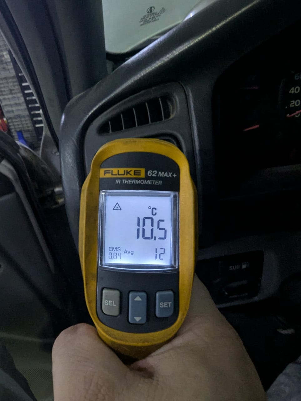

New condenser installed however the AC still need a few repairs,
Previous owner just decided to rewire the entire AC system all the way from the control panel to the AC harness.
The compressor is hardwired to be on 24/7, so it's been a nightmare to undo all the bad wiring the previous owner had.
Good news is the AC system is now working well with no leaks, the guys are still fixing the wiring.
New AC buttons soldered on the control panel:
First AC test, it reached somewhere around 0 deg C eventually:
