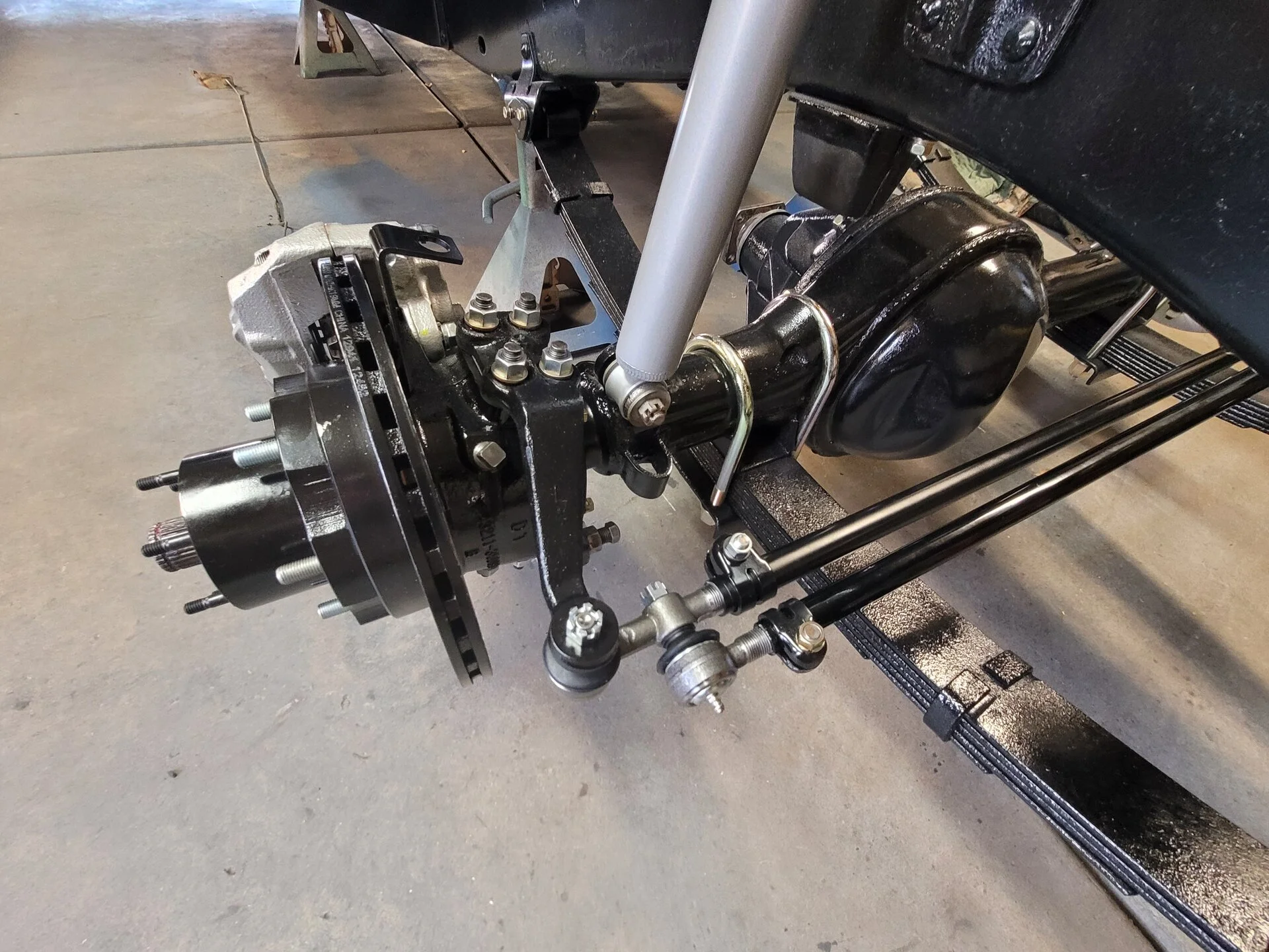

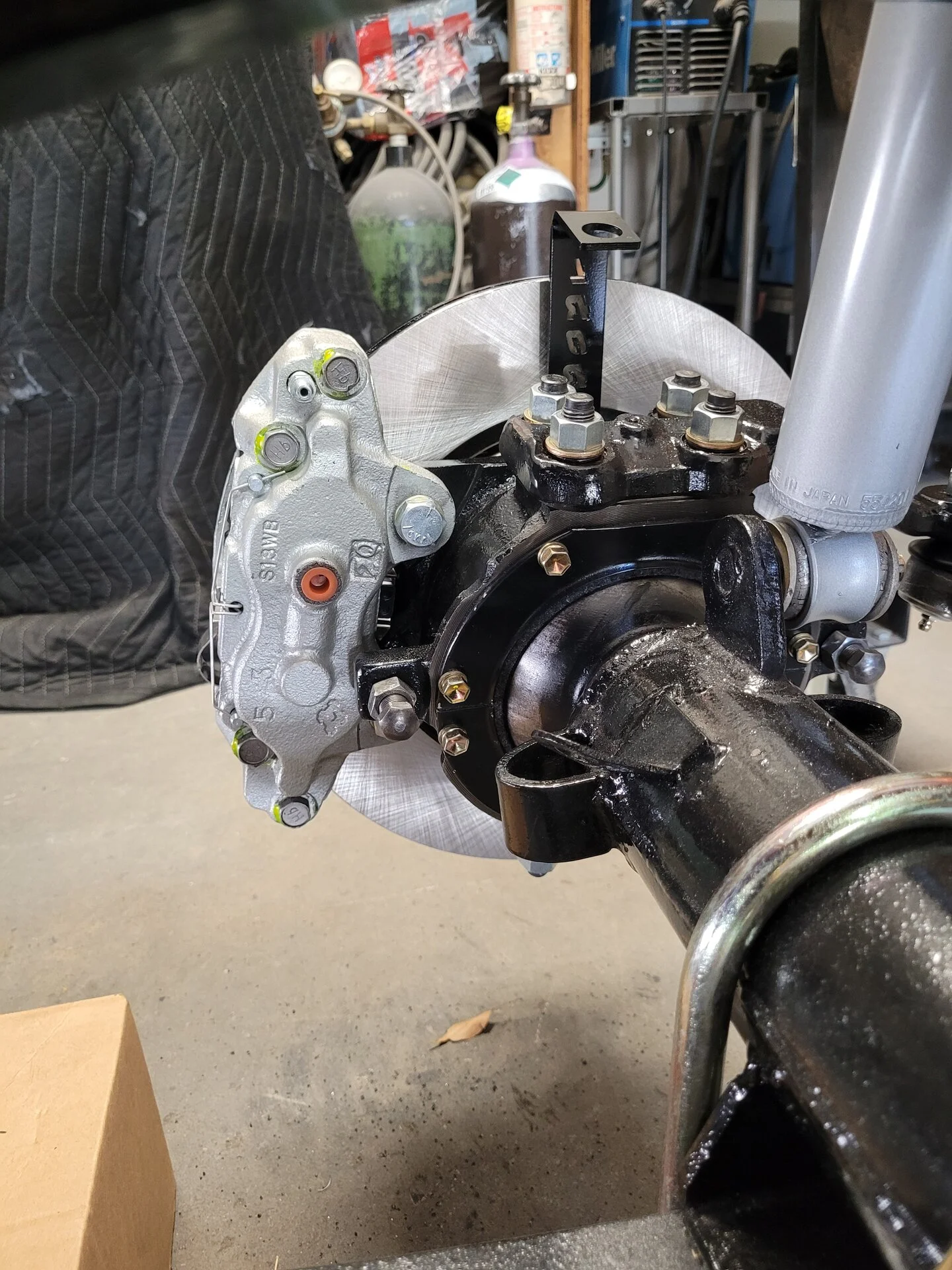

I found this......looks good. Will order some up as 3 of the 4 caliper bolt holes are stripped.....

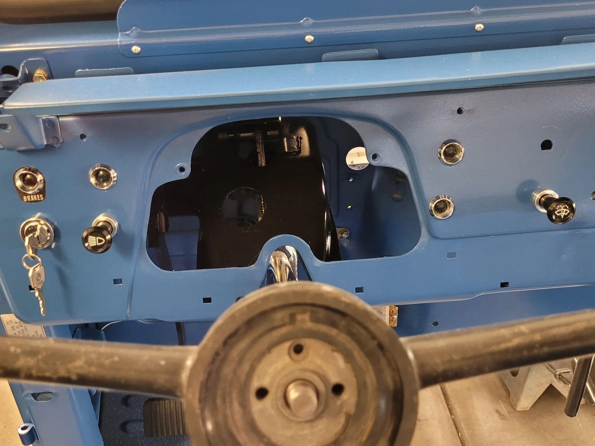

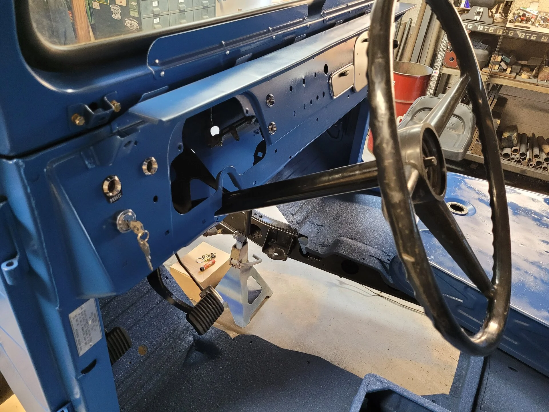

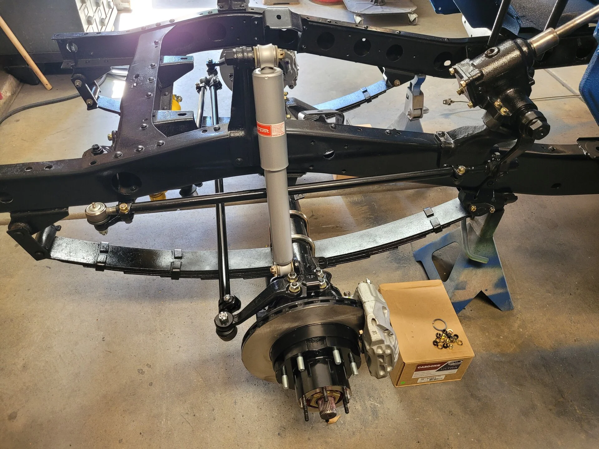

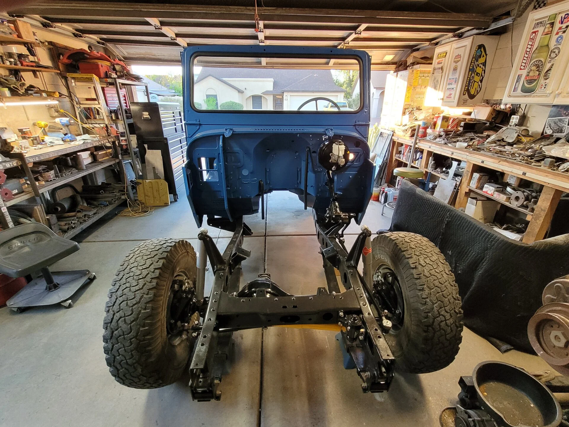

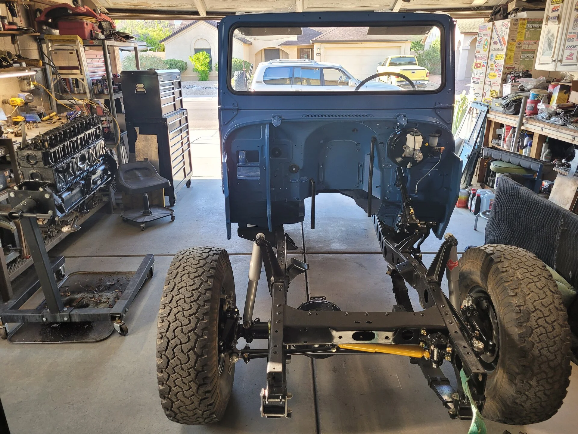

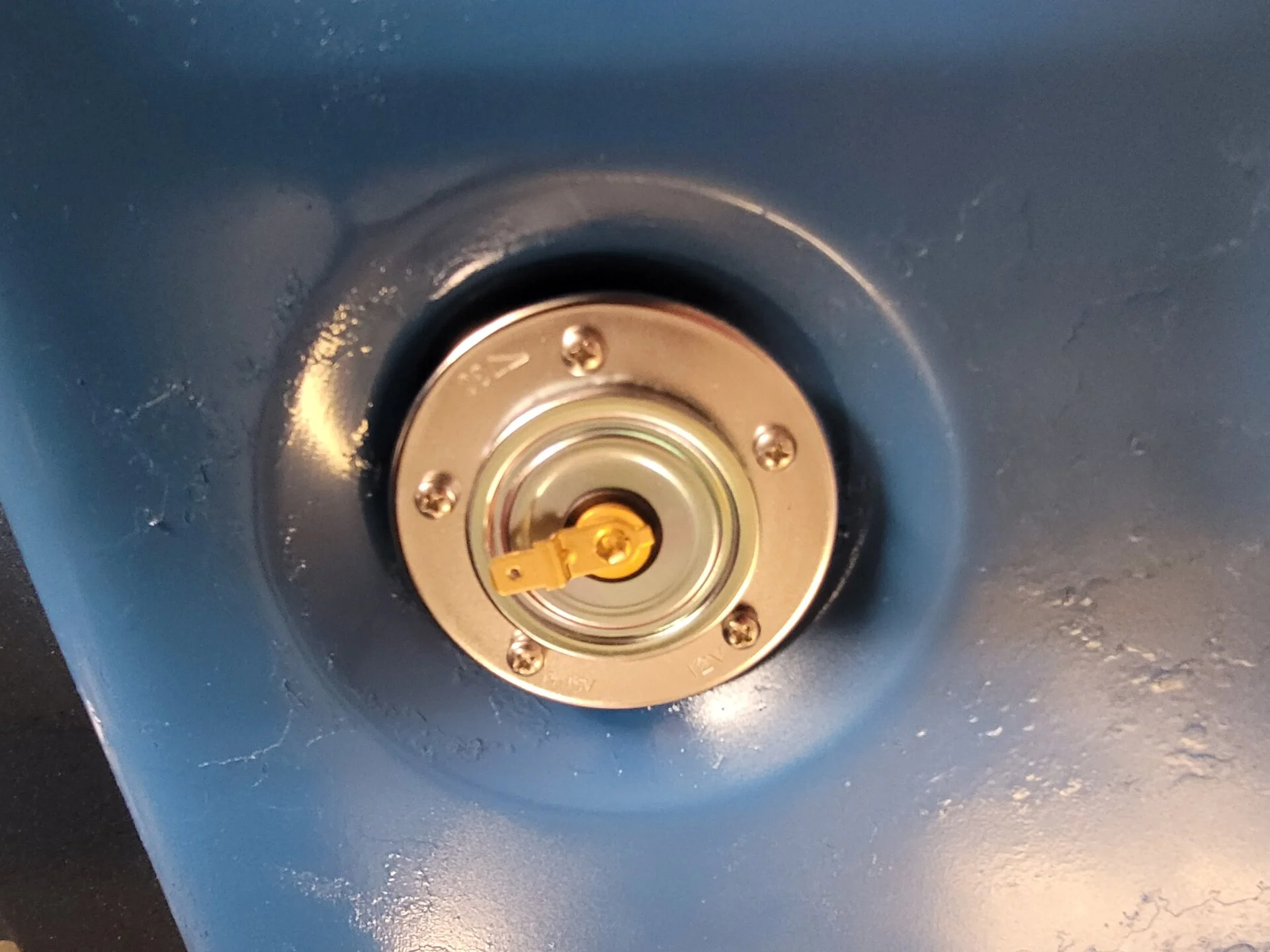

In the meantime, I got the steering assembled. Even added some bling to the dash.
The issue with timeserts is the kit is probably more than a new knuckle! What size is the bolt, I have a few kits, I could send you to borrow! Other issue is Im on vacation til next Saturday!
Jack, if you have the right size tap you can weld the hole up and re-tap it. I have done it a few times in the past, since every knuckle seems to have a stripped hole or 3. Toyota knuckles are cast steel, which is weldable. Just pre-heat it with a torch and wrap it in welding blankets to let it cool slowly afterwards.
I'd do some kind of an insert (but only because I can't weld and do as @peacesells63 suggested). But if you decide on larger hardware instead, make sure the new hardware will fit through the caliper.
Crisis avoided. I was able to retap the caliper mounting holes to except a fine thread 1/2 bolt. Did not have to remove the knuckles to do so. Also I enlarged hole in the caliper, but just barely.

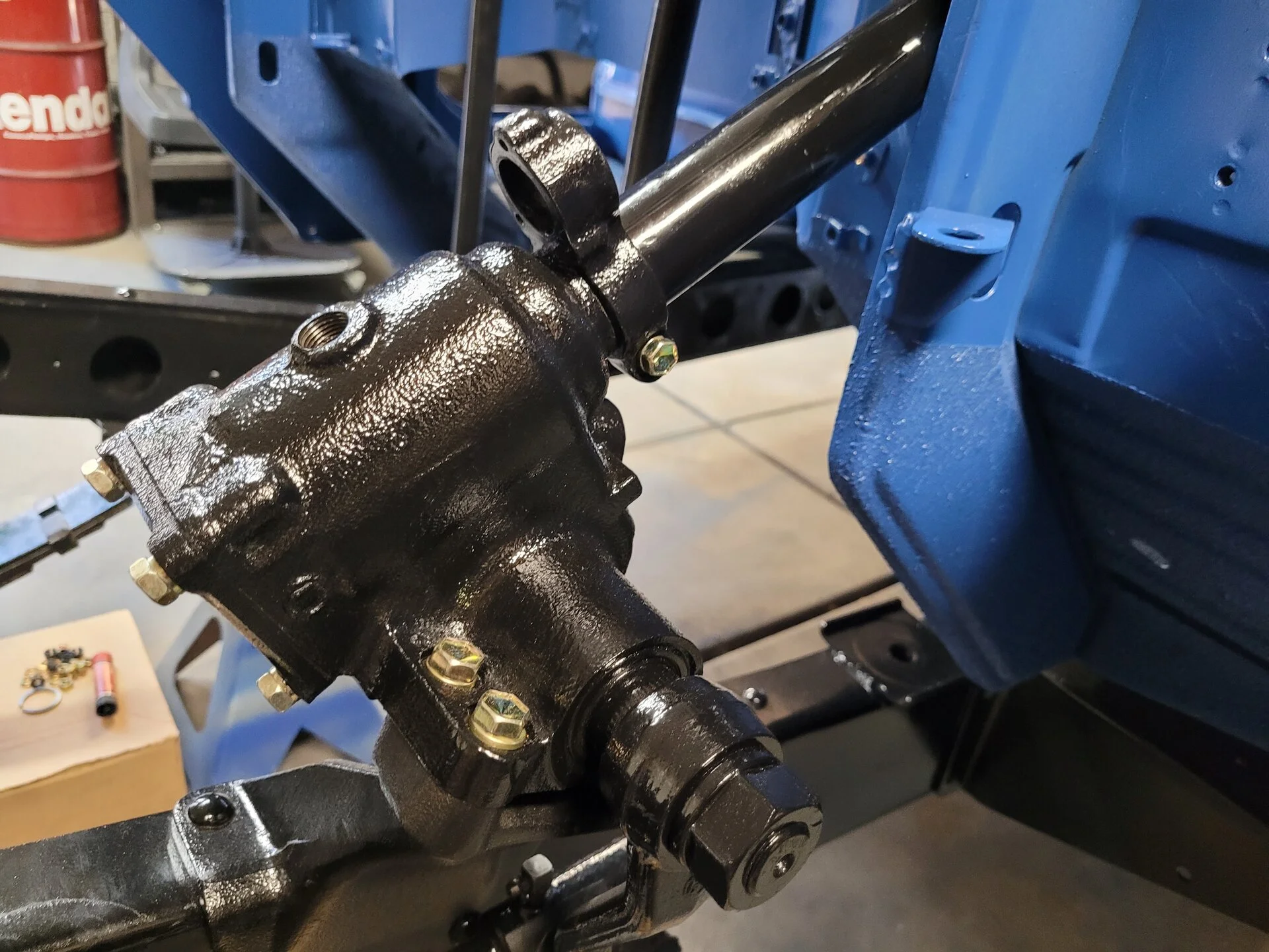

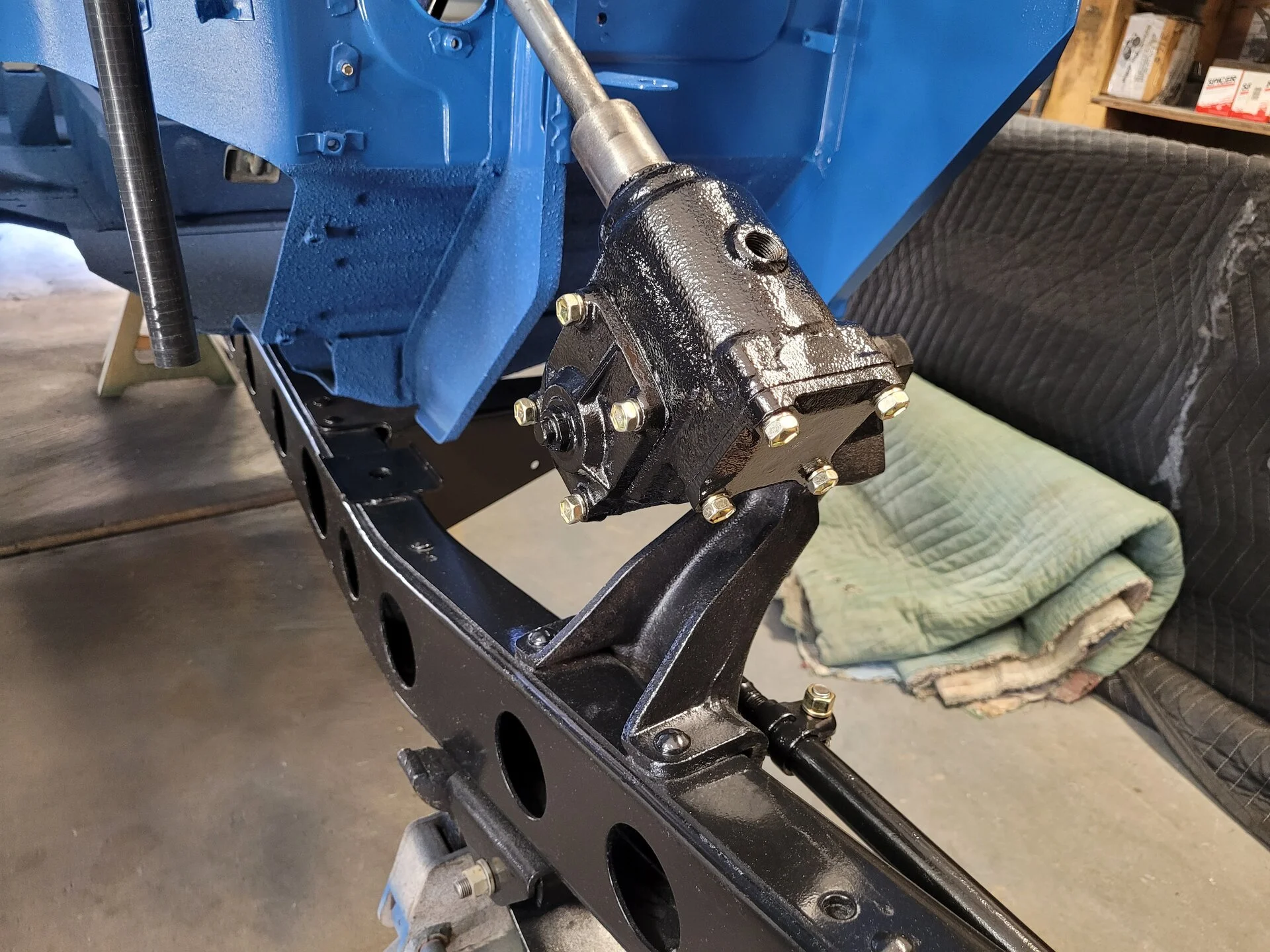

The steering box got cleaned, painted, and resealed. Then installed and connected to the relay rod.
