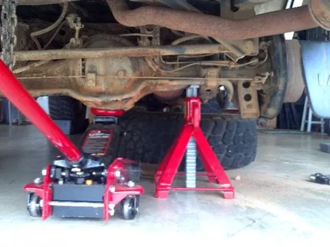

Anyone have a write up or advice on best jack stand placement on an 80? My next project is to fix the parking brake (doesn't work at all) so I need to lift the rear. I know all the usual stuff - tire under side rail, chock wheels, engage CDL, level ground, after on stands push on truck to ensure it won't fall off when I'm under it.
I tried lifting under the rear axle with OEM bottle jack and placing jack stands underneath the side rails (where the frame meets them) but when I lower the jack the wheel goes back to the ground b/c of the suspension. So I'm guessing they need to go under the axles - anyone have pics of best placement?
Maybe this is a silly question but im a safety nut and would rather ask than not. I searched around on the forum but didnt find much info on it. Also could benefit others who have the same questions.
I am using 6T jack stands (6T each) and also have a 3T floor jack but not sure it'll get it high enough (20" height max) unless I'm under the diff - which will only lift one side anyway because it's off center.
Anytime you are working on brakes, suspension, etc you are going to want those jack stands out towards the end of the axles. Or, like you said, the suspension will settle out. If you are using a bottle jack I would only take off one side at a time as they do not have a stable enough foot print and can roll out.
thx for the replies. Here's what I ended up with.

I lift the axle at the pumpkins, slide a stand under each side, lower the jack until the axle rests on both stands and typically leave the jack in place with a small amount of pressure on the axle. 3 points of support.

Jack stands as pointed out go under axle out towards sides. If your work area has a slope put the front of the truck downhill and use substantial wheel chocks to prevent shifting.

Anytime I've tried to lift my 80 from the pumkins on the axles with my floorjack, I end up only raising one side of the truck off the ground as they are offset. Can I damage my axles by jacking from the axle tube in the center of the truck, beside the pumpkins? I'm guessing no, but I'd hate to find out differently the hard way.
You'd be fine jacking from any point on the housing. However unless you have a TALL jack you might not get enough lift to fit stands underneath.
Sorry I do not agree about working on the vehicle whilst is is facing up or down ANY slope, level ground only. Next, if you use the trolley type jack the ground must be smooth, as you jack the car up the trolley is supposed to move under, if the wheels are chocked and the trolley wheels dig in then you could end up with the car staying still and the jack slipping off from wherever you have placed it.
