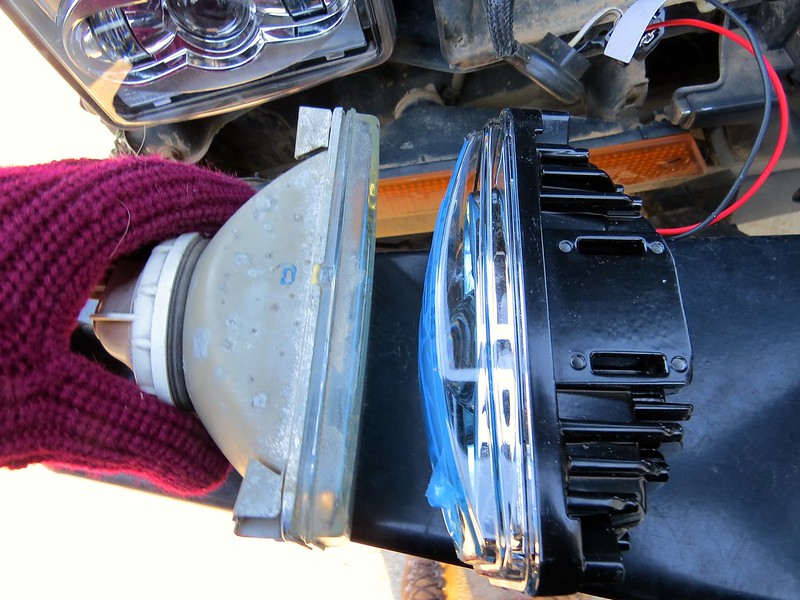

J.W. Speaker 8800 Headlight Install (Easy)
Just went downstairs and found these sexy twins by the front door! Ill install them tomorrow.
how the lights looks aesthetically don't really matter to me...its how they perform... good info

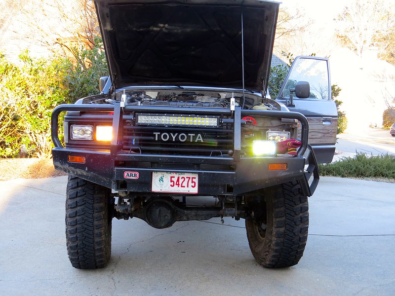

Got the high beams hooked up his morning :)
They needed no modifications to work with the existing harness.
Much larger diameter projector compared to the low beam
I wasn't feeling the whole normal/weird combo, but i think the weird/weird works much better. Looks freaking awesome imo!
Night shots will be added tomorrow night :cheers:

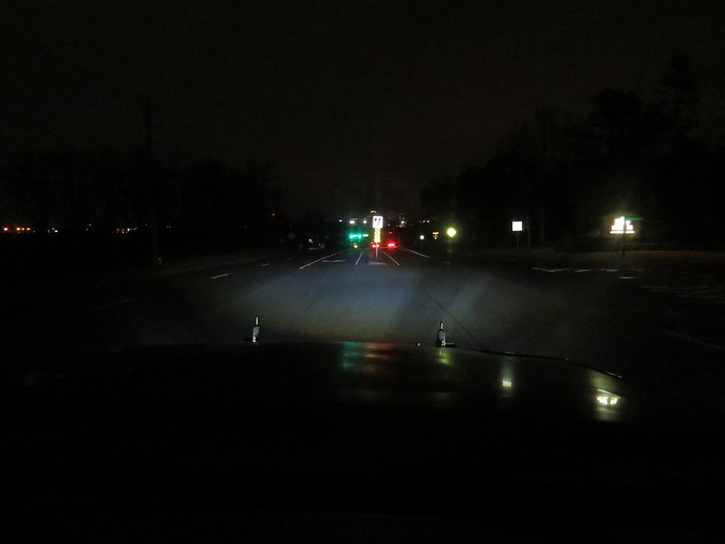

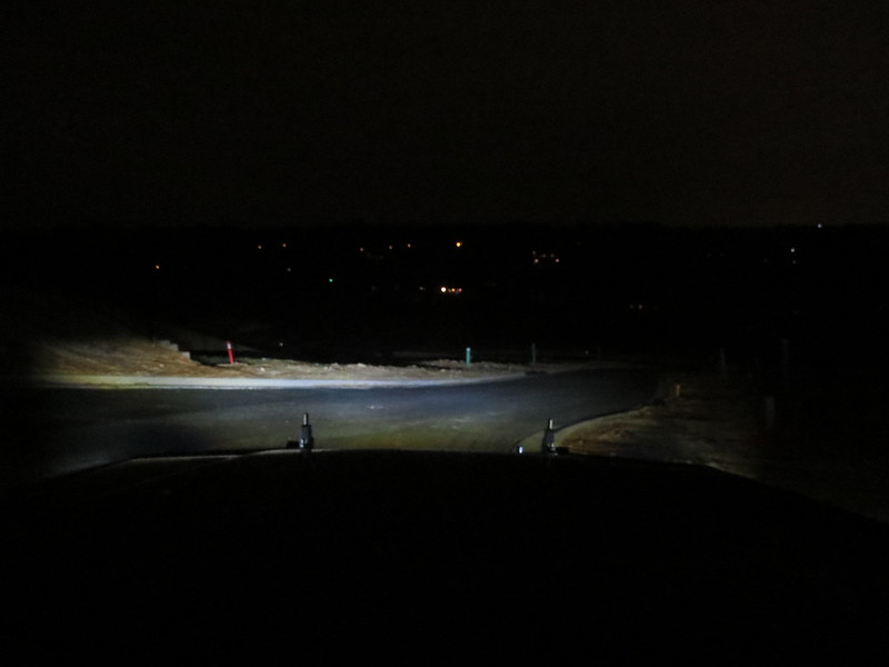

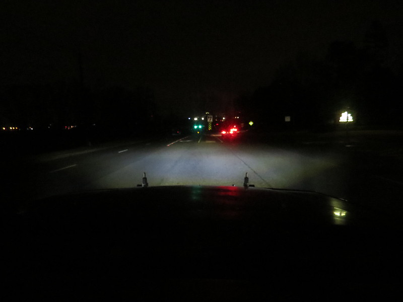

Well i finally got to aiming the high beams tonight and I'm afraid I'm not really impressed with them.. The low beams are great! exactly what i wanted, but the highs.. Ill just get to the pictures haha.
Highs:
Lows:
Highs:
Lows:
If anyone can see what I'm doing wrong aiming wise, id love some suggestions haha. Ive talked with Erik (slcfj62) and they're all hooked up correctly. My expectations may just have been too high?

@robustbambi...any luck getting the high beams adjusted? What exactly are you not liking about them?
I aimed them down more and it helped a lot. The arb block some of the light that would shine on the grind directly in front of the cruiser. That's the only real negative now. If I took the bumper off, the lights would be perfect.
