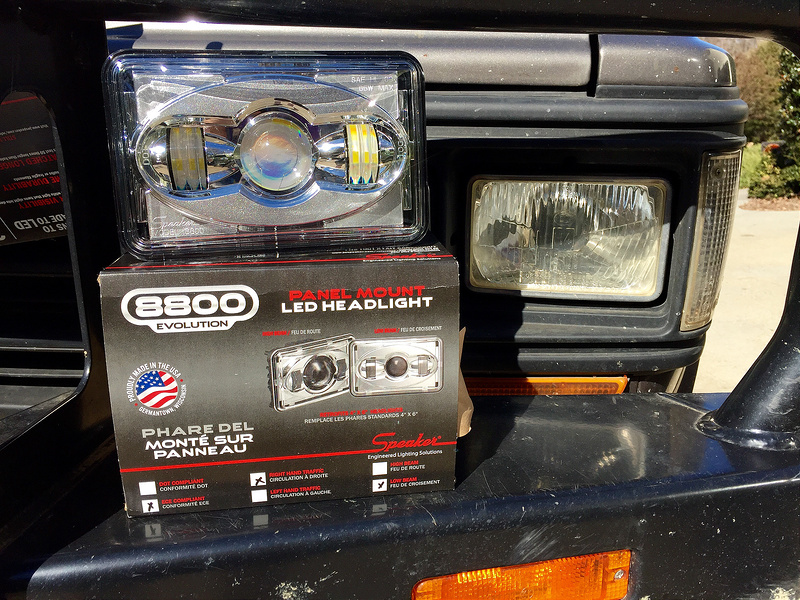

I ordered these low beams earlier this week from ok4wd (http://ok4wd.com/shop-by-vendor/speaker-lighting/j-w-speaker-8800-led-headlights) to replace my Hella H4s that id been thinking about upgrading for a while. The Hellas weren't bad by any means, i just wanted a more "up to date" type of lighting.
Styling wise, you either love it or you hate it. Personally, i hate it haha. They look goofy as hell imo, but i got over it when i started doing research and seeing how these lights actually performed. And in your hand, they feel like a quality product, nice PC black aluminum housings and thick polycarbonate lenses... They feel like they can take some abuse, not like a "Made in China, Ebay LED" kit.

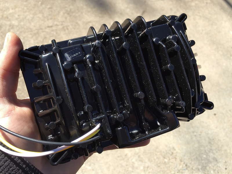

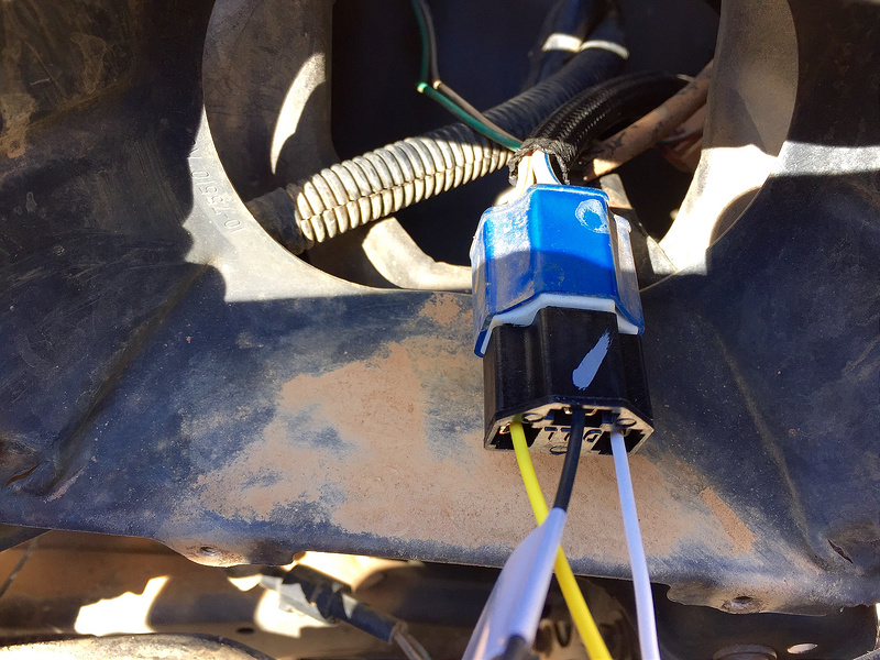

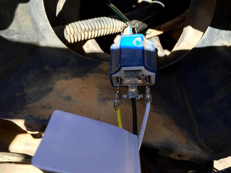

Ive read that theres a little confusion about the correct orientation of the 3 prongs to get these headlights to work with the the upgraded headlight harness from slcfj62.
Out of the box, 2 of the headlight prongs need to be swapped around or else the lights won't get power.
So here's the two minute fix... (and most of that time is spent looking for the tools)
Tools:
-Philips head screw driver
-Flathead screwdriver
-needle nose pliers
1. Remove the Bezel, Turn signals, and headlight retainers.
2. With the needle nose, pinch the prong retainer down on the side of each prong and pull it out of the black plastic holder.
3. Switch the black and yellow prongs around.
4. using the flathead screwdriver, carefully pry the prong retainer back into position so that the prongs dont slide back out of the black plastic holder.
5. Plug the head lights in.
6. reinstall the headlight retainers, bezels, turn signals, then aim the headlights so not to fry anyone's eyeballs.
7. Watch (in perfect white light :D) as the panties drop while you cruise around town.

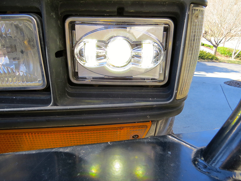

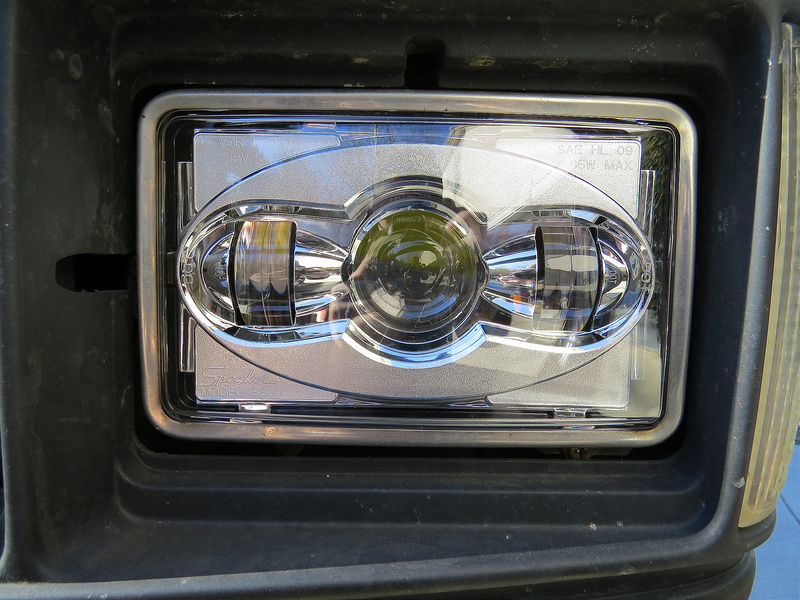

These pictures below show the correct headlight prong orientation to work with slcfj62's ultimate headlight harness.

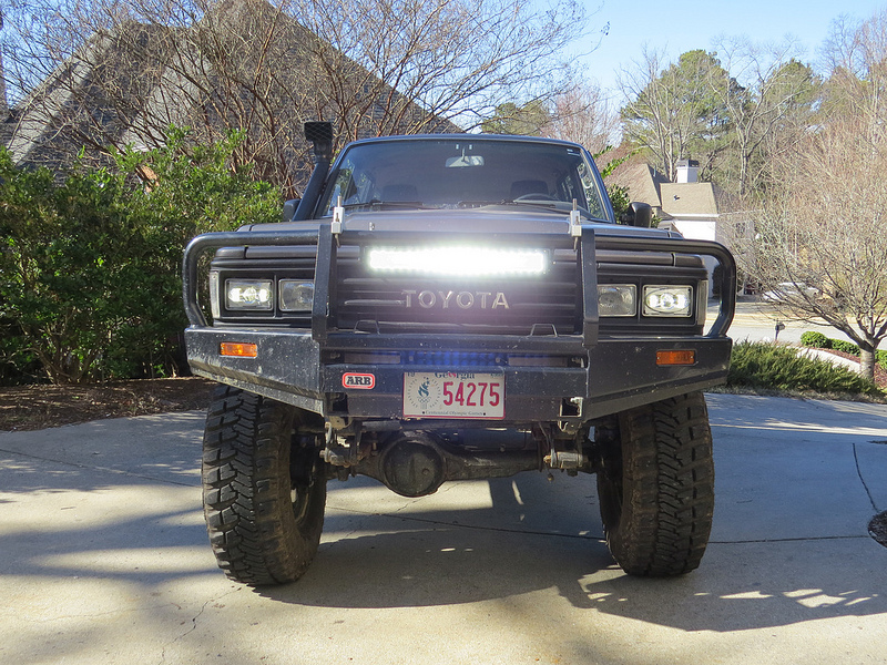

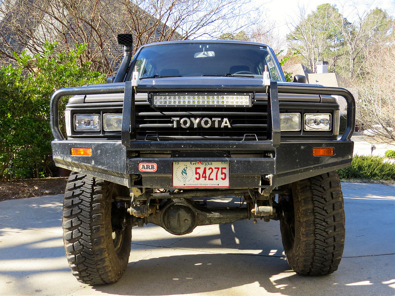

Glamor shots.
Night shots will be added tomorrow night. Don't have time tonight. And if I'm freaking blown away, ill probably get the high beams as well and add to this thread.

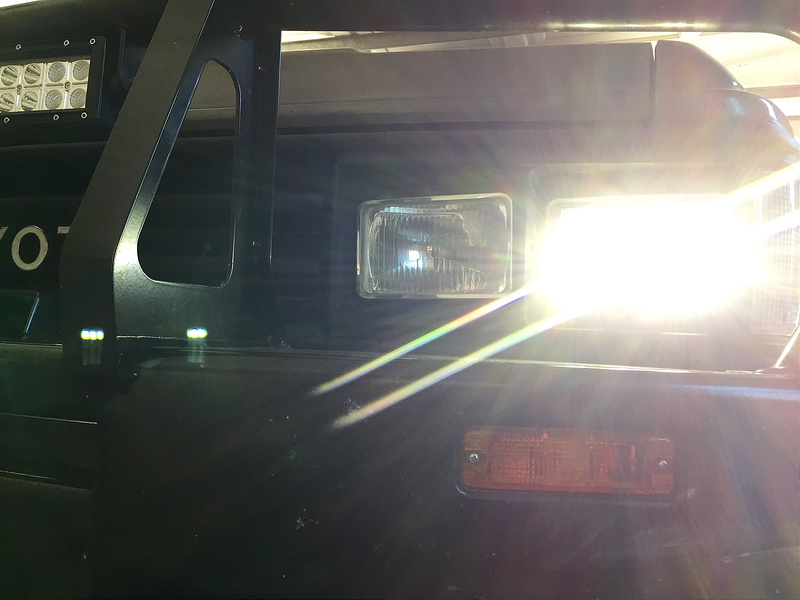

Heres a good comparison between a few different brands/types of headlights on pirate. (http://www.pirate4x4.com/tech/usmcdoc/lights/)
The JW's blew the trucklites away. That being said, the trucklites are way less expensive.

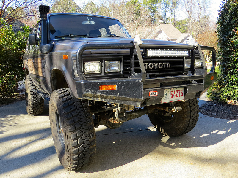

The light bar is some 22" curved bar off ebay.
Thanks for just putting 1 in on each side. I like the comparison pic. Would love to see a night pic.
First impression.. me no likey.. But, it it's cranking out the light, that's a good thing?

Hahaha yes i only swapped the low beams for the comparison shots, not because i can't swing $1200 in headlights at this time hehe ;)

Thanks. I got the light bar here. (http://www.ebay.com/itm/20107766630...49.l2649&ssPageName=STRK:MEBIDX:IT&rmvSB=true)
For $100 its fine. Yes it adds a ton of light for off road. Its a spot/flood bar so more of an all arounder. You'd probably need a curved flood bar if you're looking for the widest possible peripheral beam to find a campsite.

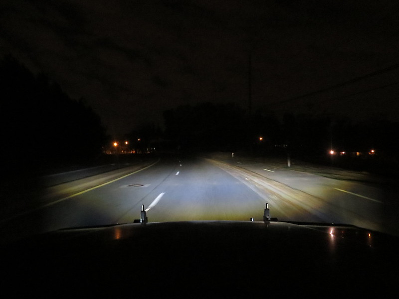

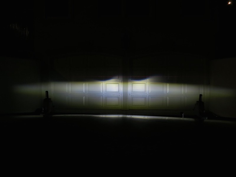

Borrowed the neighbors house to aim my headlights again tonight and take some shots.
From about 15ish feet away:
And with the light bar:
Sorry these are so blurry. They show the width of the beam pattern pretty well though.
