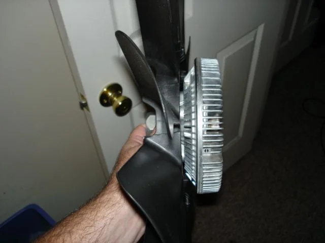

My fan clutch sits pretty close to the radiator too. My fan clutch and fan are a different year model and minor design differences. I've never had an issue with the fan eating the radiator, but I know it can happen...what the magic distance is I don't know...obviously you don't want the radiator to come in contact with the fan blades.
I like the GM fan clutch and fan on my truck...its the #1 cooling solution and I never have issues with cooling, since Ive been setup this way.

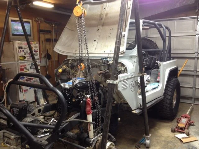

while not the greatest pic...we did get the engine to sit a little better square with the radiator core..after this pic was made.
I can get in there to roughly measure the distance between the core and the fan clutch if that would help you.. Obviously the fan clutch is fixed and the fan blades can walk forward to some degree, given the right conditions. So far I've had good cooling and no issues with damage to the fan blades, the radiator or shroud.

Read the whole thread, but here is the info ya asked about...., for an extra 1" use a clutch from a 94 350 TBI Impala-Roadmaster.............

Thanks for all the input guys! I have 1" of clearance between the radiator and fan clutch fins and 13/4" inch between the radiator and fan blades. I am going to run it this way and see what happens, if I get into the radiator I will do something different. I will be in the shop tonight and get more pics.
