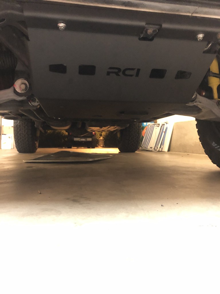

the engine skid plate from rci came the same day as the rock sliders. you can say it was like christmas.
I hate mud update 2 by Alexander Rengifo, on Flickr
Tinkering by Alexander Rengifo, on Flickr
nice hardware from rci

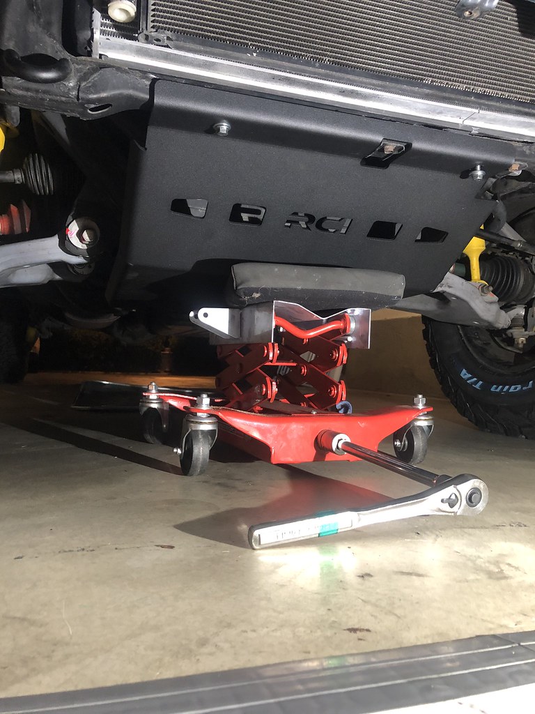

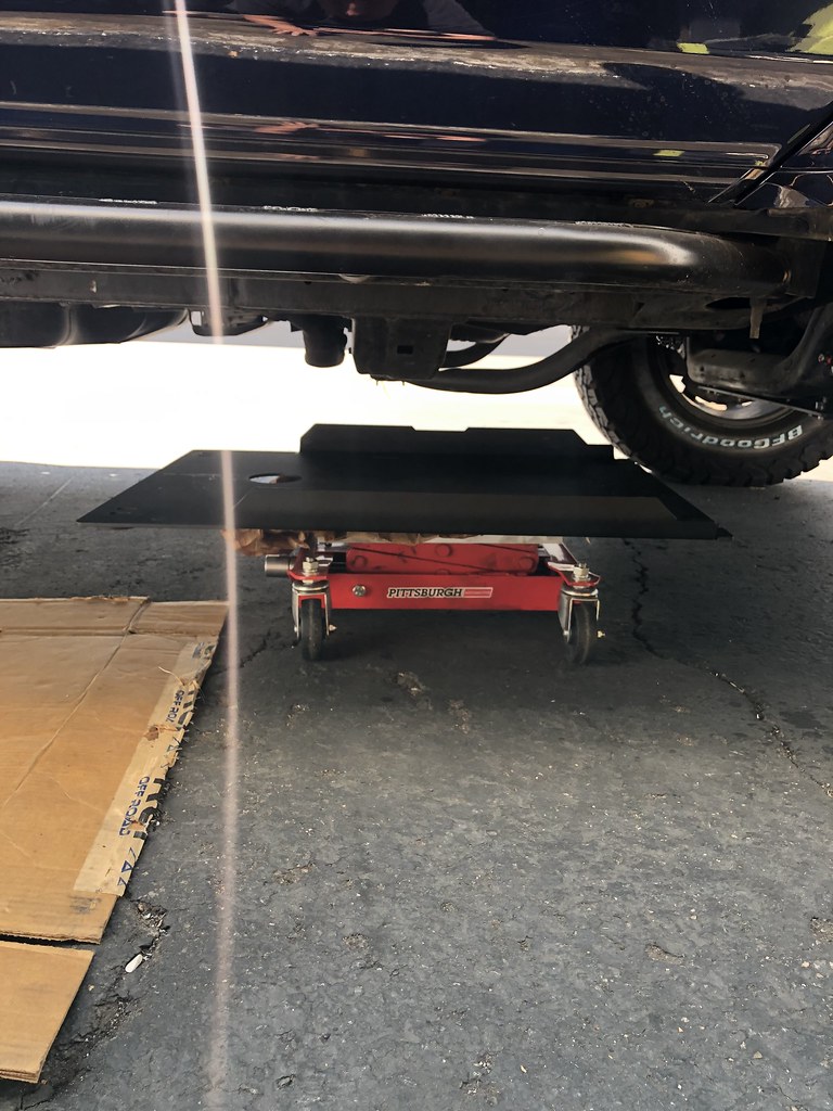

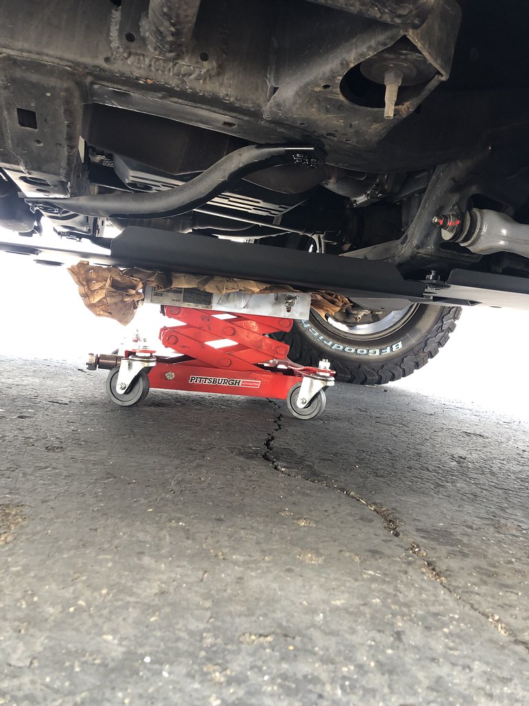

installed with my transmission jack this skid plate is heavy and awkward to balance and install the bolts
done! fits great

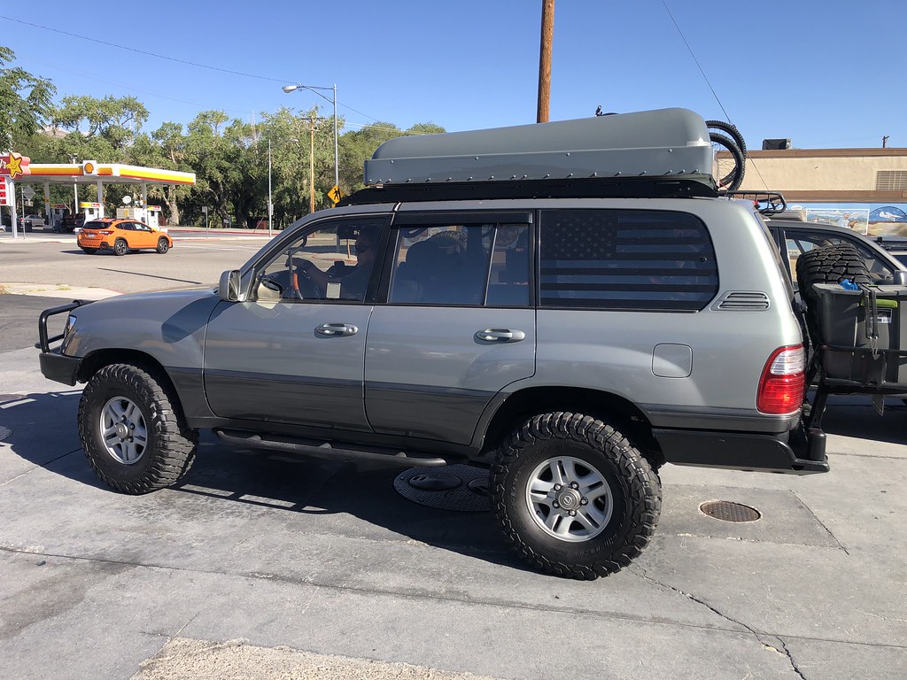

gas somewhere middle of nowhere california.

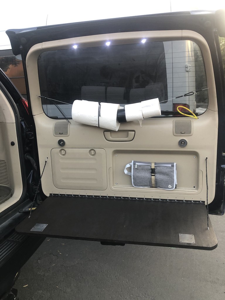

the folding table i made from scratch works great!

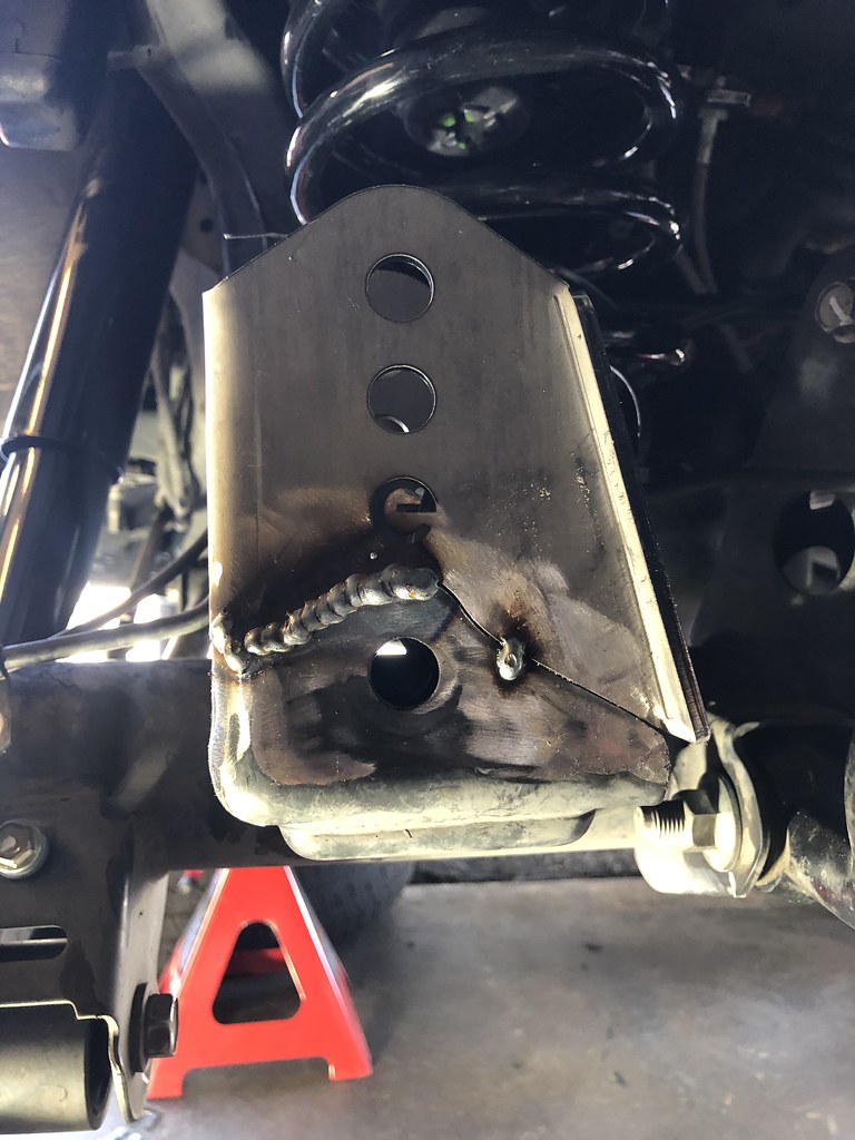

he came over and we worked on his eimkeith pan hard relocation bracket
the grey whale at my work
up in the air near the welder 220 plug
back that ass up
eim keith bracket fits extremely well.
paint ground down
2 magnets keeping it in place until we tack weld it
i gave bryan some verbal instructions and had him tack weld his on bracket.
Welding by Alexander Rengifo, on Flickr
his tacks are good! good listener great teacher :)
but then took over and welded it myself he is still a squid noob at welding
i then laid a fat bead. i dont care about looks. i want a strong solid weld and i trust my welds for his family's safety and i don't question it.

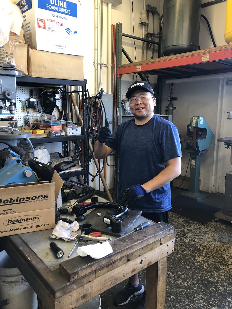

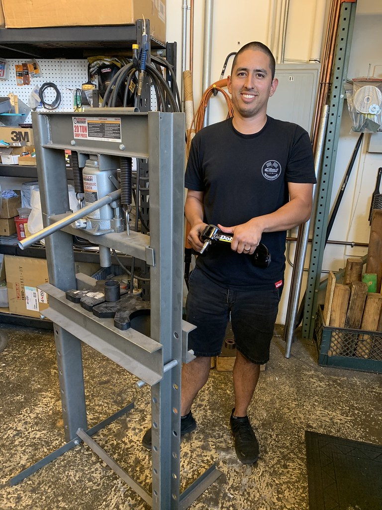

next up was pressing the ball joints on the dobinsons upper control arms.
done

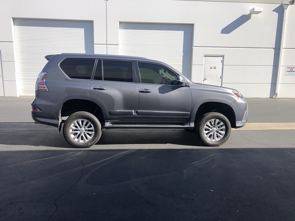

dobinsons lift and eim keith relocation bracket on and on the way to get the tires and wheels and tpms taken care of.

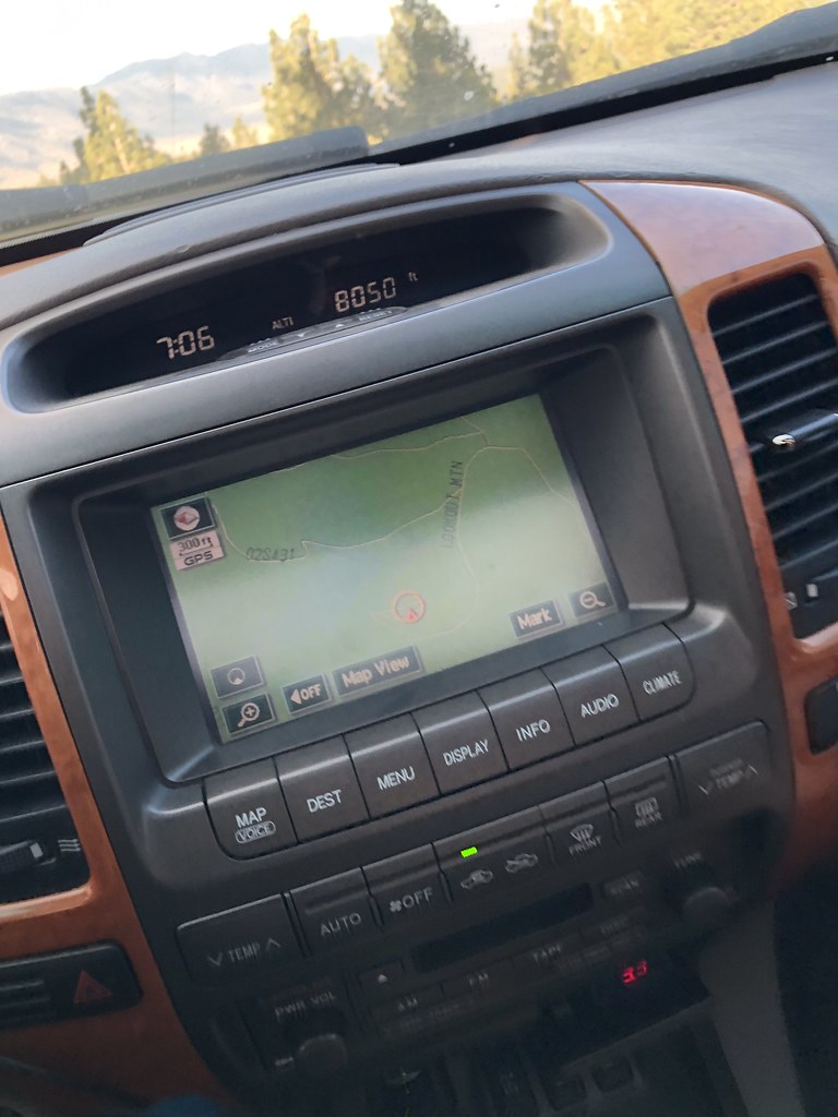

top of lookout mountain in mammoth is 8050 feet
easy trail if you dont make a wrong turn

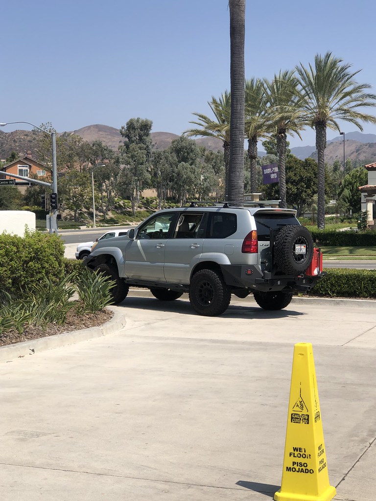

Thanks Alex. The rig isn't in my driveway yet, but I hope to have it in the next 2 weeks.
Once I do, I'll be in touch and see about a day trip to test it out with you guys. Maybe Cleghorn or the Saddleback area. :cool:
Your rig is looking great!

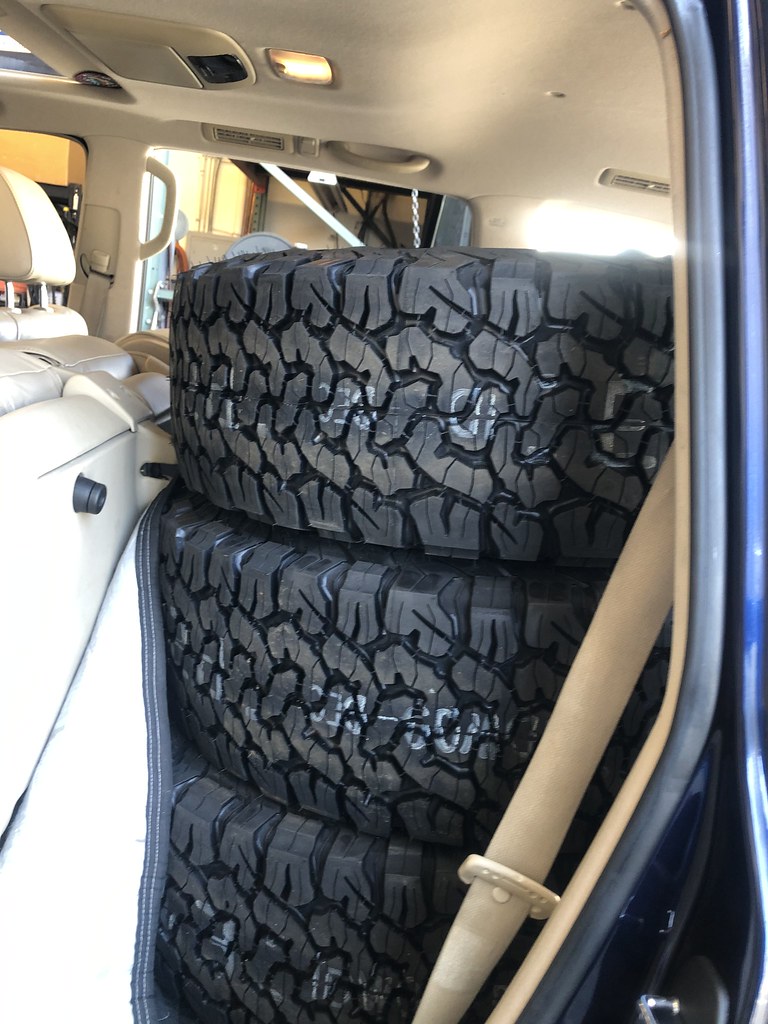

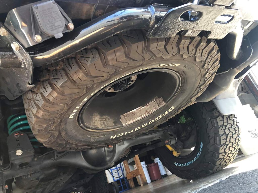

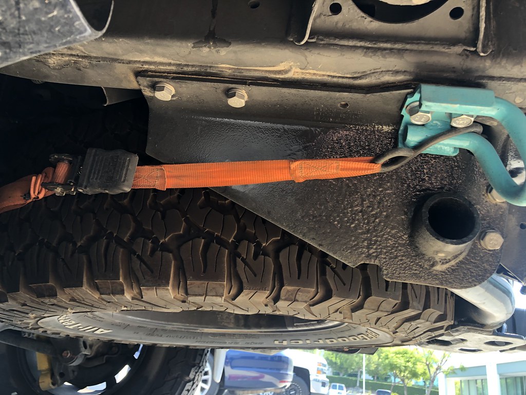

Based on your pic, it seems like the spare tire issue could potentially be solved using a custom panhard bar that 1) is made of a thinner and taller steel section (maybe oval or rectangular) and 2) is located slightly closer to the rear diff. (perhaps by curving it right around the spare tire area) Seems like an easy fabrication project for someone to tackle and maybe solve this issue.
folding table working great. i added some lights and a latching toggle switch

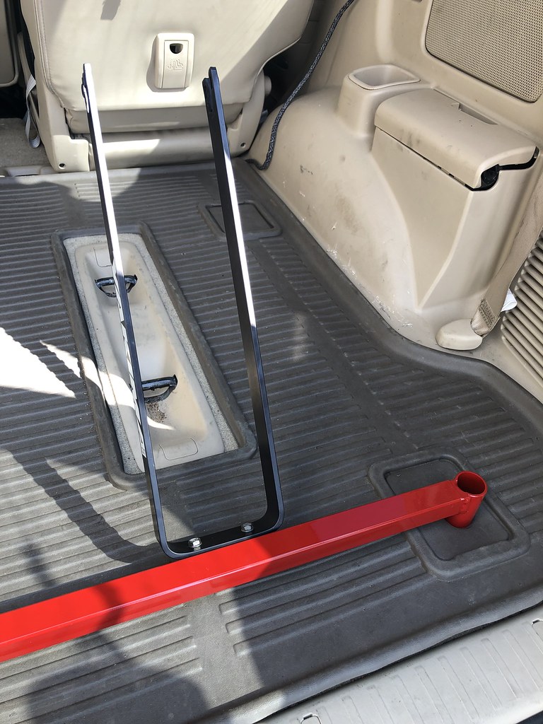

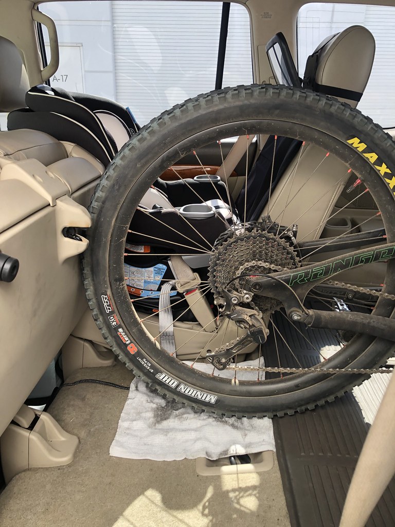

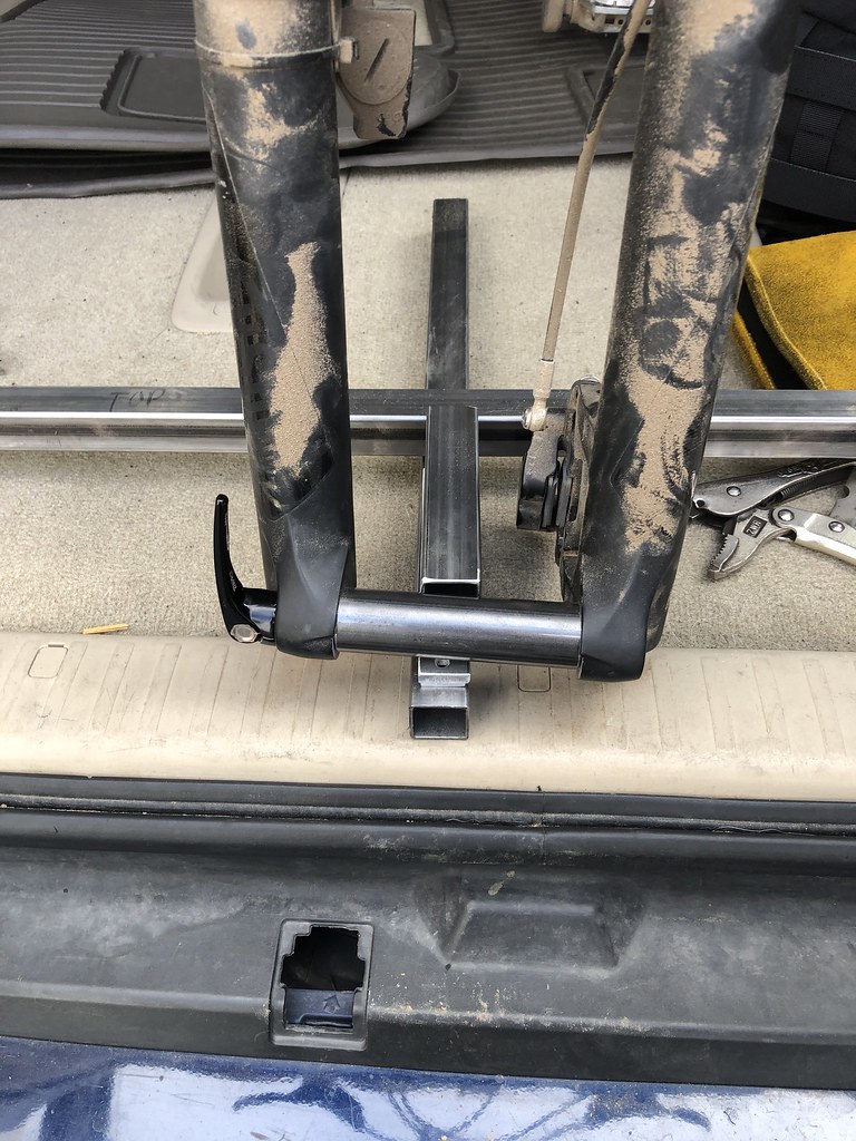

im always tinkering with stuff. i wanted a bike mount that fits inside the cargo area of the gx.
Next update by Alexander Rengifo, on Flickr
done it bolts into the anchor spot and has a removable front wheel fork
tire touches the second row

some of the off shoots in cleghorn intimidate me. dont want to roll the rig over. risk versus reward isn't there for some of the trails.
thanks. ya that would absolutely solve the tire problem. i solved it by building a swing out spare tire carrier. will update the build thread with that project later.

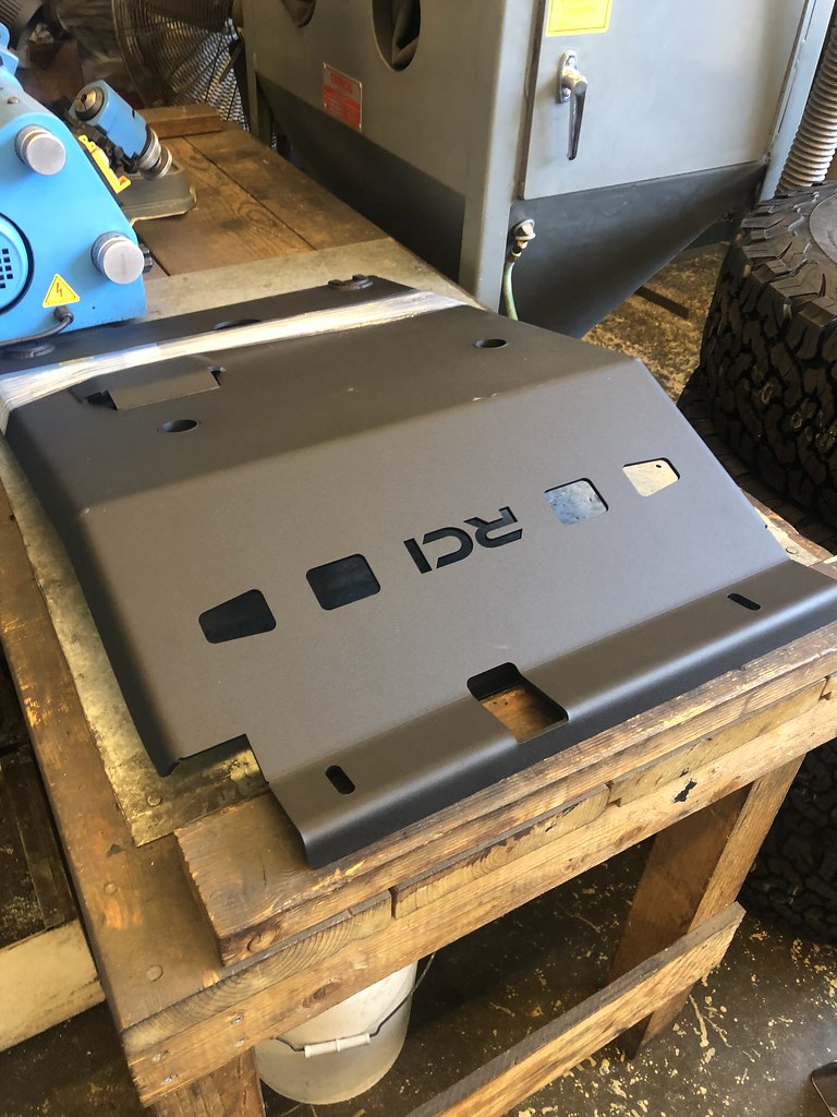

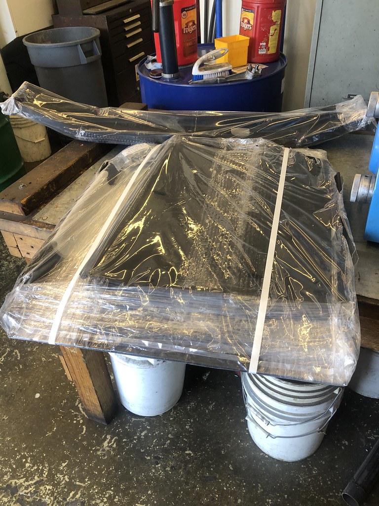

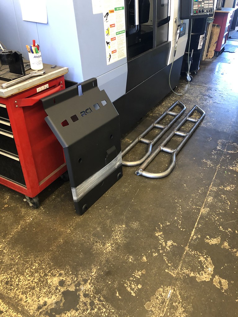

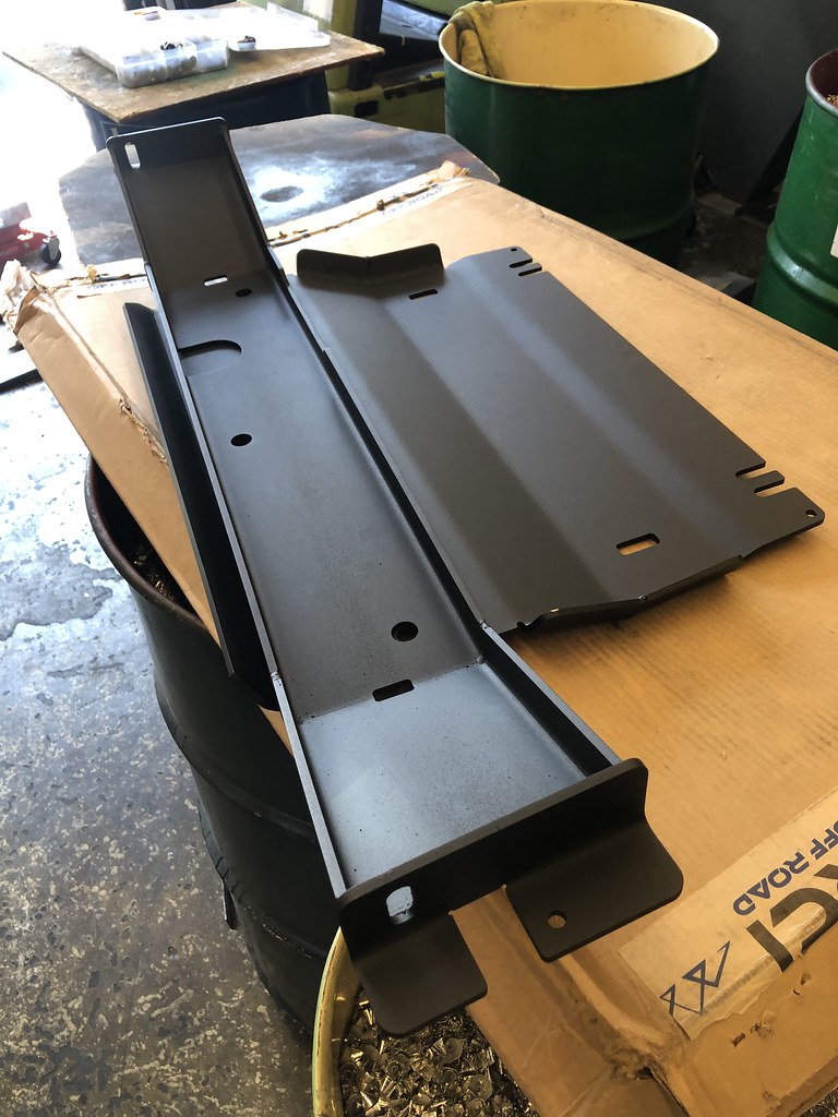

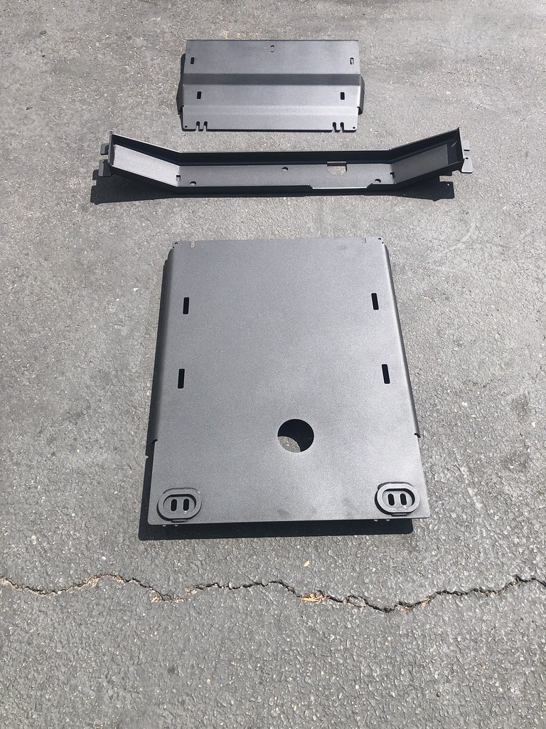

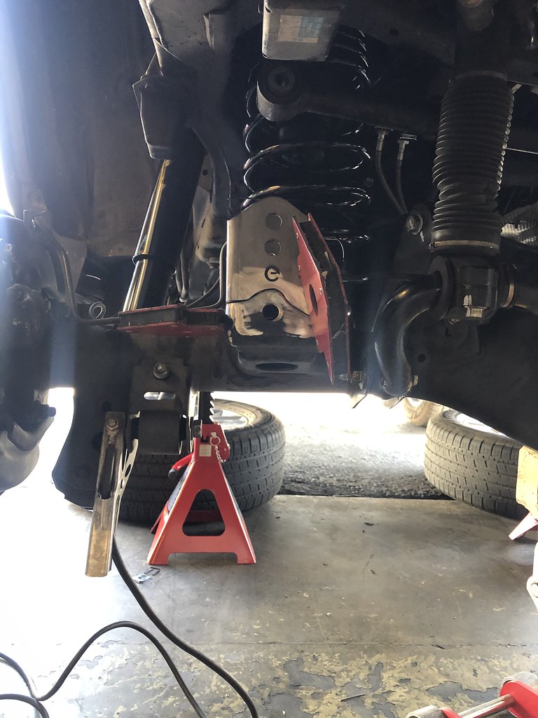

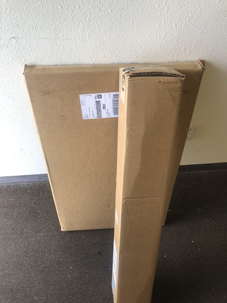

i ordered the rci transmission and transfer case skid plates
after 2 months they arrived.
Update by Alexander Rengifo, on Flickr

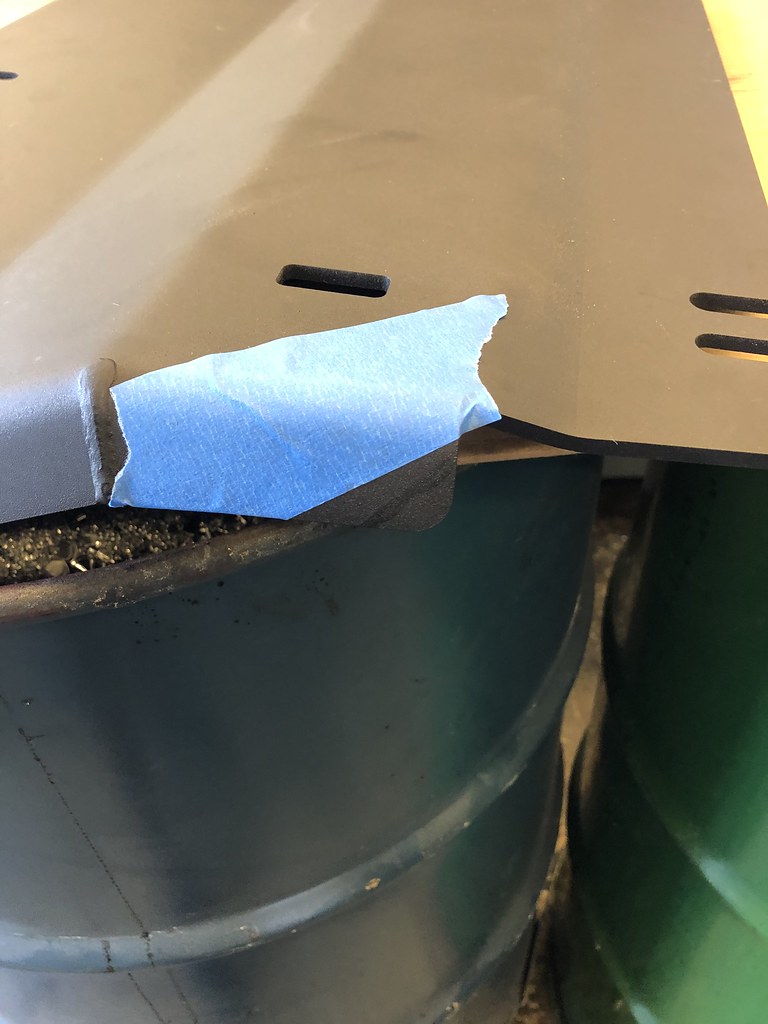

some moron at rci didn't package these brand new freshly powder coated wrinkle black parts and they got all ****ed up.
i know im going to scratch them but i would like to be the first one to scratch them

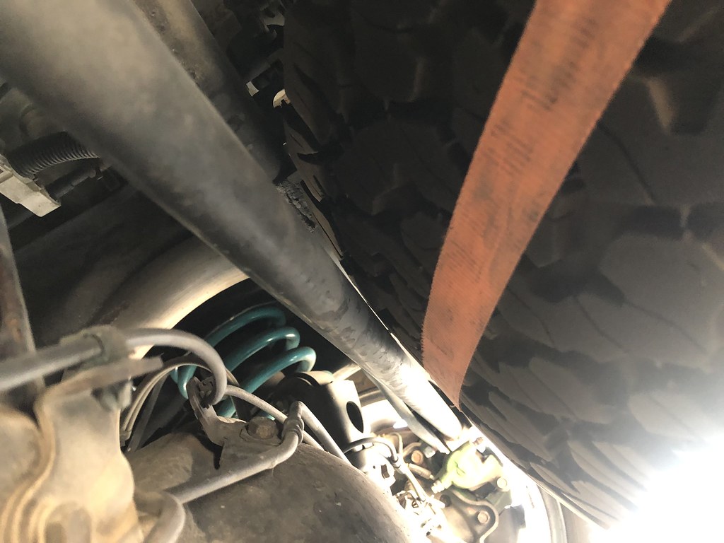

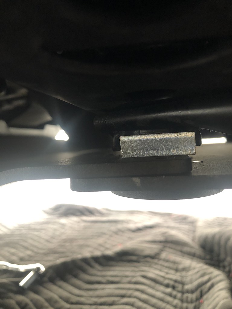

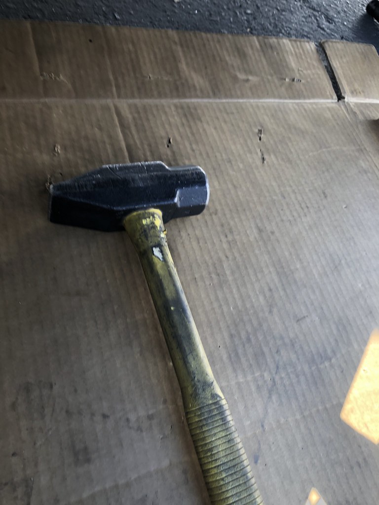

next annoying problem was that the rci cross member for the transfer case interfered with the factory gas tank skid plate
it had to smashed in with a sledge hammer to provide enough room for the cross member to get bolted to the frame
nothing a 5 lb sledgehammer cant correct.
just annoying that after spending around 1000 bucks
needing to share the same space
trans jack for the win

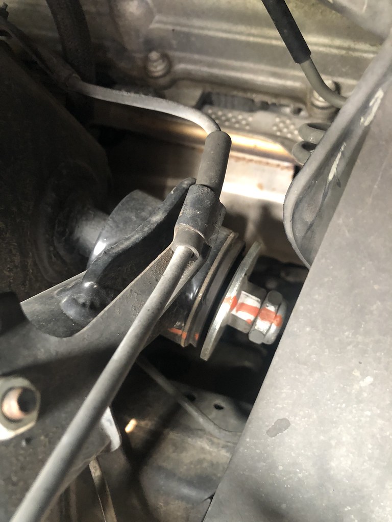

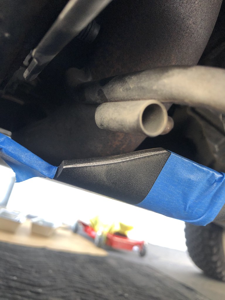

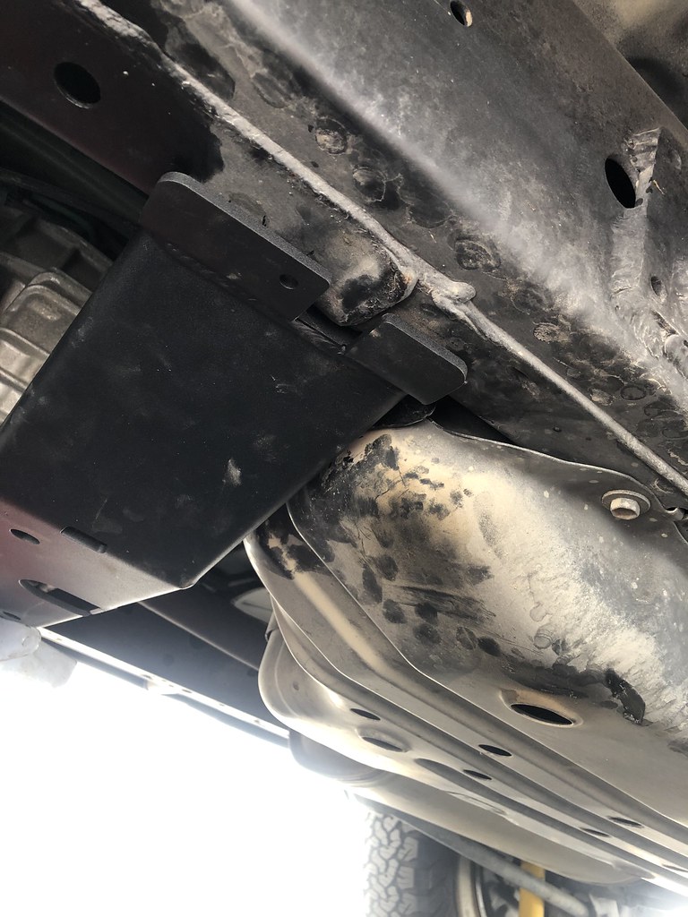

next annoyance was the transmission skid plate hit the exhaust hanger. i cut this corner off and painted it and now it clears.

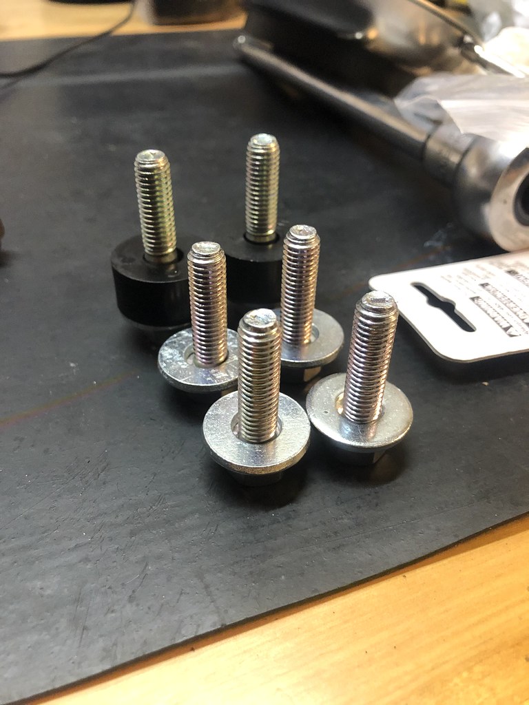

make sure you use the spacers they provide so the skid plates clear the round bar under the catalytic convertor

I have the aluminum RCI skids and they hit the exhaust hanger too. They're nice skids but for the money, I'm not expecting to be using an angle grinder to make them fit.

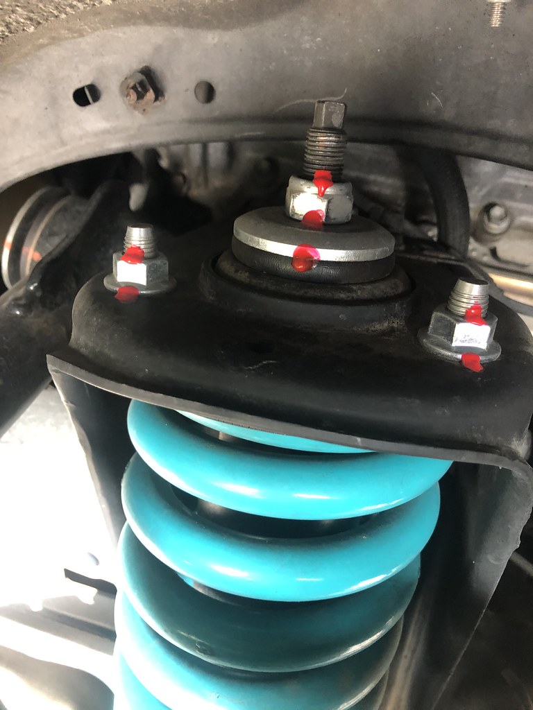

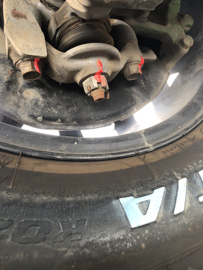

doing race prep on my bmw has taught me to do full nut and bolt check. I have been adding pen pen marks for years. then you can do a quick walk around before a trip and you are good to go. or if you hear a weird sound you can get comfort by seeing important fasteners still in place.
sweet gx i spotted at in n out in foothill ranch ca

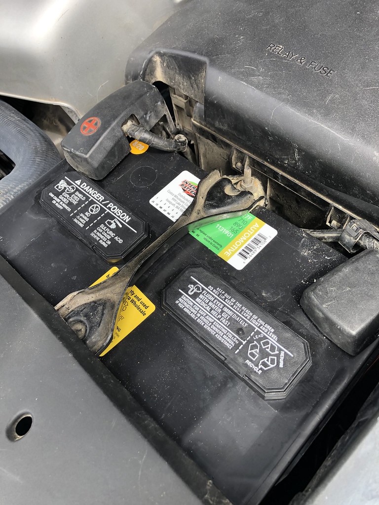

battery started acting up new costco interstate stock battery replacement.

another gx spotting at my local mountain bike spot at whiting ranch
this bike rips
norco range
carbon frame
carbon nox composite wheels
