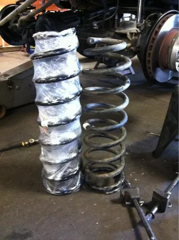

I just finished swapping my J series springs and MT 2" spacer for some 4" King Springs.
I wanted to see the difference in lift between the 2 lifts. I measured each wheel well for clearance.
850J's + 2" MT spacer = Driver side 7.75" and 7.5" on the passenger side.
863J's = Driver side 6.25" and 6.5" passenger side.
4" King Springs -
Driver side front - 8"
Passenger side front- 7.5"
Driver side rear - 7.5"
Passenger side rear - 7"
Front springs
Rear springs

How about some center hub to wheel well measurements to rid out the difference in peoples tyre sizes :)
Curious on the the ride with the 4" setup compared to the J setup as well :)
