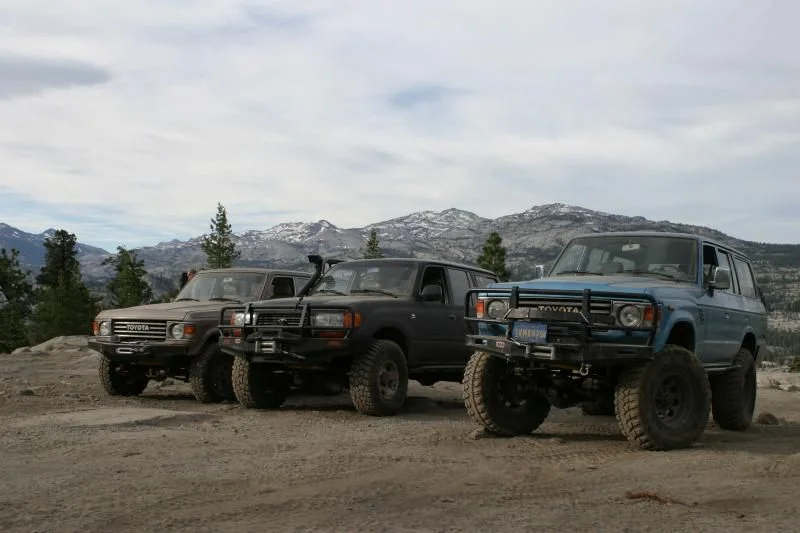

Still basically the same truck. It has a few more dents, I did Rubicon and Dusy in it this year. Dusy is very hard on a wagon. The changes-
I made it wider with an 80 rear FF axle
Changed the rear locker to a Harrop from an ARB
Changed to stiffer shocks
Future plans:
Rough Stuff housing and wider front-front has spacers now to equal the rear. It works great, but I don't like spacers.
Things I wish I had done:
Sway bars, front and rear. Spring overs need these to be comfortable and safe(er)
I am considering downsizing to 35 inch tires.
Cool to see this thread back from the dead. I still have the truck and drive it maybe 14 days a year. It's a great wheeling truck. Really great. But it sucks around town as a driver. In my opinion, spring overs make for greatness off road and suckage everywhere else.
