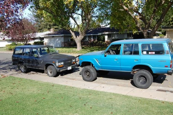

I just had to share a few pictures. I've been planning a SOA for a long time on my 60 and have been saving parts and pieces. I had the last 4 days off work and figured WTH, and did a spring over. Of course it isn't complete-it needs brake lines, rear shocks, a bit of final welding, but here is 4 days of progress. More details when I get it fully complete and my ROTW comes up. (I backed out of my ROTW spot since I was planning this.
Comparison is a fully stock 1989 FJ62 and it's still sitting on the 33 inch tires it was on before I started.

More Pics! Wow, having a side by side comparison makes it look like a different vehicle.

DAMN that's a good looking truck.
