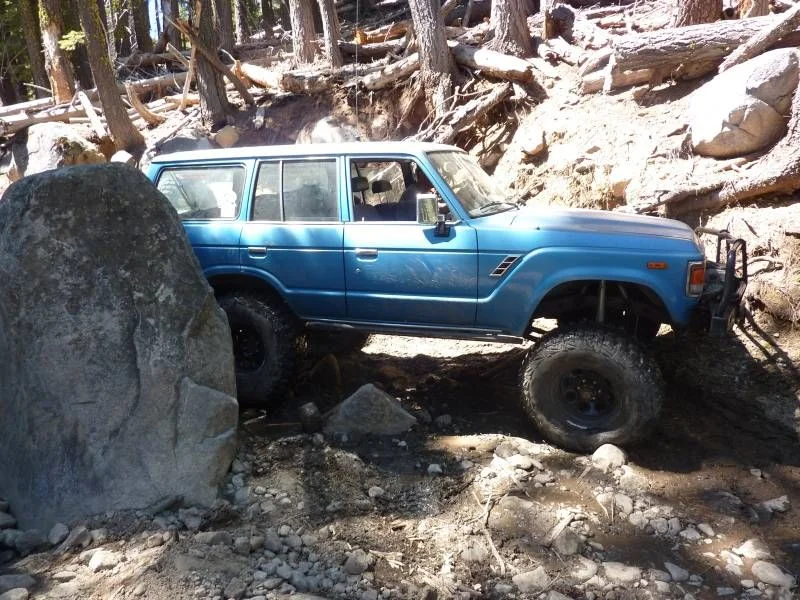

Thank you! It did the job it was built for last week. I was very happy with all but a few tiny details-like tire rubbing on the slider a bit. Other than that, it was a good first outing.
Here's a pic in Big Sluice taken and posted by Vette60:
attachment.php
And another posted publicly already by KCOWYO:
