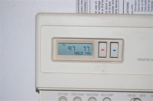

My thermometer in my LX has been saying 120+ when I get in after it sits parked for a while. Here's my thermostat in my house Friday when I got home:
