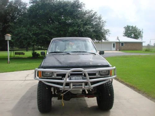

I know yours is lower, I had to cut out a good section of my grill to clear my winch. Can't find a picture of it but I cut out the botom chrome bar, then black slats, and only have an inch or so before I would have to start trimming the second horisontal bar.
Edit: found the picture, not quite as close to the second bar as I am rembering.
