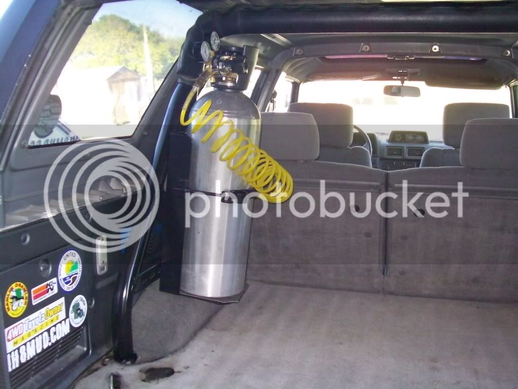

Made a few mods to the interior, Welded in some brackets to the roll bar on both side. On the drivers side it will hold the CO2 tank, The top of the roll bar helps protect the valve.
