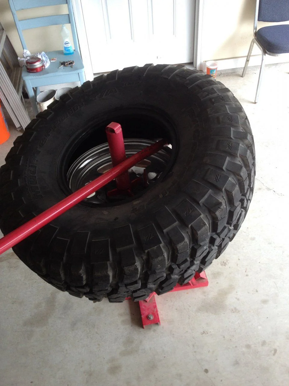

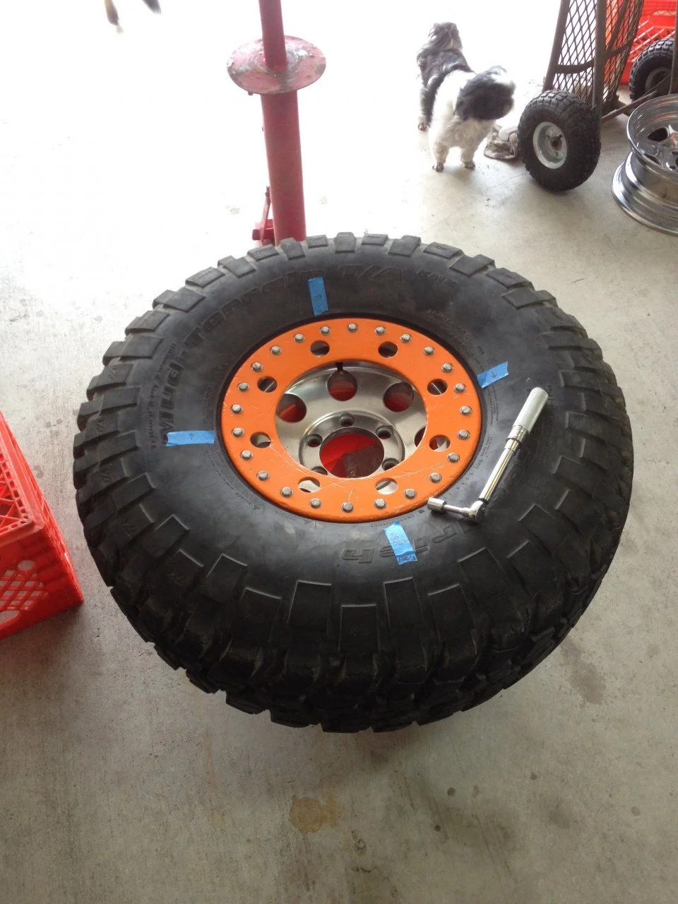

image.webp Getting a little more done . Checking the front/rear axles before making a long trip. Also putting the Harbor Freight manual tire machine to work :)
Mounted some 15x8 Champion Beadlocks under the carport

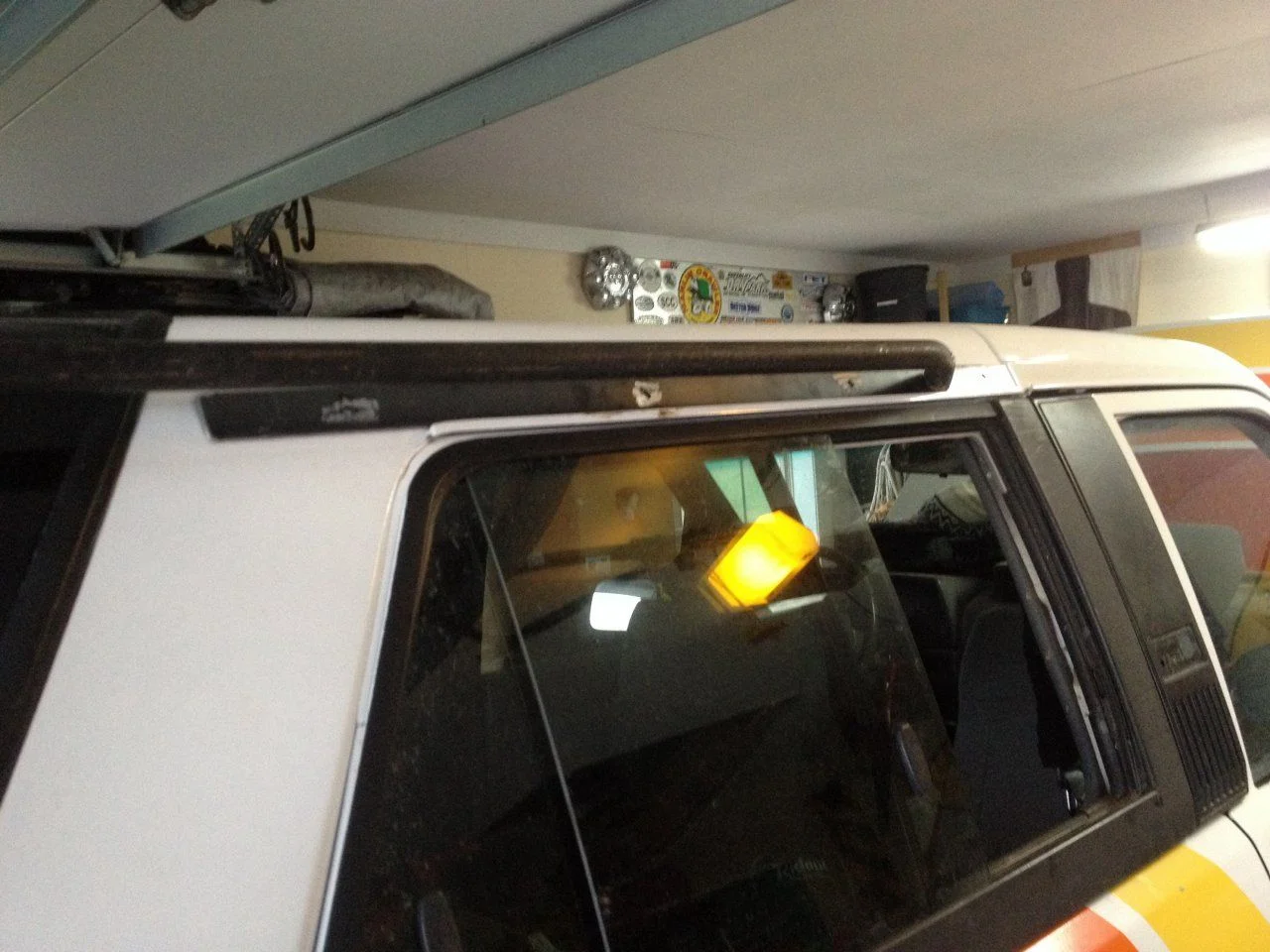

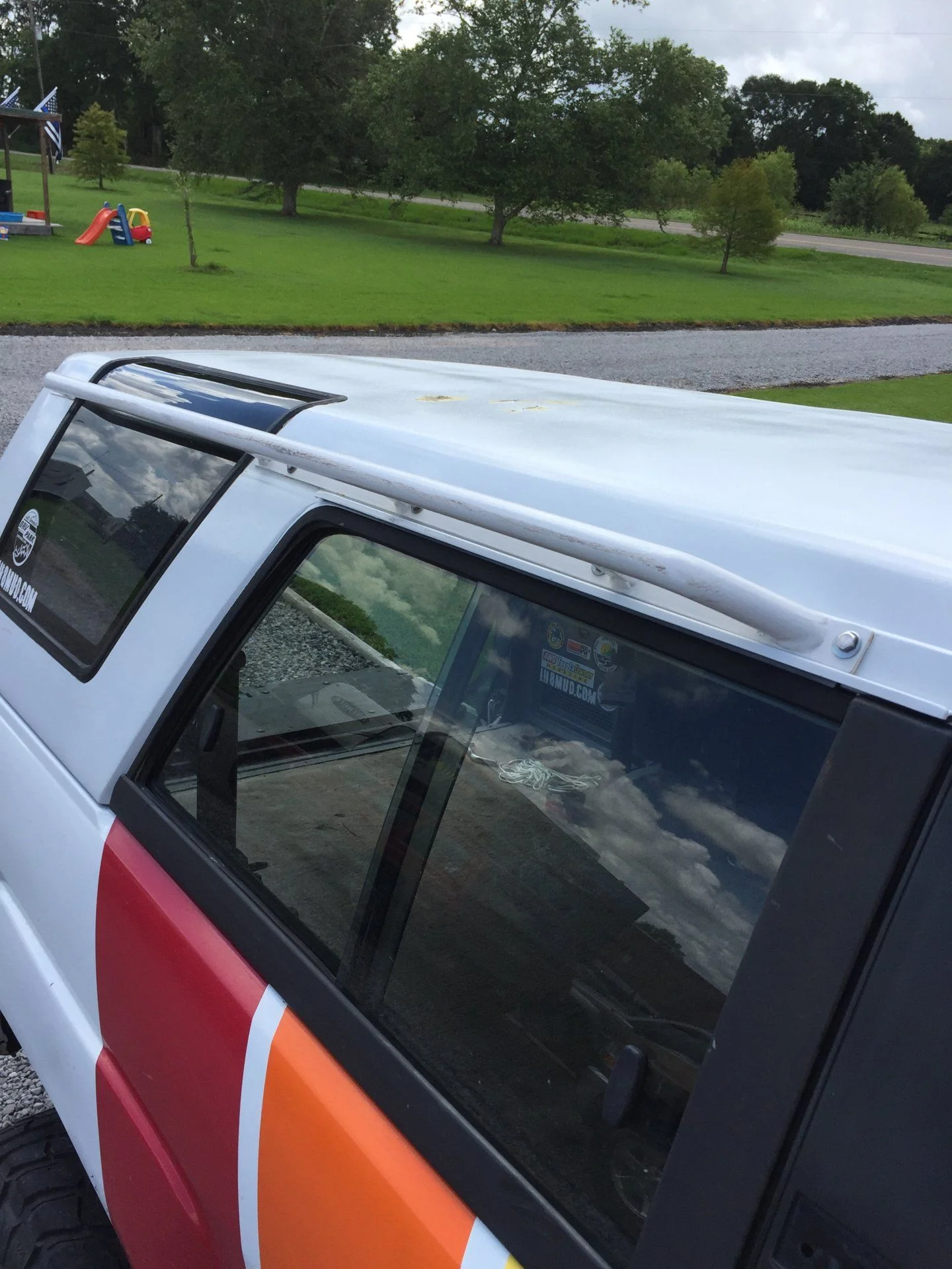

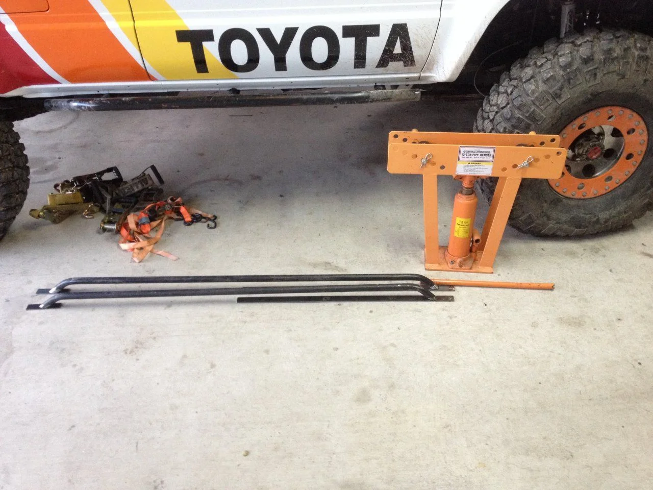

After getting a little to close to the trees at SuperLift ORV park again I'm going to give a try at some roof sliders and see how the work out for hopefully saving glass on my hard top. This is the rough draft, still have to build the short spacer/ reinforcement that will fit between the round pipe and flat stock.
Here is the start
Beautiful. What are the specs on the tube?
Using 3/4" black pipe (water pipe) from Home Depoit. Since I'm not " running into" the trees just rubing / sliding against them it should work as planed. Goal was keep the weight up high light for trails yet still have protection.
Sounds good. Just wondering how thick you went. I think it's a great idea. May copy it someday if you don't mind.
The roof slider should also give me a place to attach tarp as a "poor boy canopy" :) image.webp
If it works out Ryan it's all yours to copy ( let's just make sure it works 1st)
How well did the wheels and tires balance out with the beads?
The Champion Beadlocks balanced out really good I used air soft BB's , I used Josh's recipe for the amount to add AirSoft BB Tire Balancing - TTORA Forum . We rode a little over 400 miles in Utah and a little over 200 on the last camping trip with you and Davin with no death wobble or weird looking wear in the tires that I can see.
According to my research, using more than the recommended amount per tire doesn't hurt anything. So if I bought 4 - 2000 count packs of BB's, I'd be right on at 8.46 oz each.

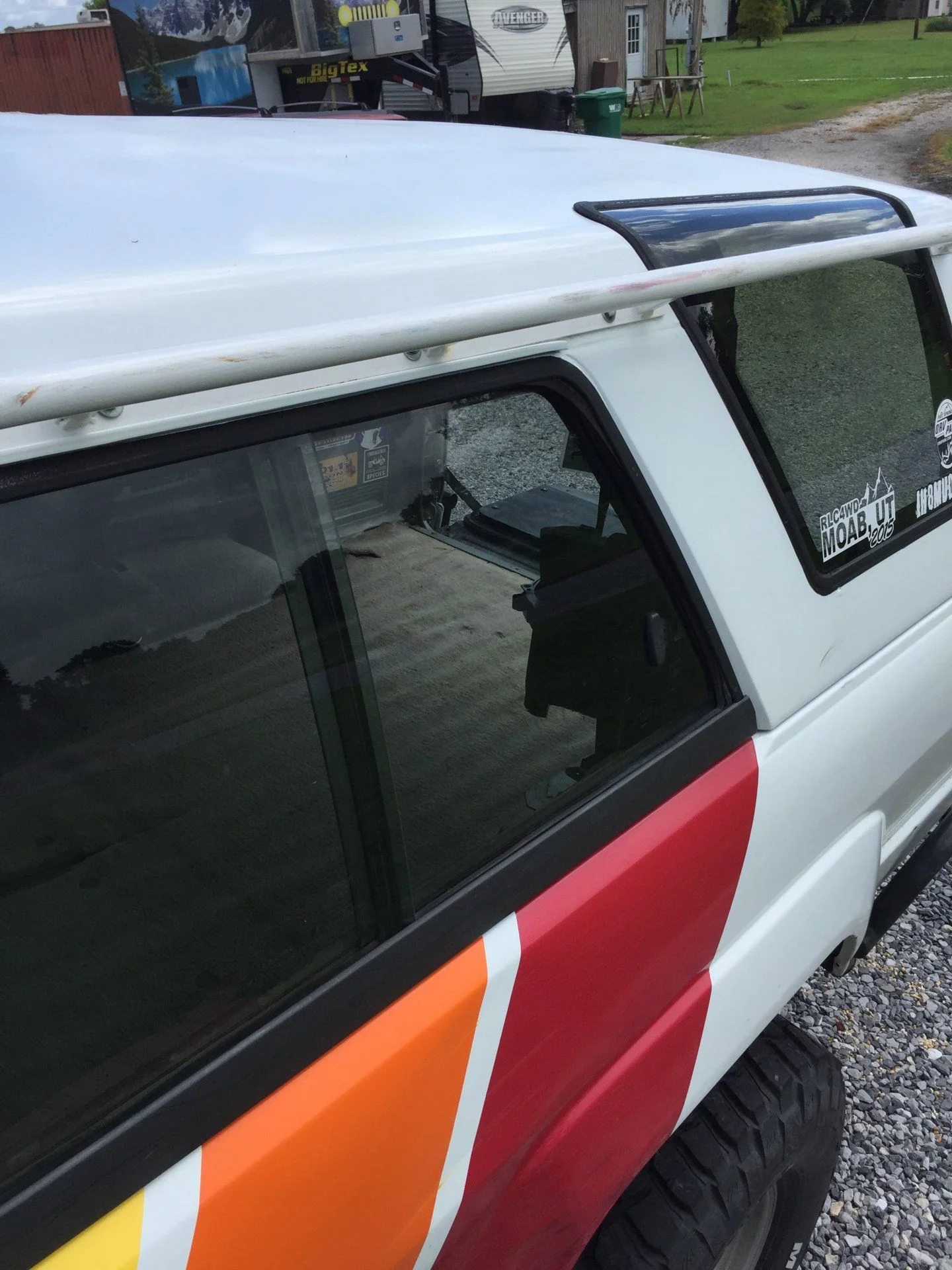

I little update to the build thread. Roof sliders worked out great !
