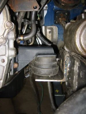

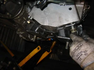

andre dieselcruiserhead helped me with the mounts. we got these in place, and they look great. we added a small gusset on the frame pads for extra strength.
using the stock crossmember, in stock location, dropped about 1.25 inches. the adapter has a different hole pattern, presumably for a trans mount from a fj60. I found one of these unique style of these that fits the fj62 crossmember flat bottom, and a fj60 upper v shaped. it still did not fit, it was like a half a hole off, and no extra material for custom fitting. I question if one set of holes are off - the adapter or the mount.
So, with modification required regardless, I used the fj62 mount, and welded a strap to this to mount about 1 inch farther back.

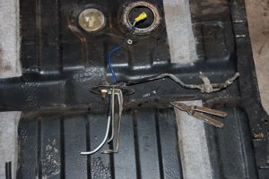

3. fuel line - I used the hard steel lines already in place, and added a crimped on fitting to the isuzu banjo fitting. i also removed the fuel pump in the tank. i added a inline fuel pump, i will add other photos of this. I only have the one isuzu fuel filter inline at the moment.

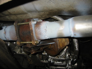

isuzu diesel in 88tlc - exhaust system
Andre and i work in a shop that is in Heber Utah, that's pronounced Heeber. It is a small town with a couple parts shops, a couple auto body shops, and one real muffler shop.
I gave this guy the shot to install the exhaust system. since i got this engine already pulled from the truck, i had no parts but the flange, and the exhaust brake.
he used 2.5 inch exhaust pipe, and a good welded diesel muffler. normal steel. all isolated hangers.
he added the jake brake just before the muffler, I still need the magnetic valve that controls the vacuum to the physical valve. this valve took 3 months of cooking in the sauce before it would bust loose. It works smoothly now , I hope it will last. how cool to have a jake brake on a landcruiser?!

Engine mounts - the vibration should still be dampened through the mounts, right? i used the ford, fluid filled mounts.

What mounts do you have on the other end of the drivetrain?
My vehicle uses 3" round by 1.5" thick industrial rubber isolators for engine mounts and they work very well. They're mounted at 60 deg (30 deg off vertical) which is similar to the geometry Isuzu use in their truck engine mounts.
At idle the engine vibrates about 10mm on it's mounts and doesn't rattle the rest of the vehicle much at all.
I'm not a fan of flat engine mounts. Rubber absorbs vibration best in shear, not the vertical compression/extension that it's put under when mounts are flat like that.

i dont know about the vibes,,, mine is really smooth. but i used the stock isuzu motor mounts which are at shear like dougal mentions, maybe it really does help?

I also agree that the mounts should be in shear, and should do a better job of isolating. trans mount is original fj62 mount.
