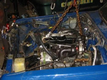

Diesel Train for the FJ62
another few pictures of the Diesel Train!
4bd1T -IDS - 4L60 - AA - TLC splitcase transfer case.
some details I would love some input on.
dieseltrain in the FJ62
we slid the whole thing into the FJ62, and it really fits pretty good.
the rear crossmember looks like it can bolt into the same location saving some removal and remounting, and reusing the existing driveshafts.
the motor mounts will be fabbed up from scratch, using a ford mount shown.
plenty of room in the front of the engine.
good clearance on the starter, turbo is a little close to the brake assy but I think will be okay
the pan to pumpkin clearance is perhaps 3 or 4 inches. I have OME lift that I will install to help some of the clearance, but as it sits now without the engine weight on the frame it seems pretty good.
Same crossmemember, same driveshafts! Wow that is exciting.
Room in front for an intercooler?
Is the 62 on stock springs right now?
Great job, thanks for pioneering for us 62 guys. :bounce:
