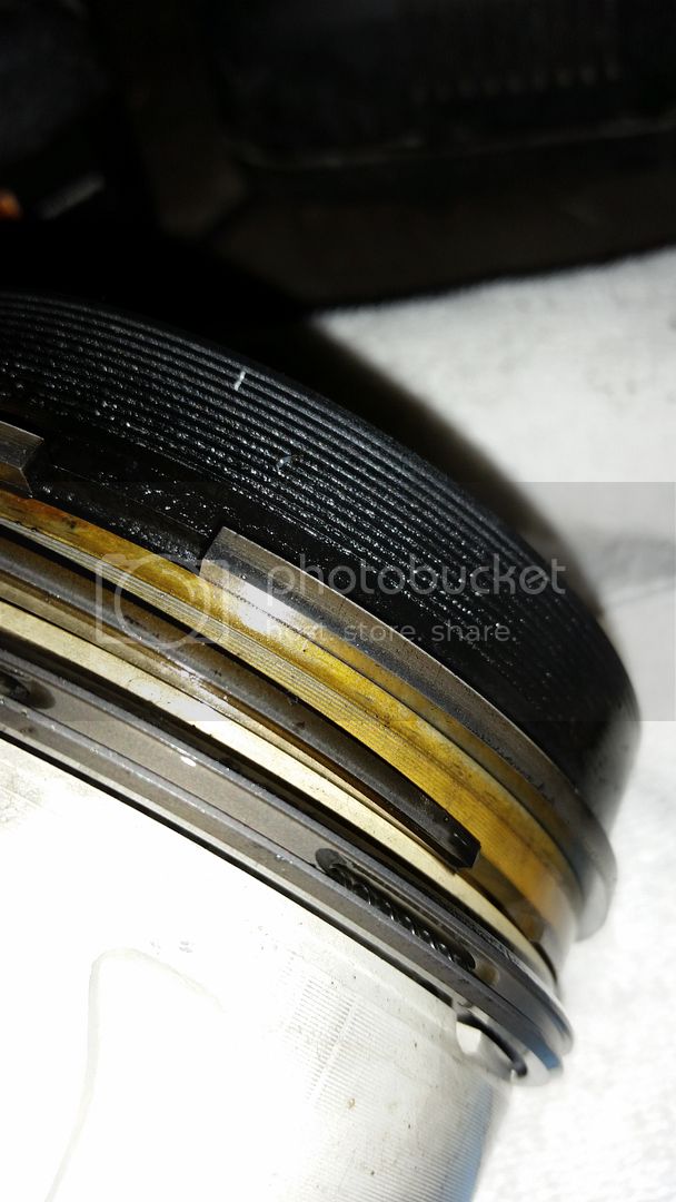

Ring's on pistons, no issues here. You can see on the compression ring where they have started to seat in.

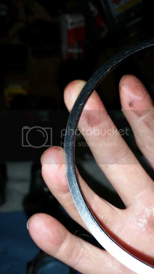

Chrome hardened face of the compression ring both sides.
Ring side (part that seats in) is not chrome hardened. Bad pic sorry.

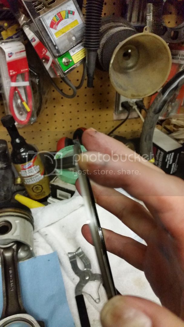

Ring in sleeve for measuring end gap. Ring seems to move fairly easily, deffinantly not what I would call hard to move. Slides nice and smooth once past the top area of soot is passed.

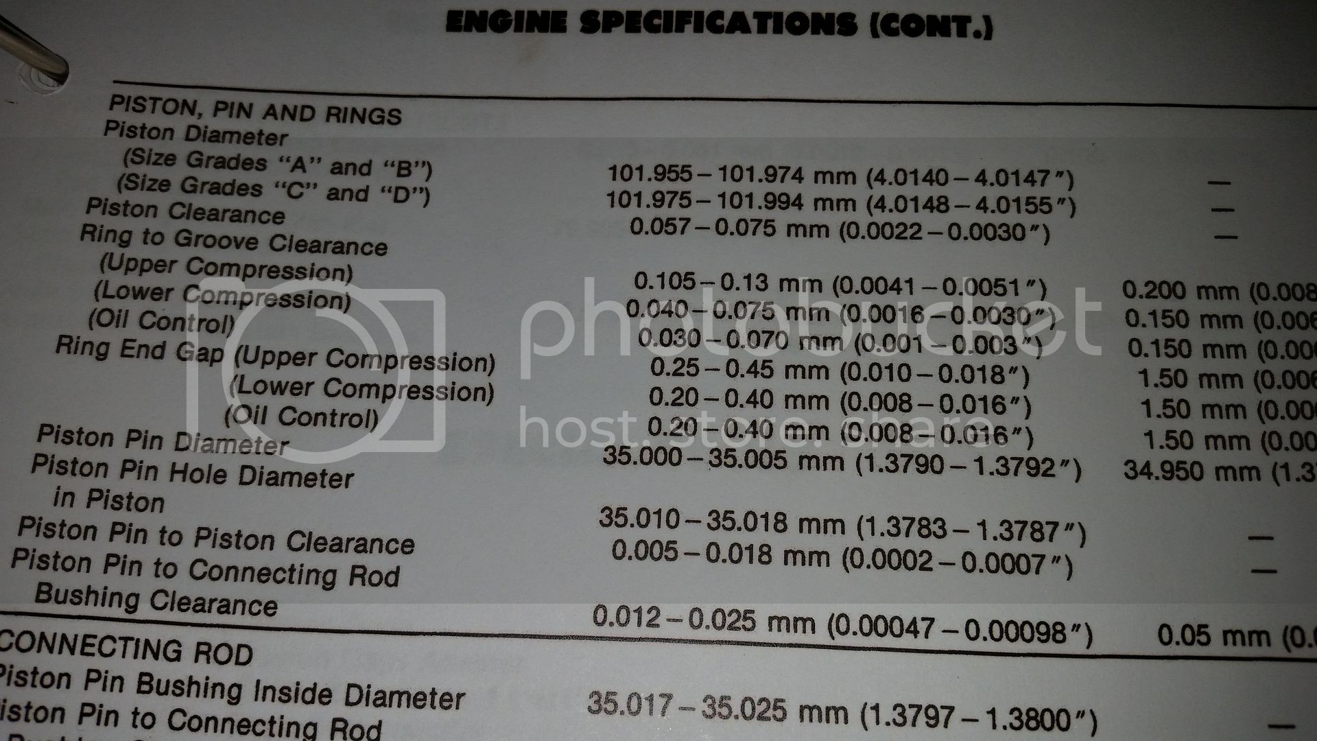

Ring gap is .33mm so right in the middle of spec. Spec is .25 to .44mm.
