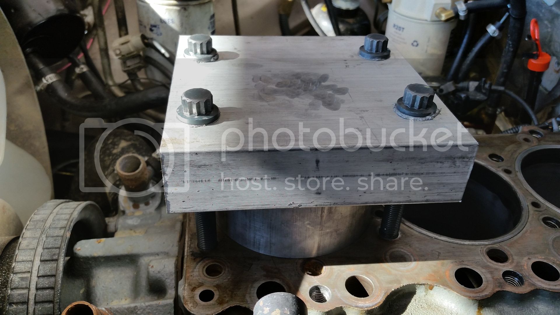

Well today I made a in engine press to try and move the sleeves into place. I did get them to more and they are now at the maximum allowable protrusion and the are all level other than #2 the part of it next too #1 is still off a bit if I take a machines straight edge and lay it from 1-3 I can fit a .005mm feeler through. I don't think I can get it any closer than it is with out a full tear down and paying a specialist to do the sleeves.

Here is my press, on e I have the bolts torqued to 100ft/lbs I then give it a few good smackes with a 3lb sledge.
How satisfying was the banging on the top of the press plate. Did you gain any extra?
Because of the liners are grabbing further down the bores the spring in the liner may push the top lip up a little. The shock from tapping them down could settle them.

Honestly it was about the best feeling since the birth of my son. I was having a hard time restraining taking the sledge to the rest of my truck.
Do you have an electric block heater? If yes, warm up the block and a bigger BFH may do the trick.
Nice tool you made.

Unfortunately I do not. Good idea.
