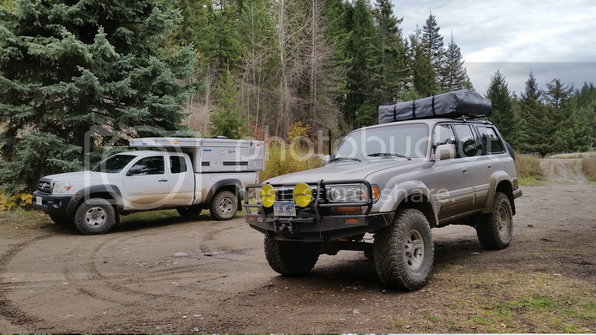

We left at about 11:30am on Sunday myself and my buddy Dave in his Tacoma to drive to Penticton to pick up a ARB Roof top tent, awning and vestibule room setup. Having not driven the truck consistently and for no more than 40kms at a time. This was going to be a test, 390kms one way and two mountain ranges to pass over. The main one was the coke (if you watch Highway through hell you will know it). It goes from almost sea level to I think 1600m in 30kms with one final Hill at the end then claims a lot of cars mainly by fire. I was able to make it up with out dropping below 75kms/hr in 3gear and the converter locked. Trans temp did not go over 145f. It felt laboured but not like it was walking up. My boost was maxed out at 14psi and EGT's maxed at 1300f after about 10min. Coolant temp stayed steady and the stock gauge did not budge.

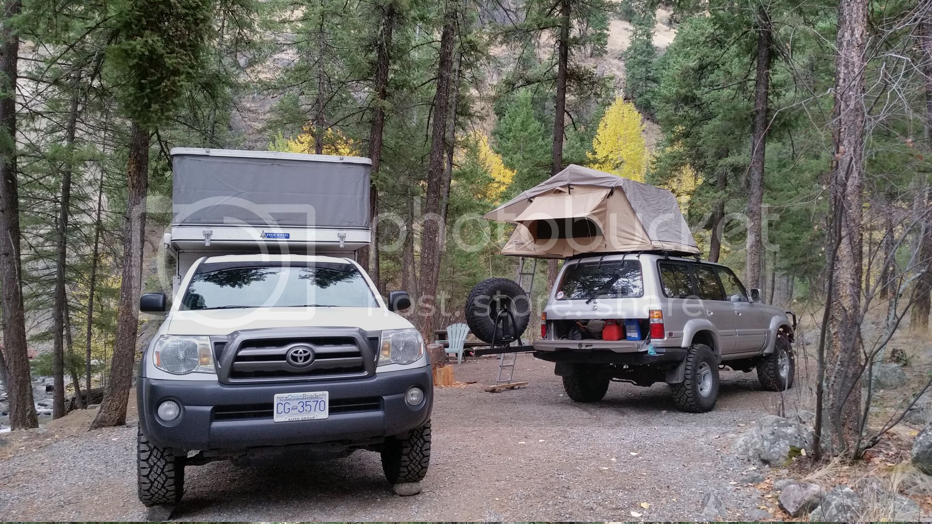

The rest of the trip there went off with out a hitch. We got the place I was getting the tent from at 4:30 loaded it up and pulled out at 6:30pm headed toward the Ashnola valley. We planed to camp somewhere in the area and having never been there we where unsure where to camp. We drove on gravel for 20ish kns and found a spot in the dark that looked decent. Set up camp and the new roof top tent (always need to test the new camp gear!). Then relaxed in front of the fire till 11:30pm. Clear night and a fantastic view of the stars.

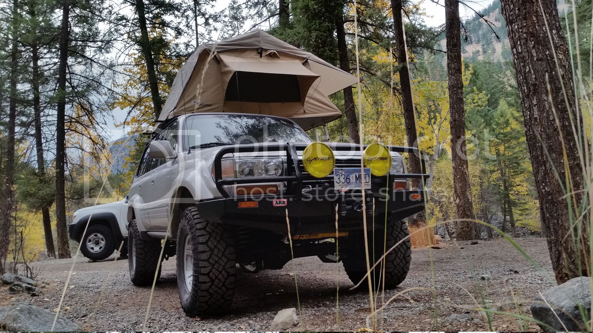

Camp
Trail sign

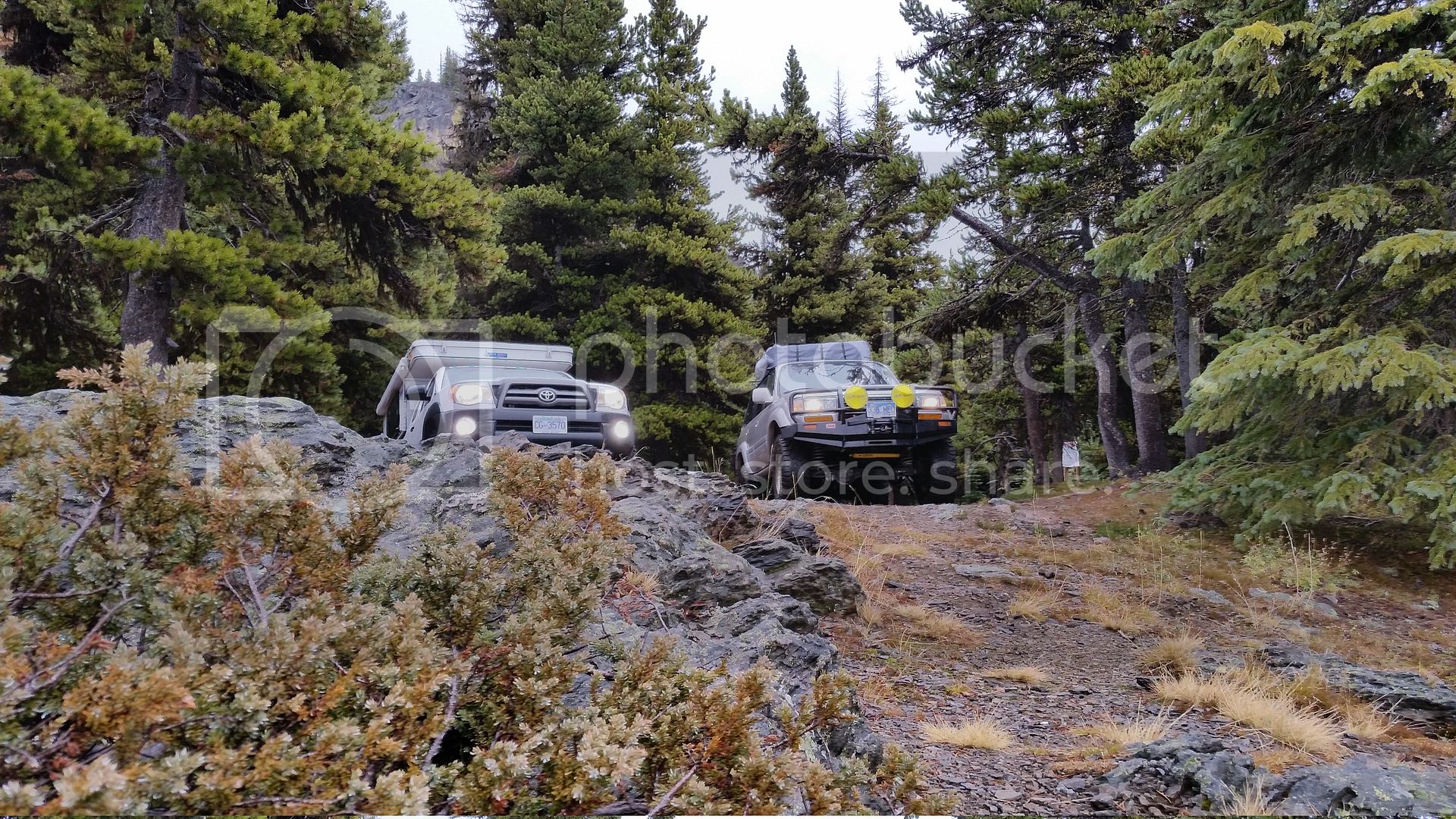

3 point turns required

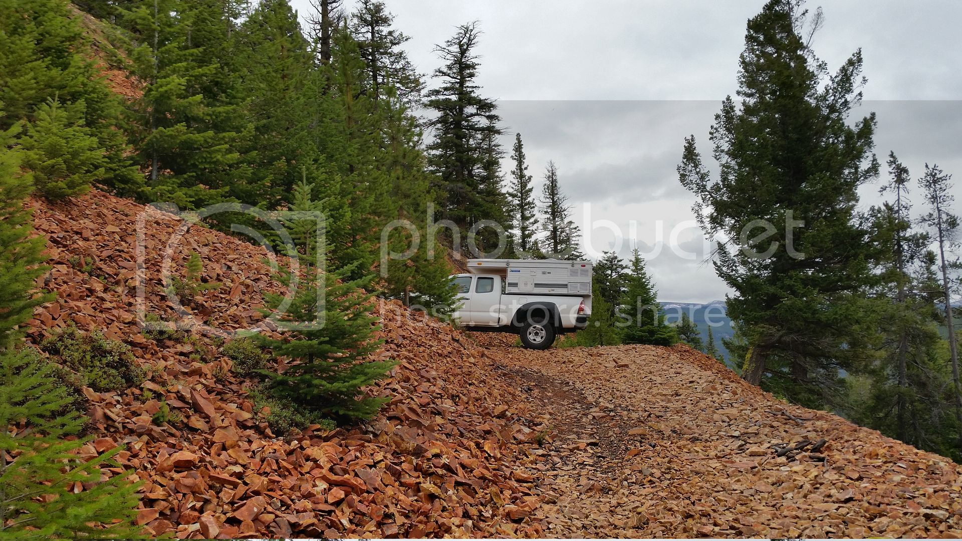

Today we pulled out at 10:30 and headed for a trail we had heard about that took us from Ashnola over Placer mountain to Manning Park area. It's about 100ish km and parts of it are little more than a goat trail on the side of a shale Hillside. Found some great scenery and amazing spots to camp on future trips to the area. We even encounter a snow shower at 7200ft.
I would post pictures but this POS app taptalk will not allow me to exit to grab the pictures with out deleting my posts. Made it home fine millage was good at 13.3l/100kms. Need to make a few changes and adjustments. Also need to get a turbo on it that actually performs.
