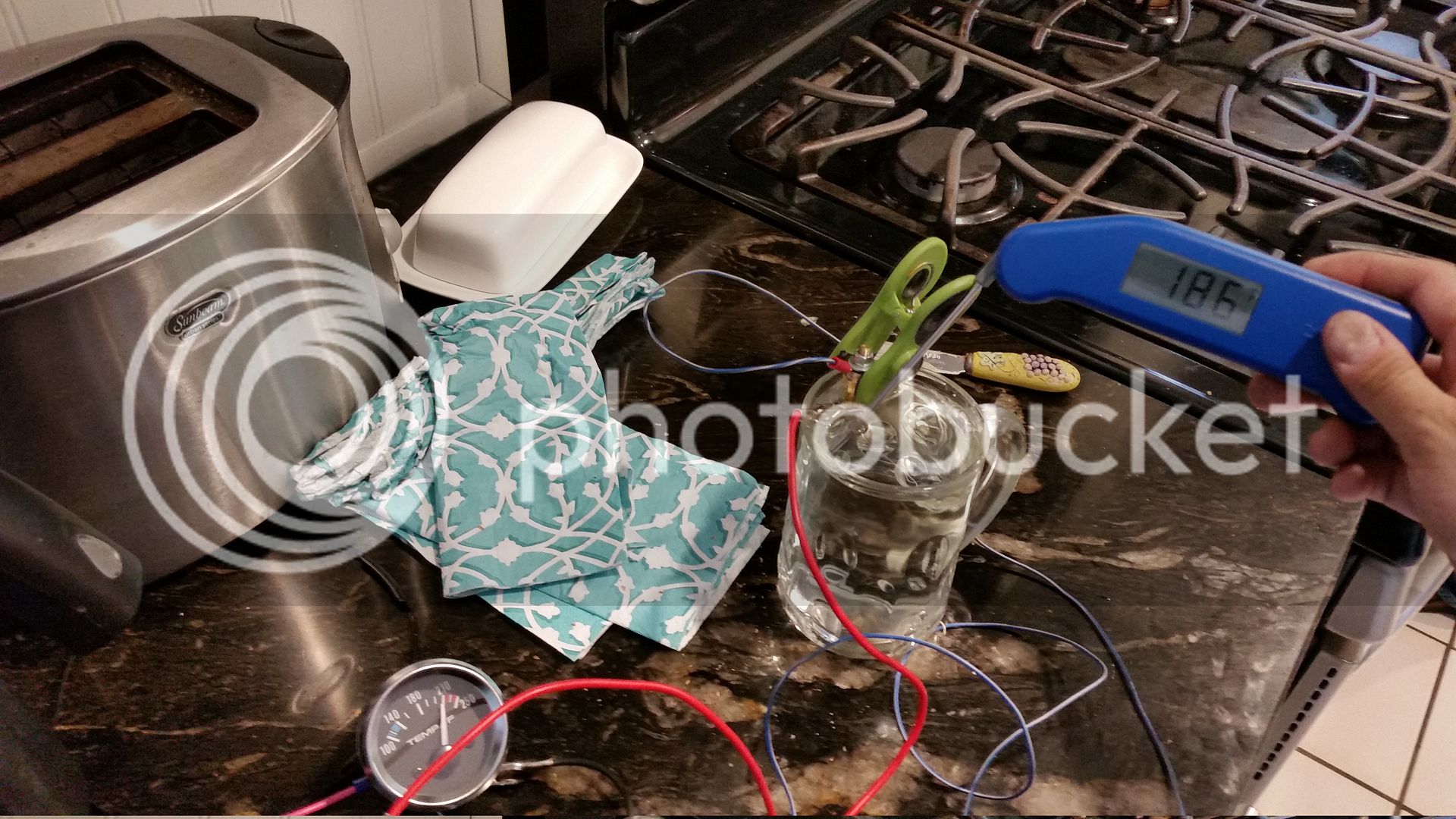

So today there was no work for me so I had a bonus day to work on the truck. I got a lower rad hose that seems to fit better and give me more clearance. I then got a sheet of aluminum to re make the fan shroud minis all the duct tape. Got that done and then started looking at my fans, or more so the clutches. The Toyota clutch is shot the valve that is moved my the thermal spring is sized (tested with a heat gun). So for now I put the locked Isuzu clutch on. I think zi am going to try and find a new Isuzu clutch to replace this one. It seems to fit my shroud better is 1" larger than the Toyota fan and it's easier to get on and off. Anyone know of a good source to get decent fan clutches? Would prefer a name brand an not an eBay special.
Anyways once that was all on I tested my cheap temp gauge and sure enough........
It's was 18-25f off all the way from 150 to 220f that I tested it. So it did not go back in. I'm going to rely on my IR gun and stock gauge for now.
No test drive today since it was rush hour when I got it all bleed. It took much longer today to get up to temp not sure if it's a placebo or if the new rad really is that much better.
