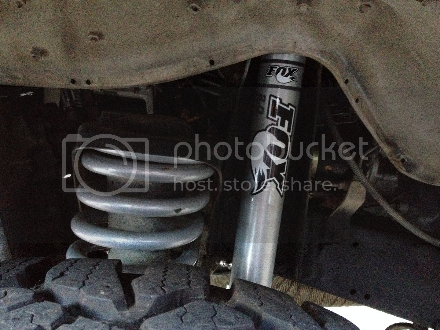

The slee springs and Fox shocks look good together. The valving of the fox shocks so far seem to be good with the springs. I am still about 300lbs light (no front bumper, winch, dual battery and rear drawers).

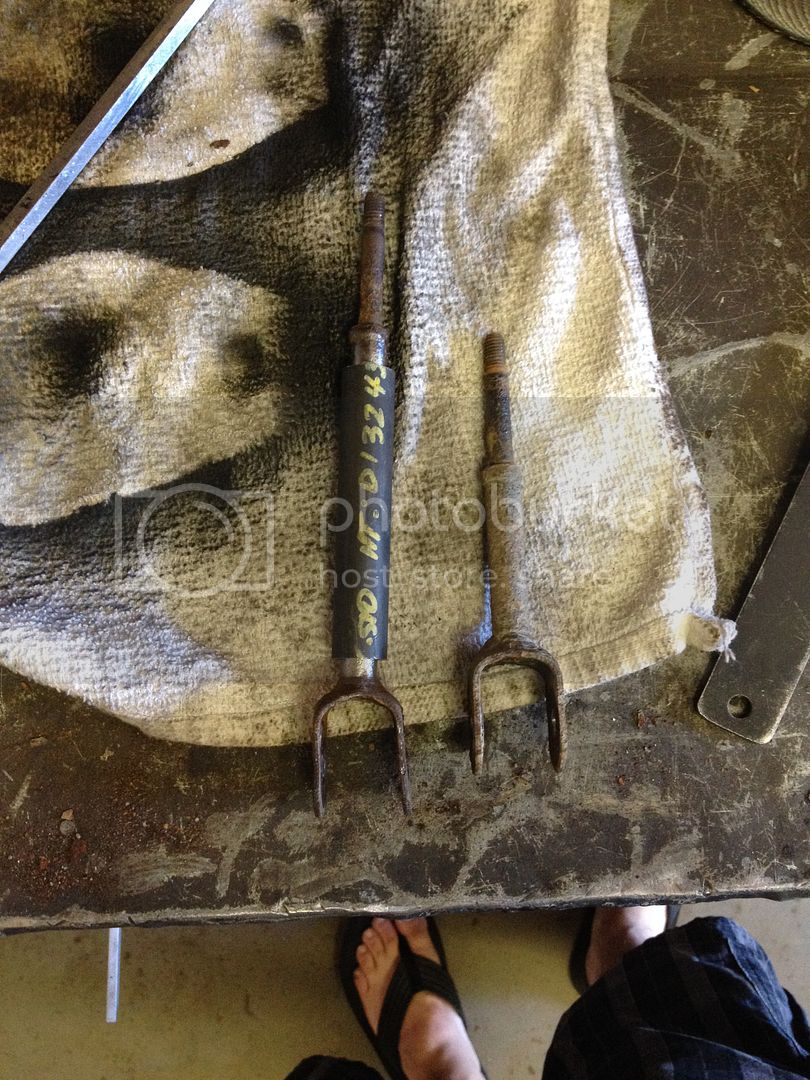

I also extended my rear sway bar links last night with a 4" section of DOM. Overall the links are 2.75-3"longer than stock.
In the front I plan to use blocks to space the whole bar down.

What are you running for suspension? Are those pin mount Fox 2.0s? Mine has bagged Bilsteins and worn out OME springs. I need to do something about the suspension. I was thinking of going for F-O-A 2.0s, 10", and maybe messing with the bottom mount to turn it into a pin mount, but messing with valving forever is not my idea of a good time.
Looking good! I can't believe you went for the crawler gears, this this is going to crawl like a dozer. The big 4 cyl diesel and auto combo is unbelievable. I have never wanted lower gears, there is just so much grunt.
Disregard the questions about suspension. I did a little searching and found everything I need to know. This is exactly what I would like to do to mine in the next year. I am really looking forward to your impressions of this combo, it's the same price as a 2.0 FOA remote reservoir shock but with bushing mounts that should last a lot longer in our climate...
