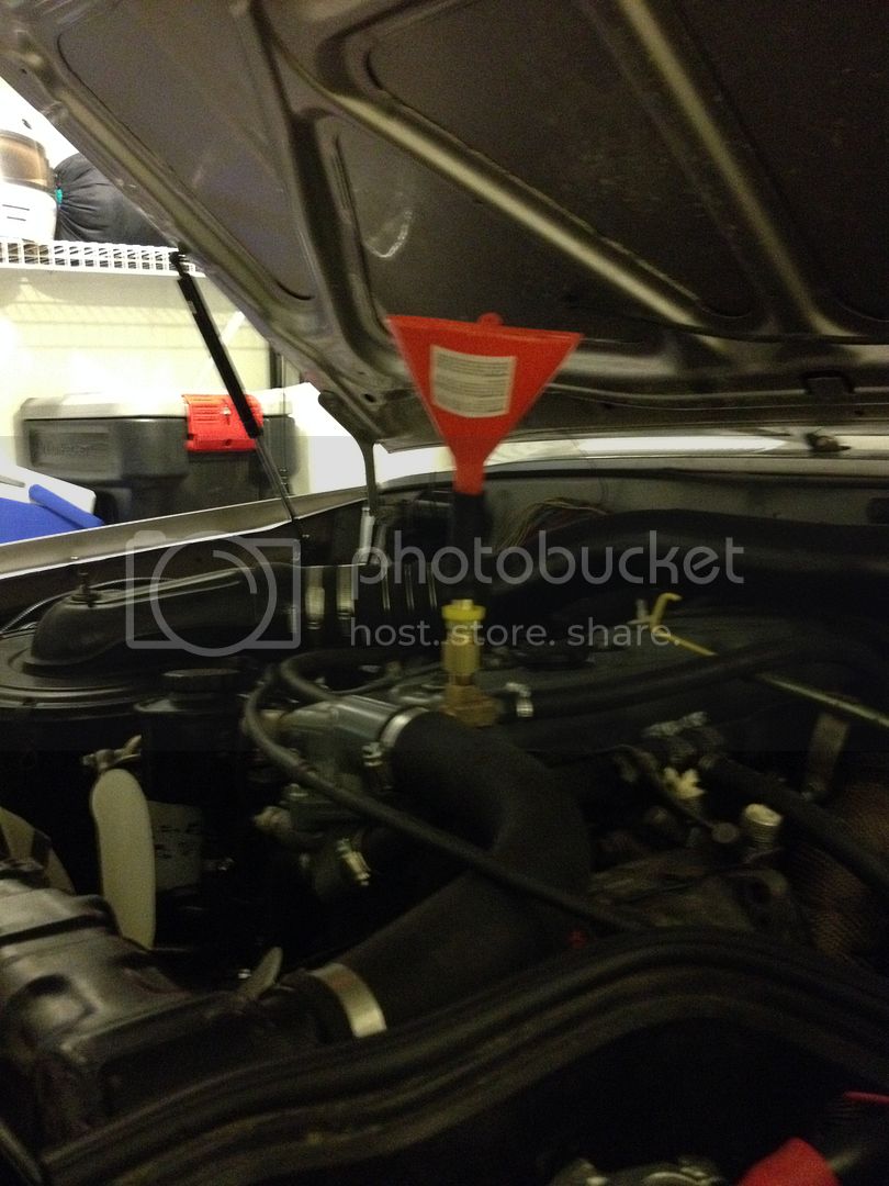

Around town no problem noted in over 30-40min driving sub 80km/hr. But as soon as I hit the hwy cruising at 2000rpm flat or slightly up hill the temp starts to climb rapidly.

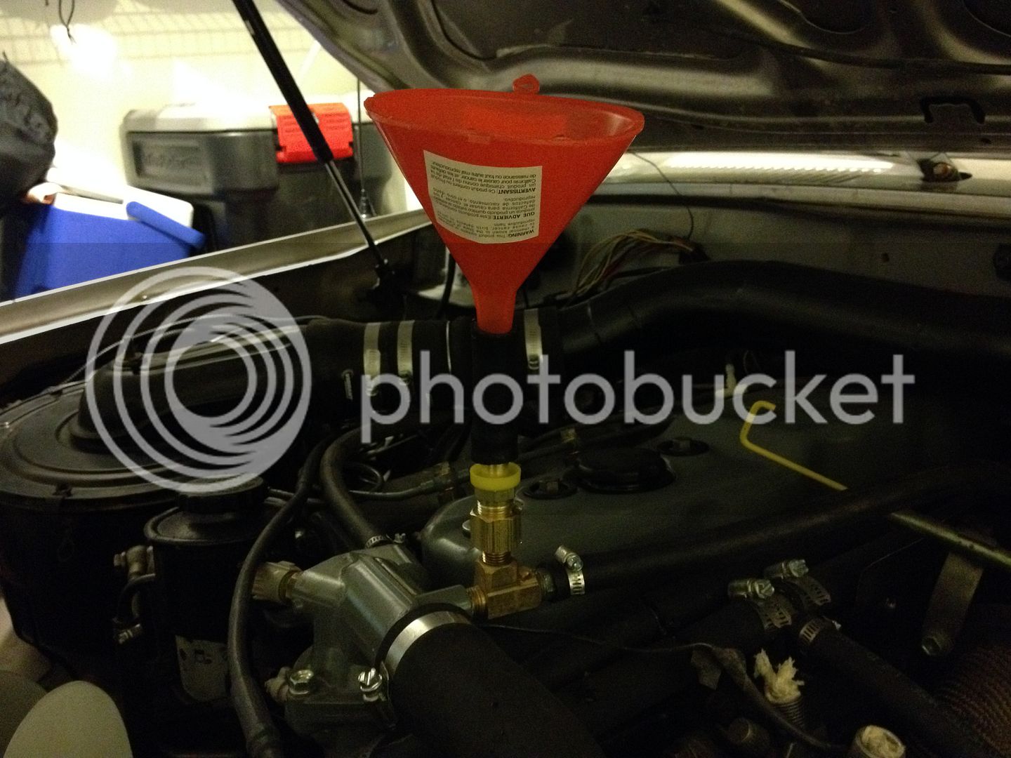

My t stat housing is about 3" above the rad cap. I did put a bleeder up there the issue is getting water into it, I can let air out but getting water up there is a challenge. I will try the 60/62 trick and make some blocks to drive up. I have one of those long funnels.
When I have stopped after the hot running I have checked the rad and its supper hot so I have coolant flowing its just not cooling or the airlock is preventing it from moving any water through it. The fan even when the rad is belting heat off it is not locked and it has zero resistance. So even at hwy speeds it should be engaged if its got that kind of heat hitting it. My truck does have a lot on the front an ARB, winch an 240blitz Lightforce lights. So at hwy speeds there it a lot of air flow obstructions.
Tomorrow I will try the bleeding trick and see if I can get this air out.

Yep I have one of those but this pocket is kind of a strange spot there is no easy path for the air to get out even with the prestone flush fitting. Its a good idea though, and I have used it a few times. May use it again depending how tonight works out.

I was able to get another liter of water in then started and ran it for 45min till the t stat opened. The thermostat defiantly works when it opened the rad got hot with in 20sec so there is good flow. No further air came out after it opened. I also have no bubbles as its running and revving so I am hopeful it was just an air bubble and not a bad head/HG.
I lost the plug when i was putting it back in so just left the funnel setup and filled it with water to keep the system from sucking in air as it cools.

Yeah I'm fairly positive its air in the system. With the stock engine and the same bumper winch light combo it was fine up the steepest grades. This new bleeder should do the trick after a good 10min of squeezing the upper rad hose I seemed to have been able to get all the air out. I then ran it for 35-40min to get the thermostat open and no more air or bubbles came out at all after the initial bleeding. The fan is something I will look into later as I want it working for slow off road. I have a shroud 50% done for it at well.

Mine runs a line from the side of the top tstat housing to a straw to the bottom of the radiator surge tank. This does a good job of purging air by itself but requires a surge tank with a pressure cap on it.

Hey hey now I make the wheels square ;). This SST actually only cost me about $5 and works great. Its also a fantastic water launcher when you turn off the engine with the funnel full :P
