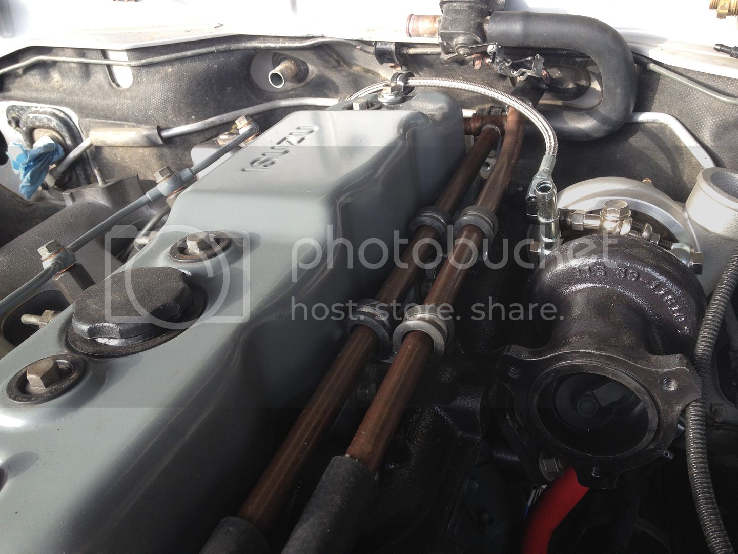

I then moved onto heater hoses. I was able to get them all made with the help of some copper plumbing and a few 90* molded rubber bends. I have not hooked up the rear heat for now, I am going to run the hoses for it bit cap them for the time being. I reversed the flow through the heater core as well since it made the plumbing much easier. I also was able to add an inlet for the 1500W circulating block heater. It takes to cold water out of the block drain and heats it then sends it up to the heater inlet line to the engine and heater core. It it works correctly I should have instant heat in the winter and a engine at almost operating temp.

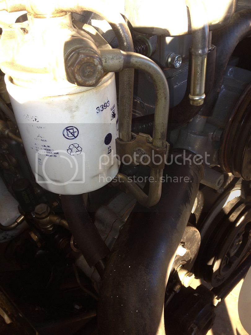

AC lines are going to be converted to AN fittings to make making the lines a breeze. Have not come up with the routing yet but I will get there when I have a chance.

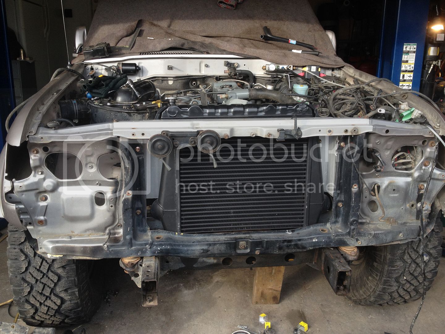

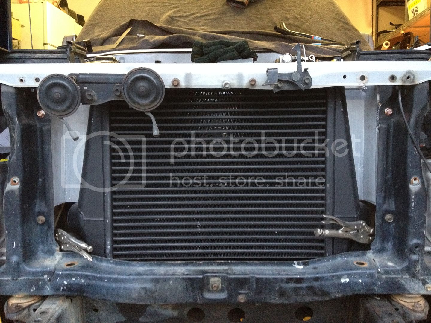

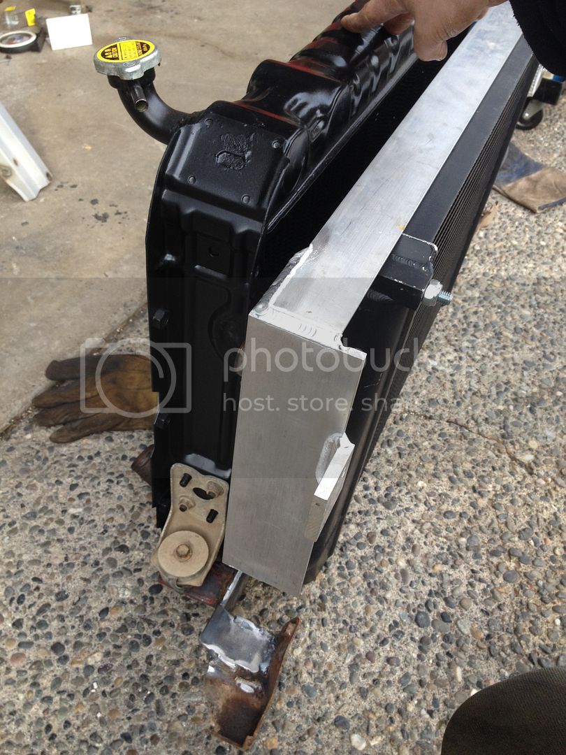

So this weekend was all intercooler/Rad mounting.

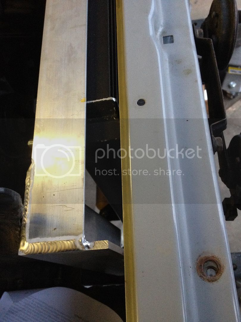

Intercooler top mounting.
This will also double as the top rad mount. The intercooler is hard mounted and the rad is insulated by stock rubber isolators.
Any air that goes around the intercooler is directed into the rad core.

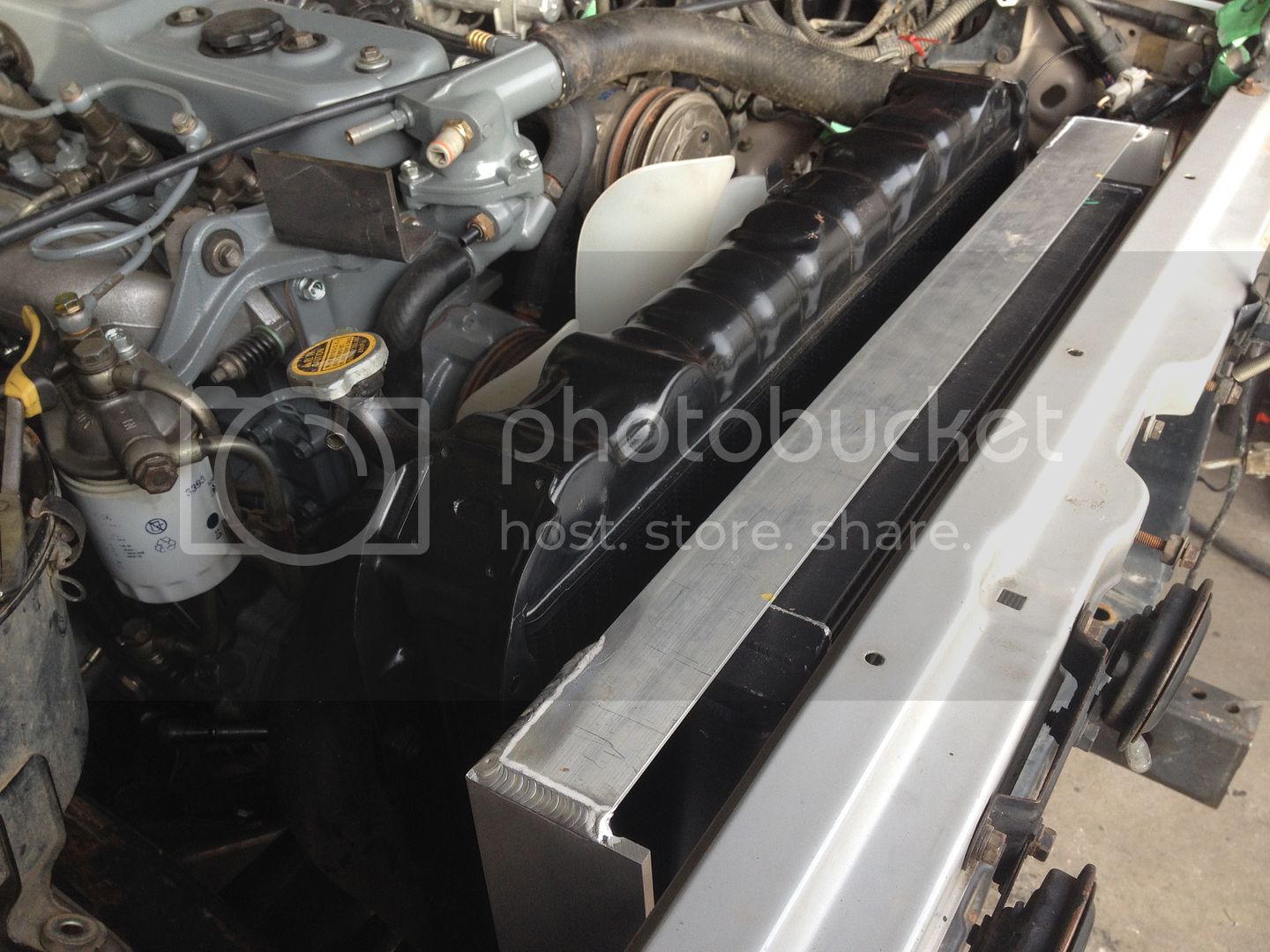

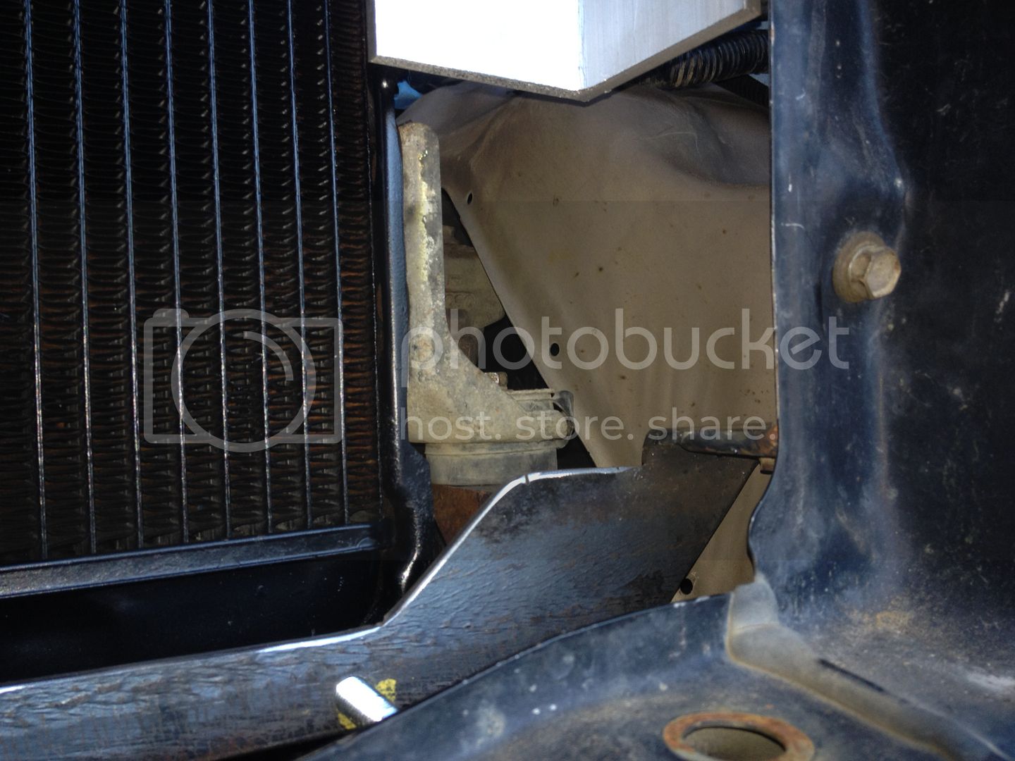

Upper rad support in.
The gap will be filled to prevent any air bypassing the coolers.
Another pic with upper support in.

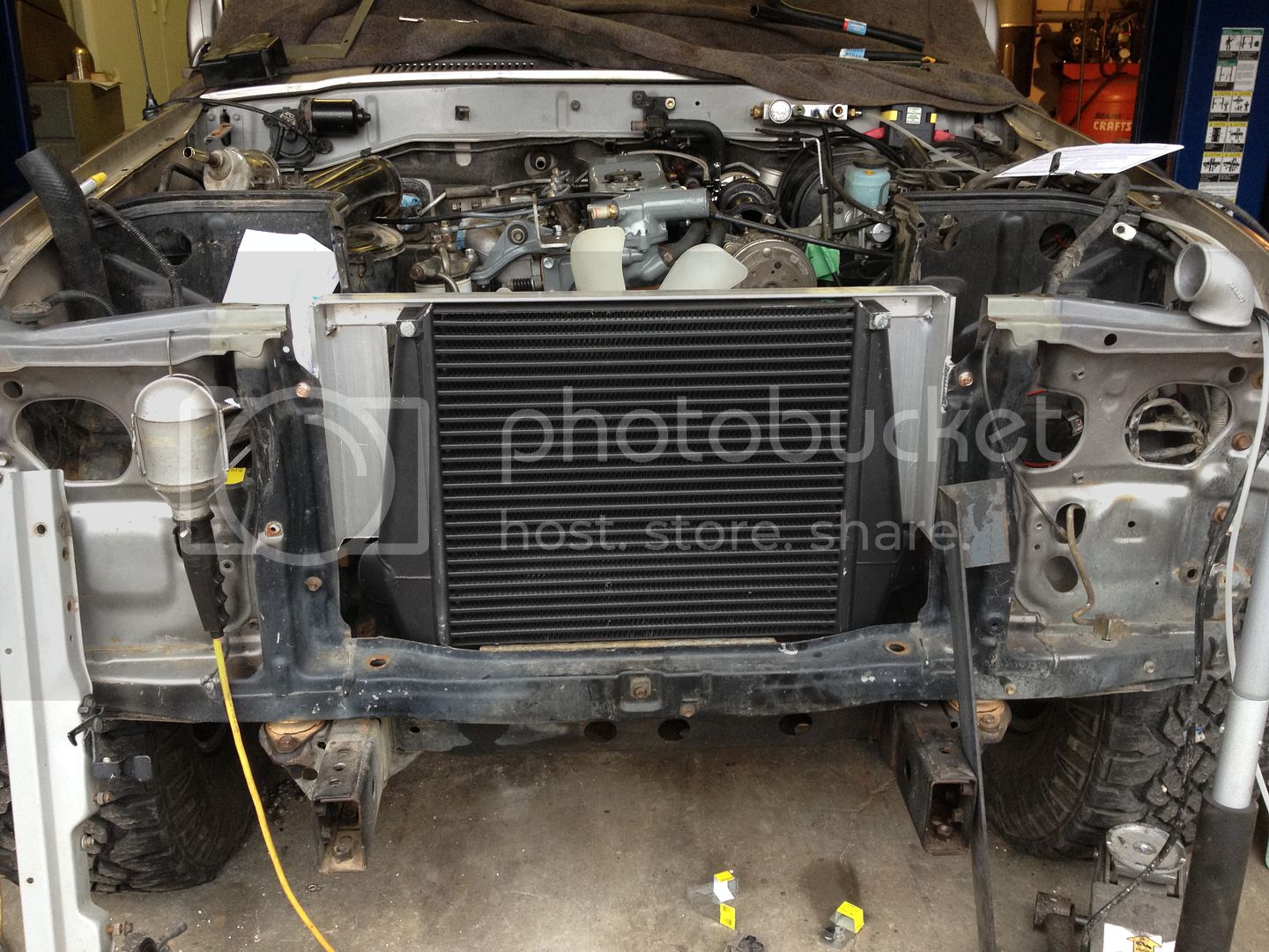

Rad in.

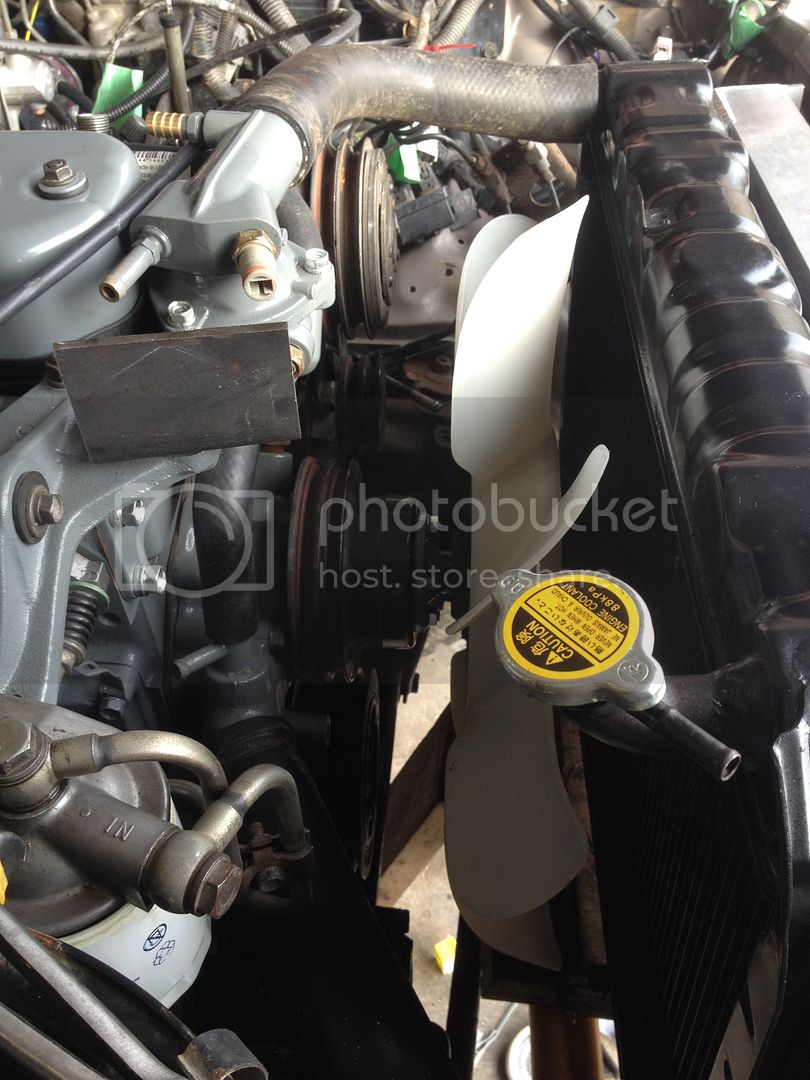

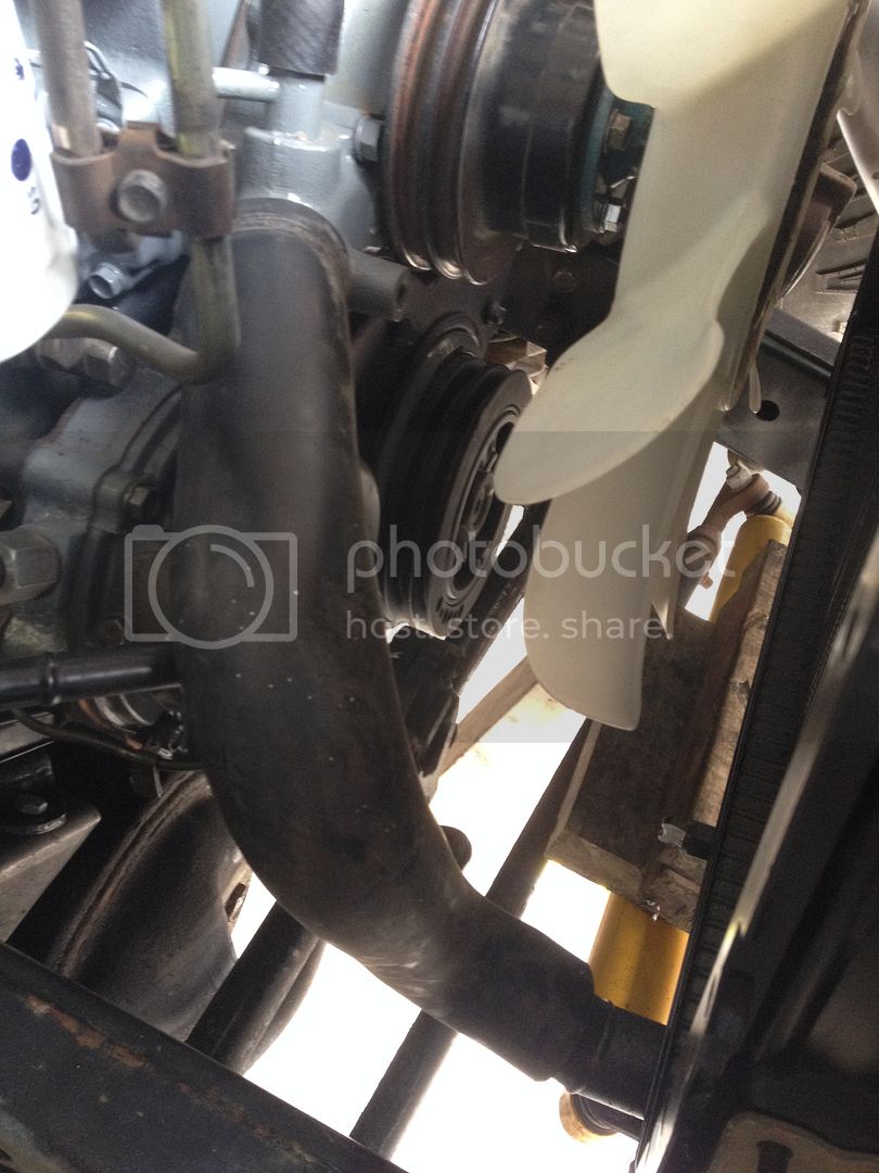

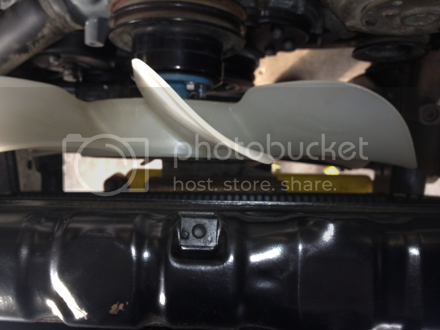

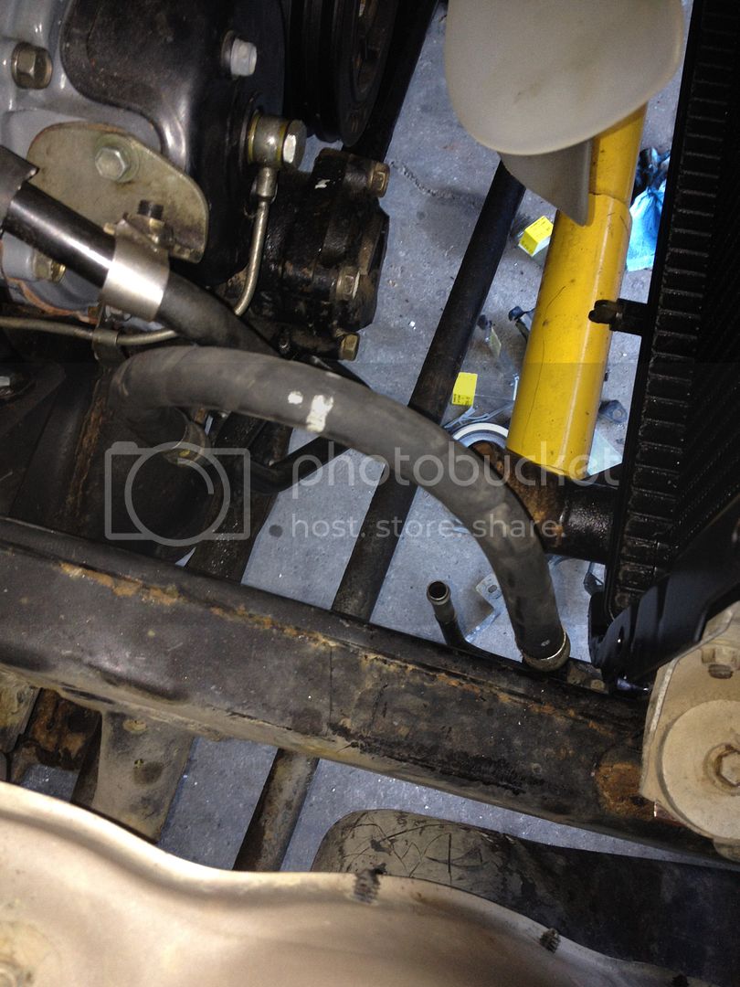

Rad hoses and fan.
Lower rad hose and you can see the clearance from Rad to fan.

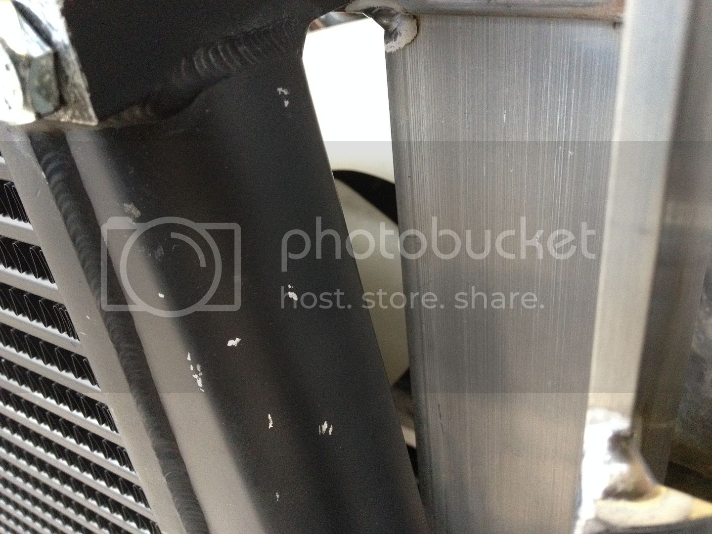

1" of clearance from fan to tank, with over 1.75" to core. Should be plenty.

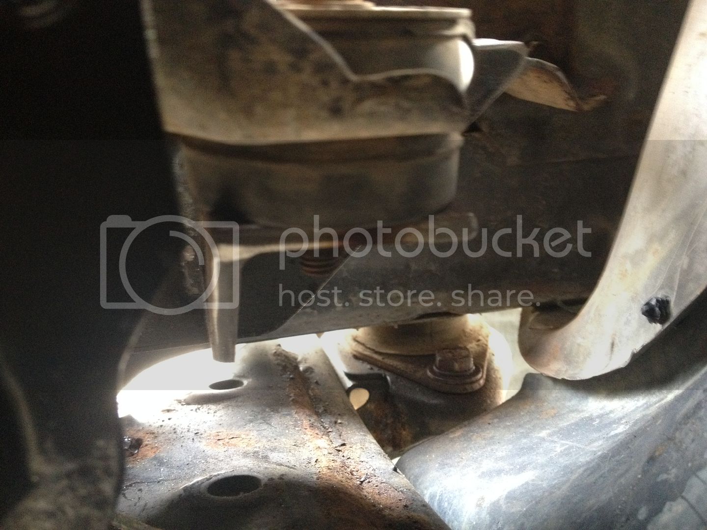

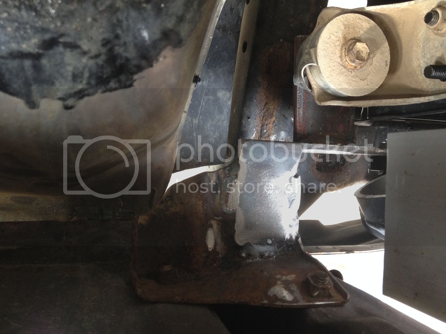

Lower rad support and intercooler, both off the same mount.
Lower rad mount, can see the retained rubber isolator.
Nice part is they come out as a unit after removing 6 bolts.

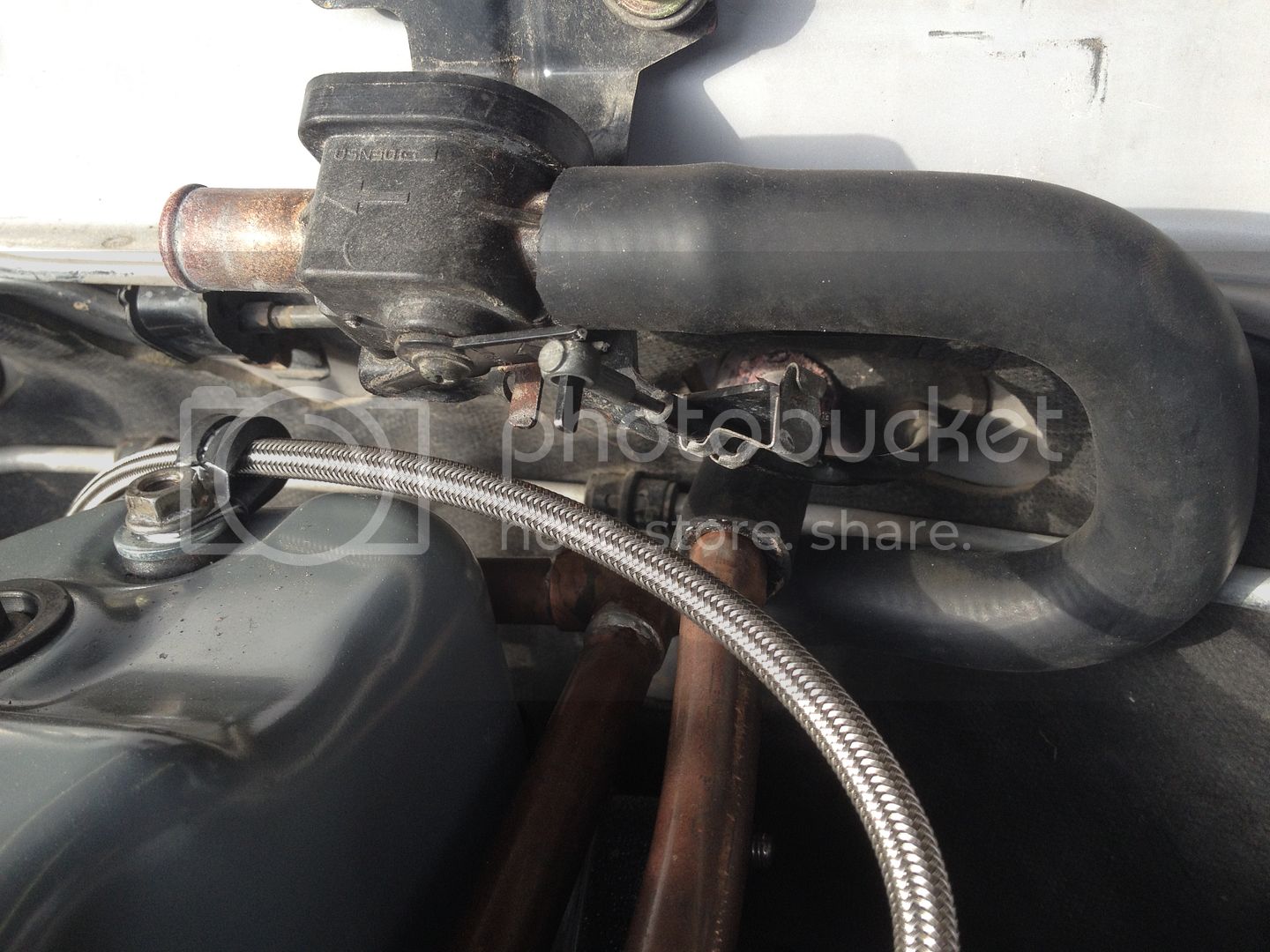

Few pictures of the heater hoses I got done last week.
As you can see I needed to use some copper pipe. I plan to get it powder coated.

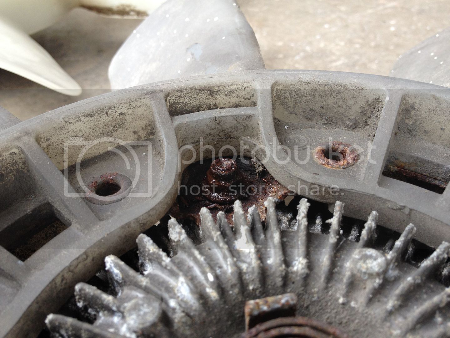

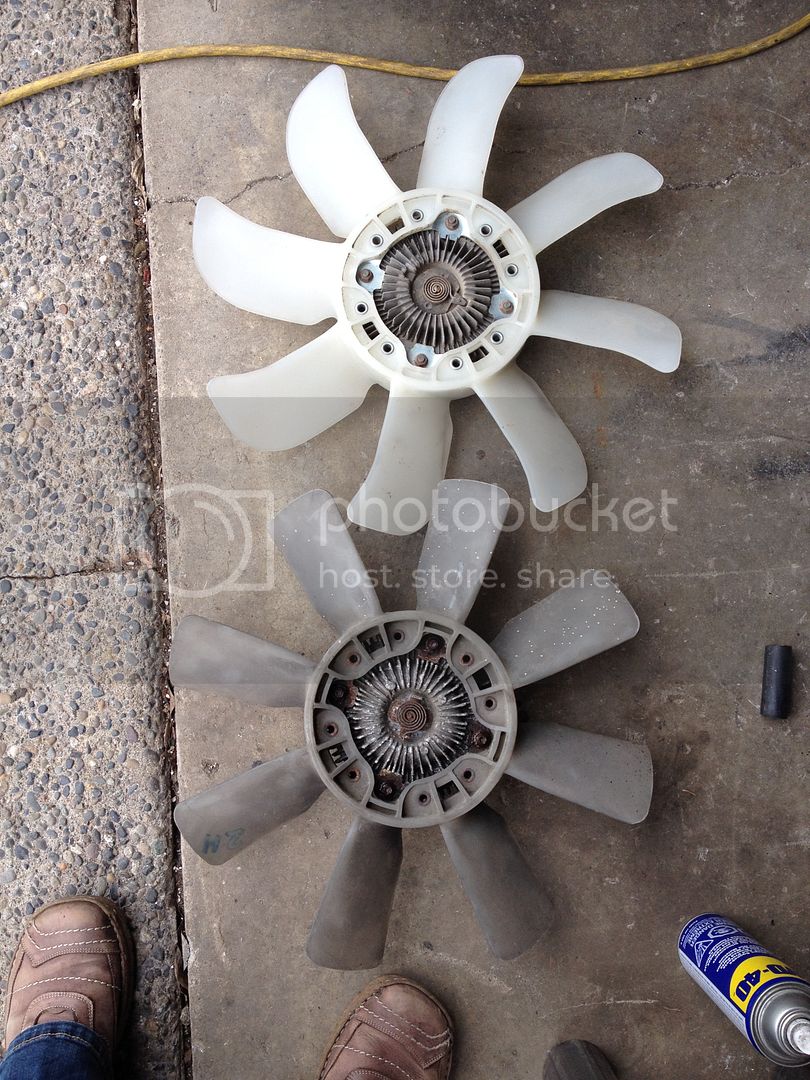

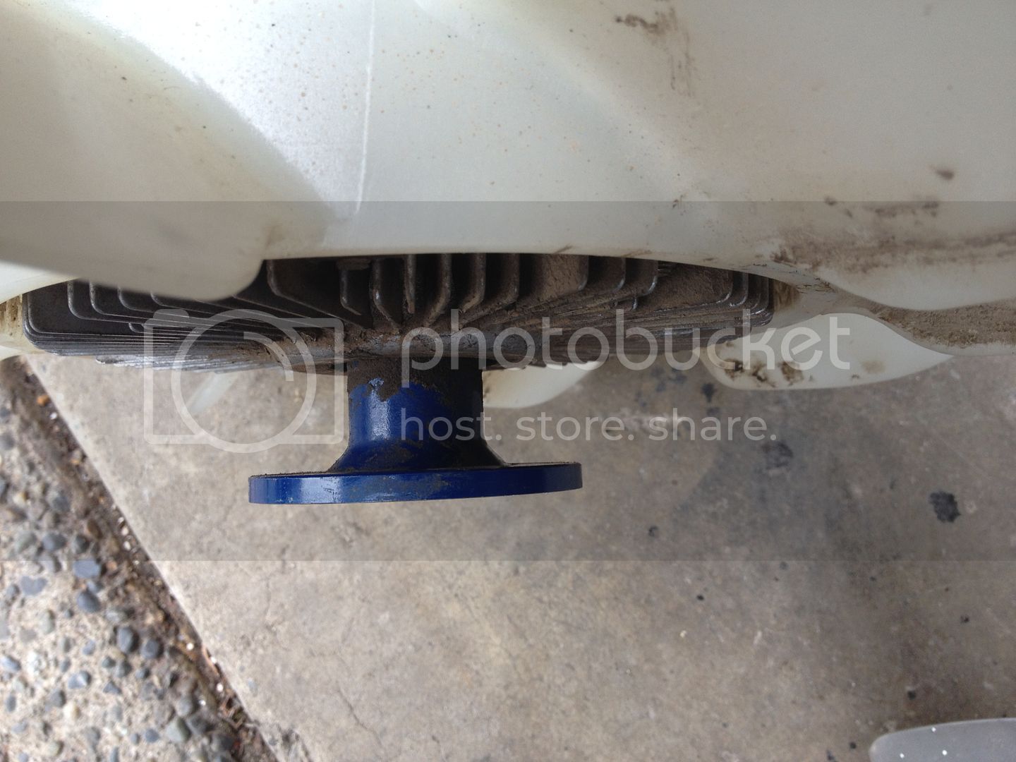

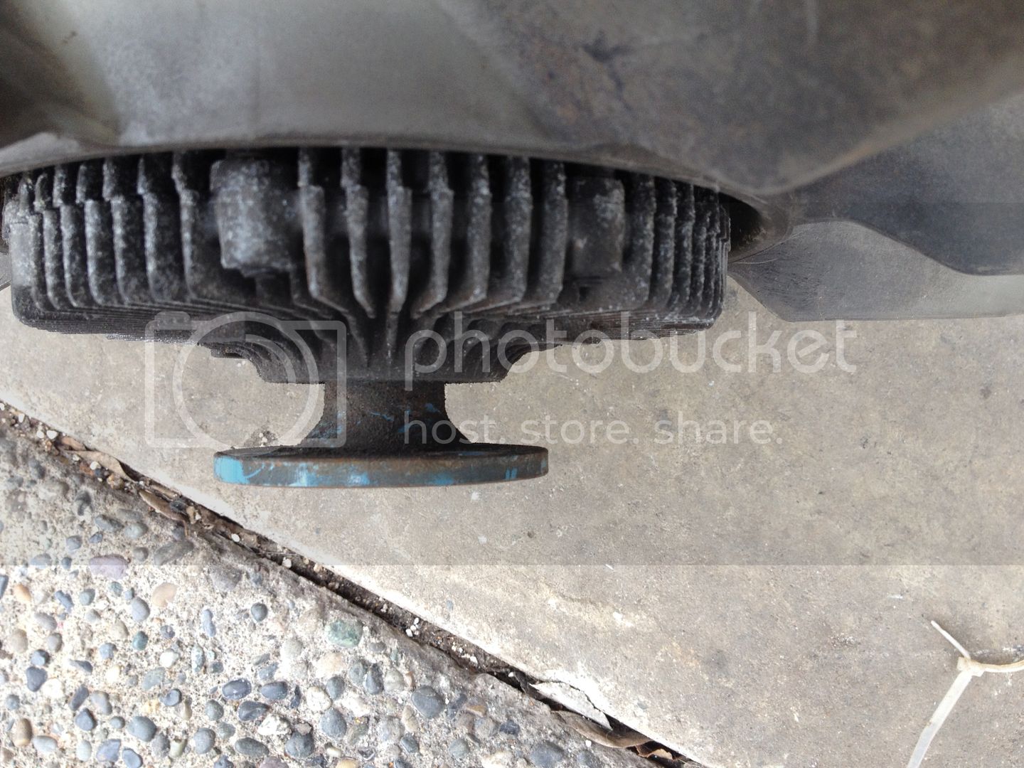

I also did some fan work.

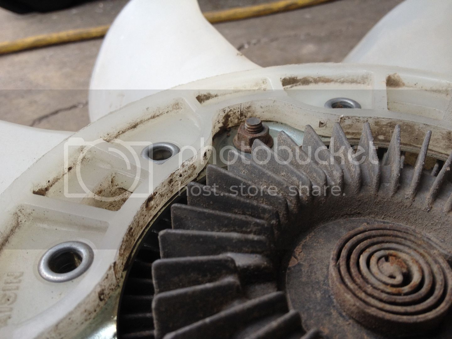

The stock 1FZ fan and clutch put the fan a bit close to the rad. So I grabbed a spare hj60 fan and clutch I had. The snout of the HJ60 clutch is about 1/2-3/4" shorter than the 1FZ. The units with fans are both the same depth but the 2H fan blade is pushed further forward.
Side by side.
1FZ
2H
And the fan side by side.
1fz (notice the offset)
2H
Side by side of the blades the newer one is the 1FZ the blades seem to have more surface area. Those are the ones Im going to run so I can get as much air through the 4 heat exchanges that will be in front of it.
I have a few different layouts to play with so fan blades can be swapped if there are issues.
That intercooler looks like a sweet fit Jerms. I'm must confess I a tad jealous. That thing will perform well for you. Offsetting your fan will also help it pull better. I forget what is ideal, but your close to it. I really like that copper pipe work for heater lines. I think I'll have to borrow that from you as I'm going to be doing some of the same work in a month or so. Your intercooler/rad support looks very functional and will let you take it apart quite easy. I dropped by this sat, but you were not there so.... I went to Kms for an hour and half. My kids were at go bananas. I can't stand that place. Just wait till you have kids!
Yes I think it will work very well. It fits great! A bit of fiddling still needed for the inlet/outlet but its getting there. When I cut off the existing inlet out let I was very surprised by the core style unlike anything I have seen before. It consisted of each tube being broken into 4-6 box tube and in those box tubes it has lots of small fins sticking about 1/3 the way into the box. Never seen a core like it before. I can see it flowing very well indeed, not sure on its cooling effect though. Time will tell I guess.

Im really happy with the way the heater lines worked out. It should be effective I wanted to keep it as clean looking as possible and integrate the circulating block heater. Incorporating the rear heater will make it a bit more of a mess and a bit complex. Going to work on that when the engine is back out again.

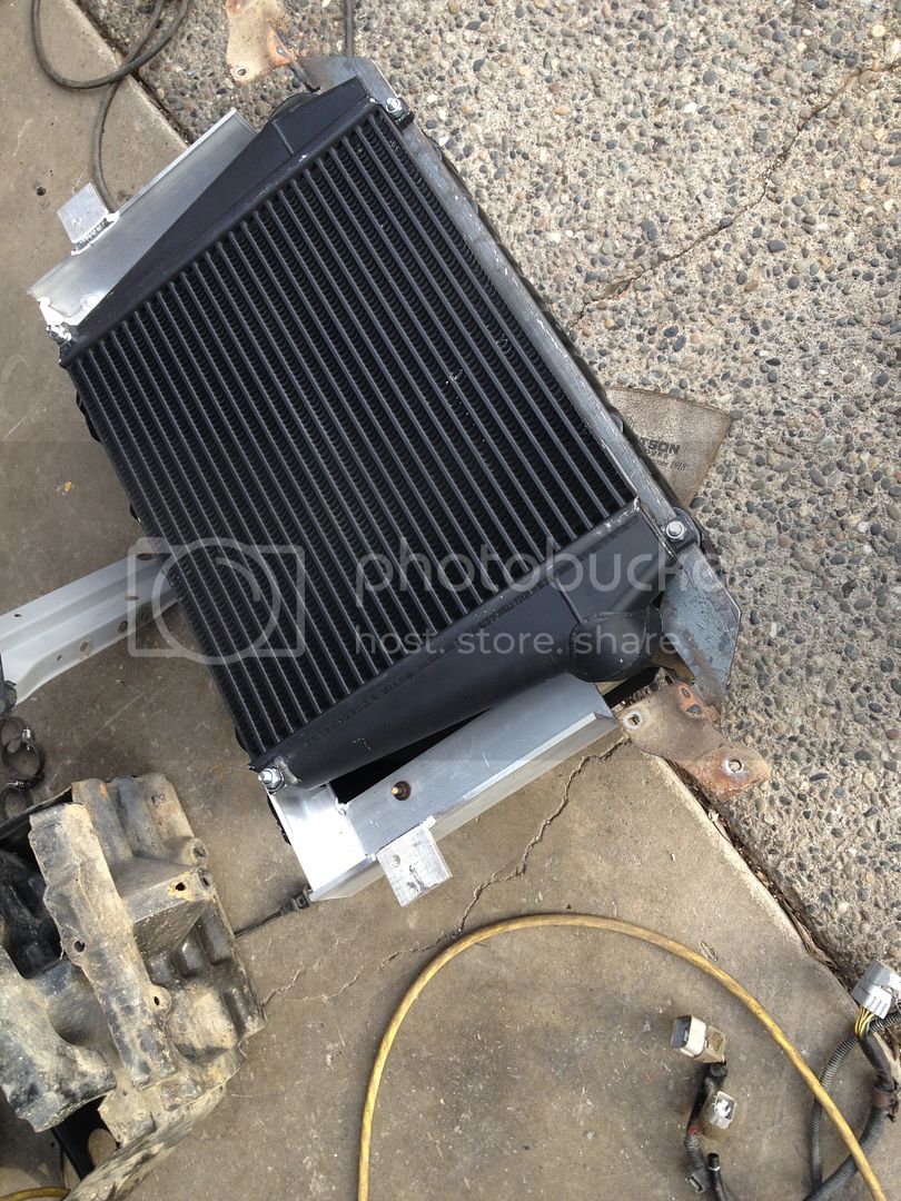

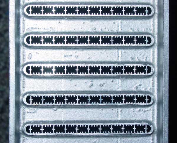

Sounds like a good tube and fin style intercooler. They are difficult to find as most are bar and plate.
What is it out of and does it look like this inside?
The tube and fin type flow much better to the radiator behind.
What are you using to TIG that aluminum? Thorated or Ceriated rods? 6061? Amps? Pulsing with the pedal?
Those beads sure look reaaaaaaaaaaaaaaaaaaaaaaaaaaaaal pretty!
Sounds like a good tube and fin style intercooler. They are difficult to find as most are bar and plate. What is it out of and does it look like this inside? The tube and fin type flow much better to the radiator behind.
Yes it looks just like that inside, was very interesting. Im looking forward to see how it performs. Im glad they flow well to the rad behind as well. Everything I have used and worked with in the past has been bar and plate. Those cores look much different. Since I am redoing the inlet i may put a deflector plate in it to distribute flow through the core a bit mor evenly.
The TIG work was done by a friend that is the best fabricator i have ever seen.
If you don't mind asking your buddy what tungsten he uses, both size and type. I'm just starting to TIG aluminum and it's nothing like stick or spooling steel. Just want to make sure I'm on the right track rather thank wasting electrodes, gas, and filler. Tell him his stack of dimes sure is puuuuuurdy!

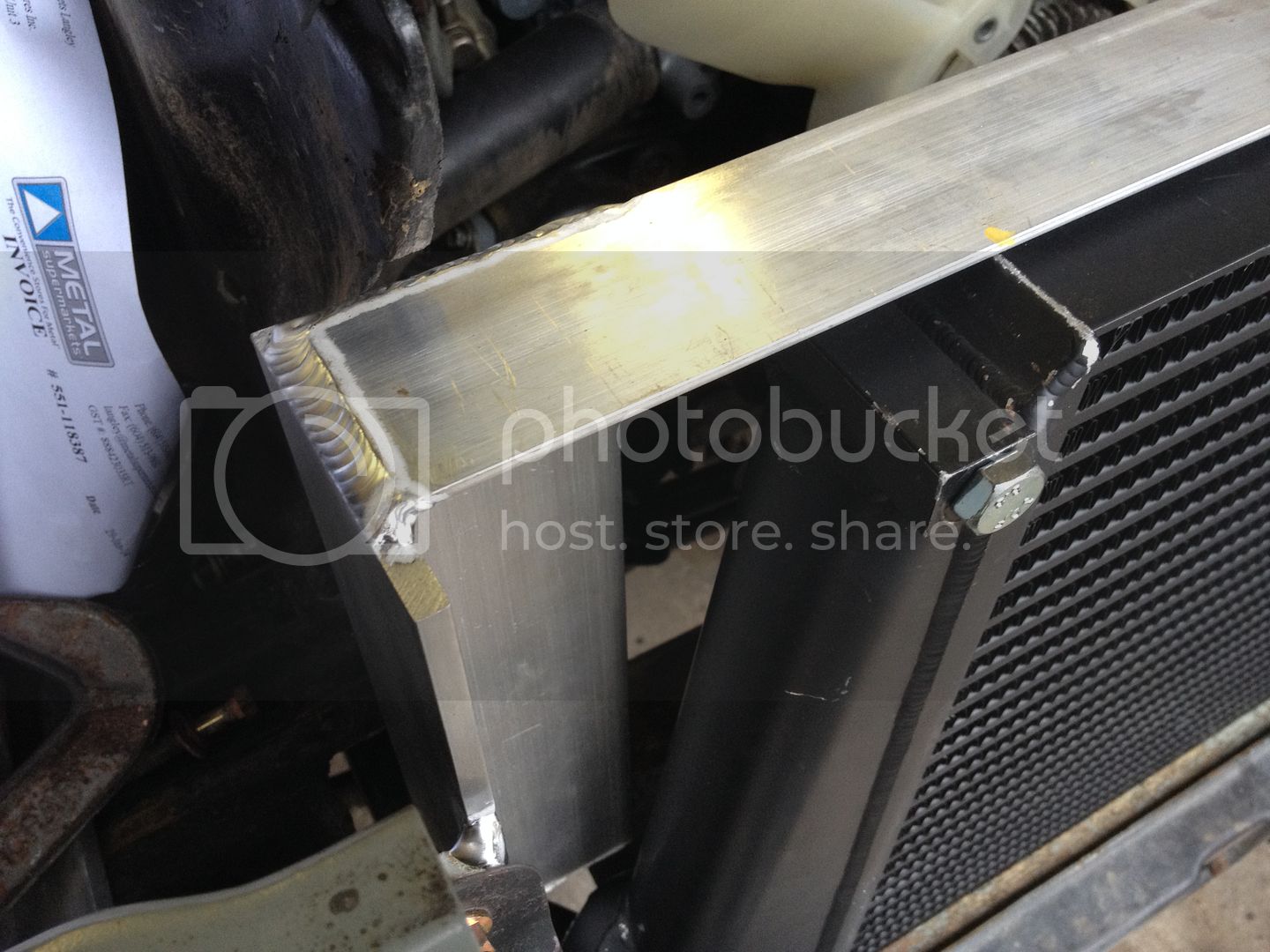

Today I spent the morning at my buddy's fab shop bending up new end tank sections to plug the holes left from cutting the old out let and inlet off. Worked out good and hope to have it welded tonight or tomorrow. I am just having then weld on a 2.5" straight so I can connect with a 90* silicone coupler. I also fashioned a flow distribution divider for the inlet, this will direct half the flow coming into the intercooler up into the top of the cooler. Problem with it just going straight in is you have 1/3 to 1/2 the core doing 80% of the cooling. This will send half the air up into the top 1/2 of the intercooler allowing it to do its share of cooling. Sorry no pictures of that part today, when I pick it up I will get some pictures.

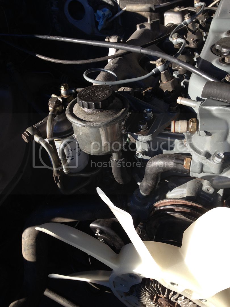

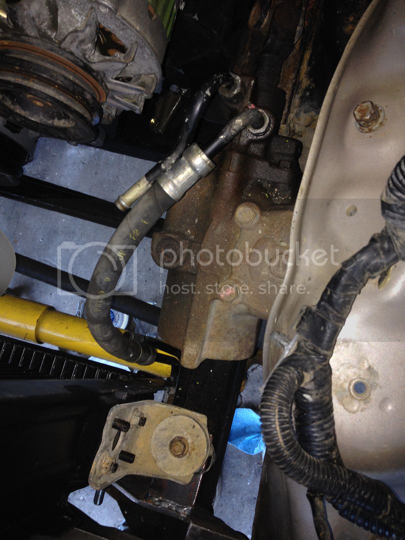

I started with the PS resivor and where to mount it. I decided on mounting it beside the fuel filter on the old fan shroud tab.
Worked well there and I was able to bend the pump feed to an angle that allowed me to get a clean run of the hose from the rez.
I then hooked up all the pressure lines for it.
Fits like its made to go here.

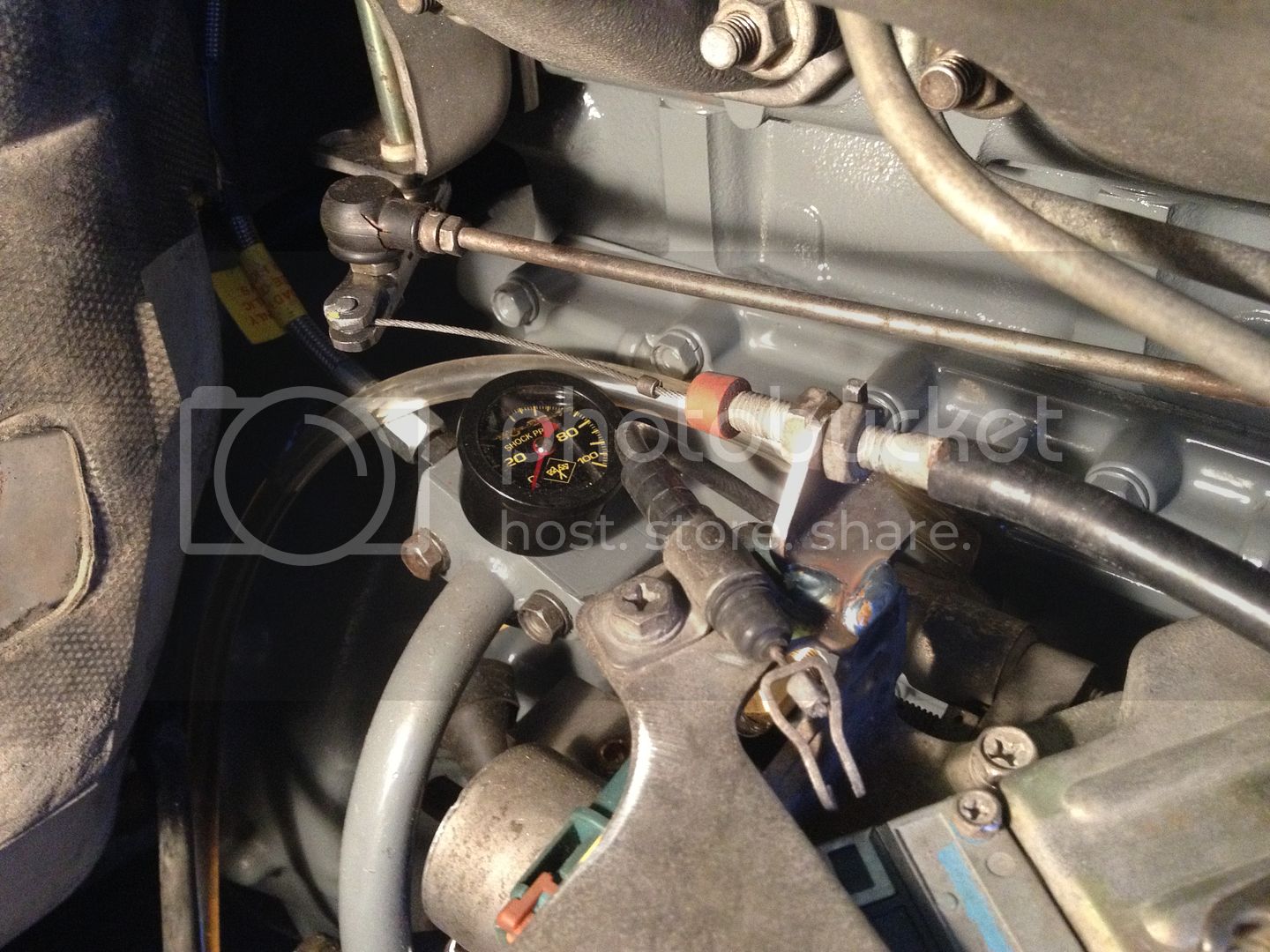

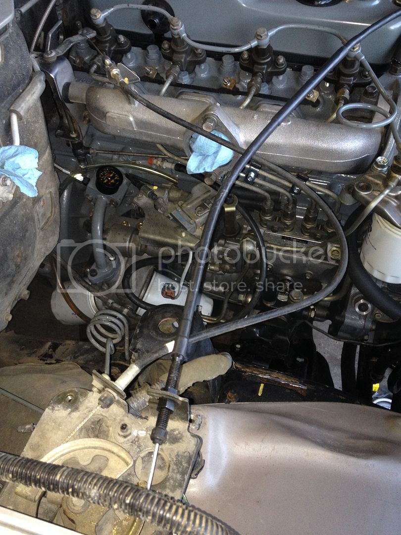

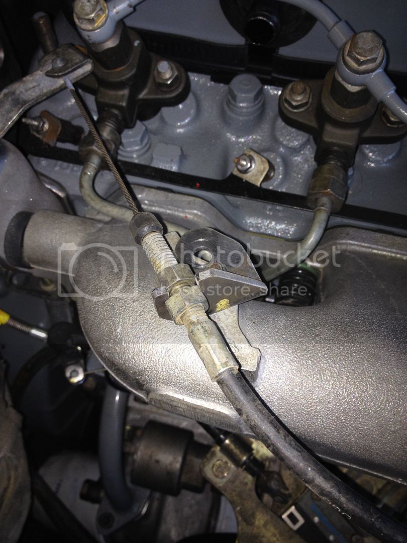

Then I hooked up the FJ80 throttle cable from cruise to throttle. Had to make a tab for it but turned out good I think.
Both cables hooked up and when I push the peddle I move the throttle now so that was easy.
Lastly the kick down cable attchment, same thing here needed to make a braket to hold the cable. I had modified the factory Isuzu arm to take the cable end a few months ago.
Works great.

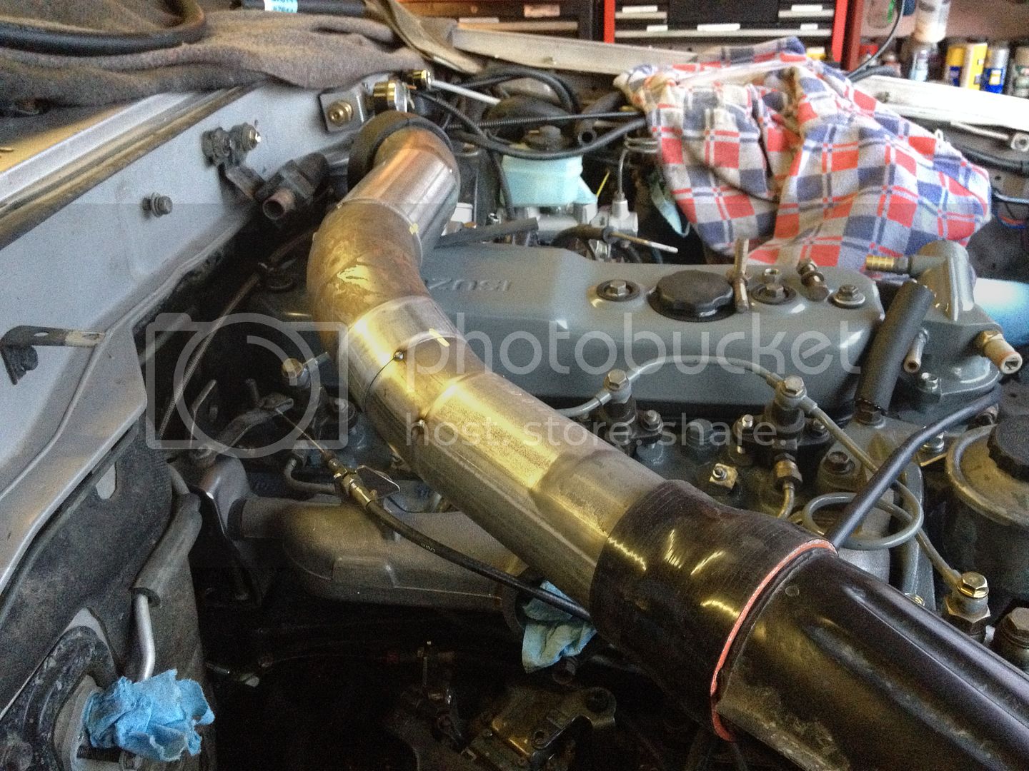

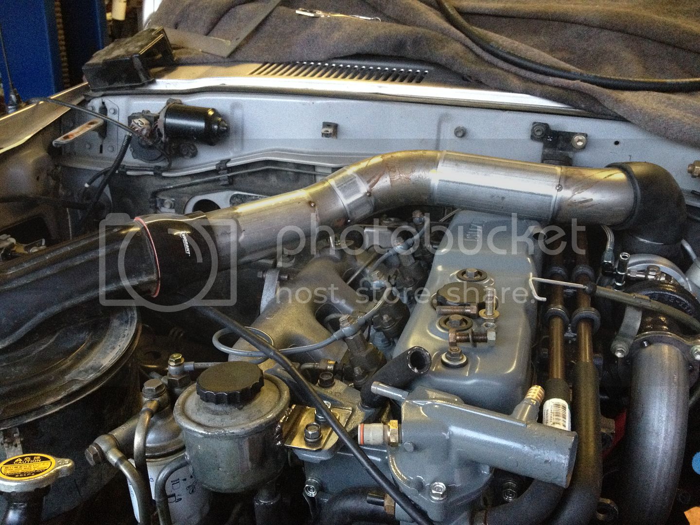

Today was all about pipe.

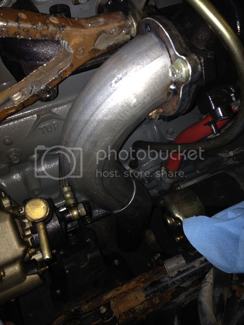

Spent today making the inlet pipe and down pipe.
Inlet pipe was tricky since I have limited room. I started with a 2.31-2.5" cobra head intake off the turbo. I had to trim it down a fair bit. From that I immediately went to a 2.5-3" 90* rubber boot. Then 3"pipe the rest of the way its all mandrel bent and fits very well. Took about 2 hours to get this just right. I did need to have the inlet of the turbo machined to take off the silly SAAB flange and fit the 2.3" cobra head (its actually stretched to 2.5"). On the air filter end I simply cut off the MAF brackets and was left with a nice bit 3.5" opening. So I got a 3"-3.5" silicone reducer for that end. I still need to sort out some sort of flex section. The way it is not its very ridged and will no doubt transmit a lot of vibrations. I did get a 3" rubber hump hose bit its almost as hard as the steel pipe its self it was shocking. So I need to come up with something but am a bit at a loss of what to use.

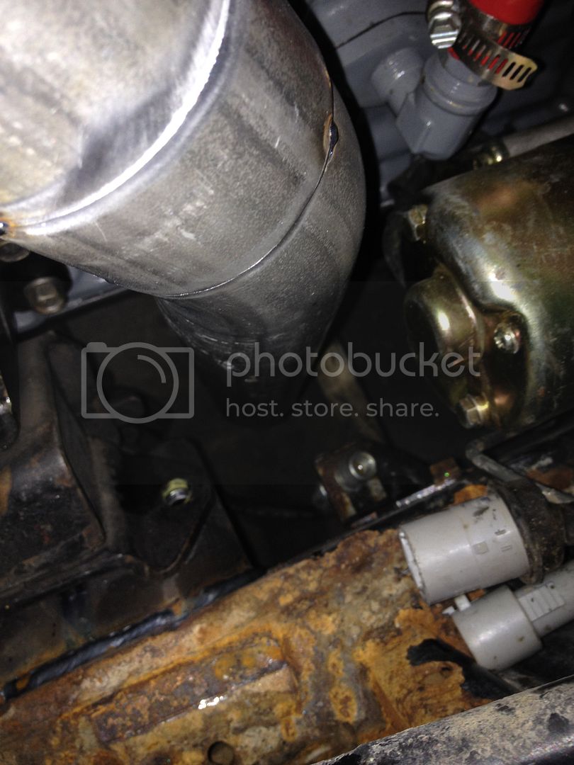

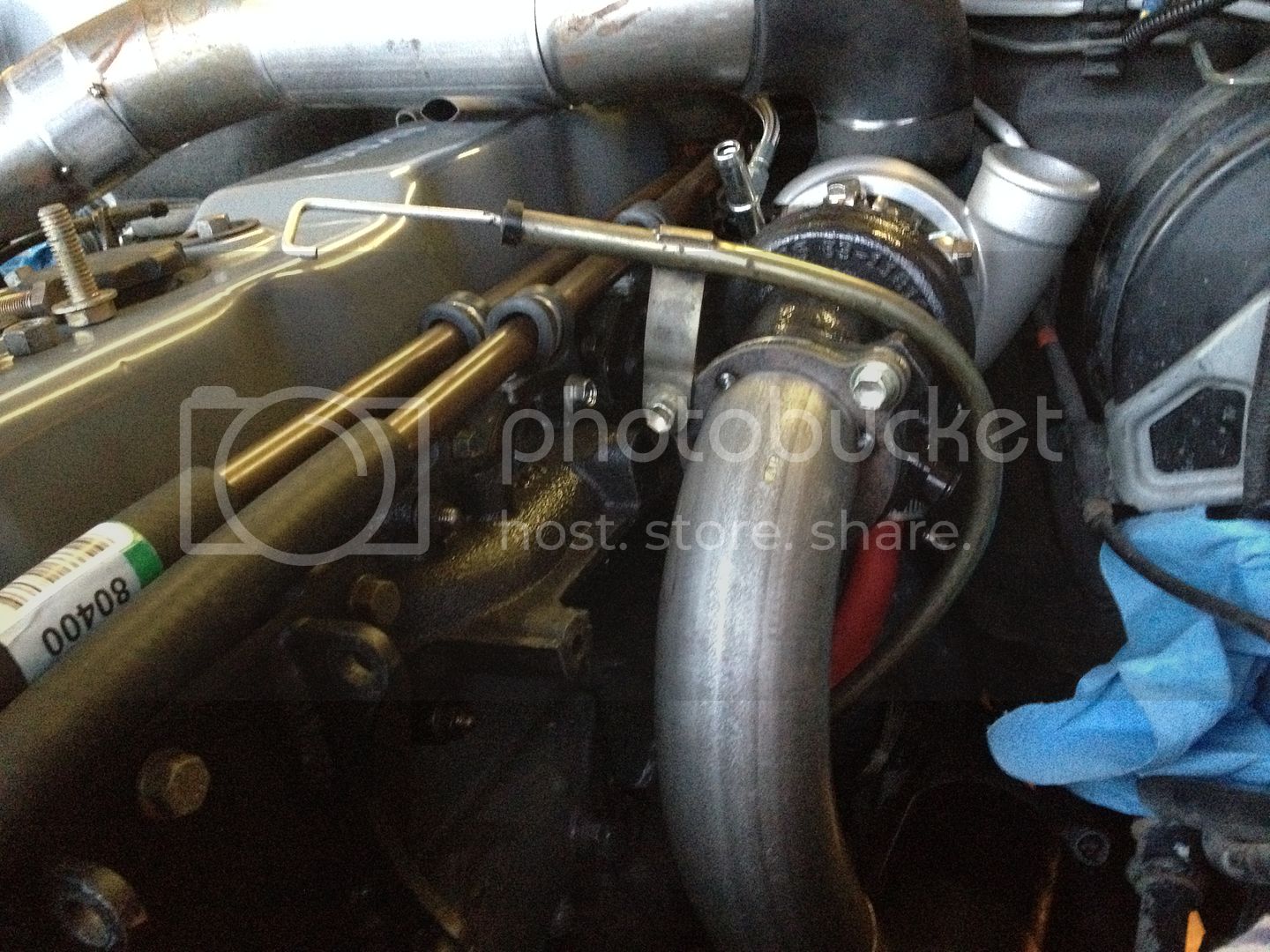

Downpipe was next, man what a pain that was. I had wanted to run 3" off the turbo but that was not going to happen with out a lot of work and in the end I do not think it would have flowed much better (would have needed to make some very restrictive bends). So 2.5" it was off the turbo, even that was tight with the alternator below the vacuum pump was hard to miss. After a few hours of slowly cutting up a mandrel U bend I had it and everything fit. My clearance was further complicated by the lower of the 3 turbo to down pipe bolts being right at the bottom where the minor side of the bend goes. I was finally able to get something to work, and I think its going to work well.
Here you can see my clearance issues.
Over an inch of room for the starter to keep cool. I will be rapping the down pipe and putting a heat reflective cover on the starter.
Dip stick tube bent and secured. Quite happy with how that turned out. I will need to do something to minimize the heat to prevent the rubber end of the dip stick from melting.
So from the starter back the exhaust will be 3" a V band is going to be put right at the base of the vertical section to allow removal of the starter easily. I plan to put the exhaust break somewhere there as well. I got a stainless exhaust flex but I'm not sure how it will handle the pressure of the exhaust break so may try and locate it after it. Any input? Cant see getting more than 30ish psi in the exhaust when the break is on?
More to come tomorrow.
Nice clean fab work Jerms. That down pipe is a bugger with that darn bolt there. Ive dealt with that before and it's like being stuck between a rock and a hard place.
