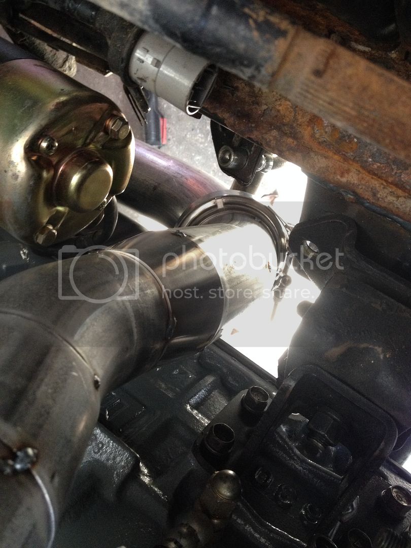

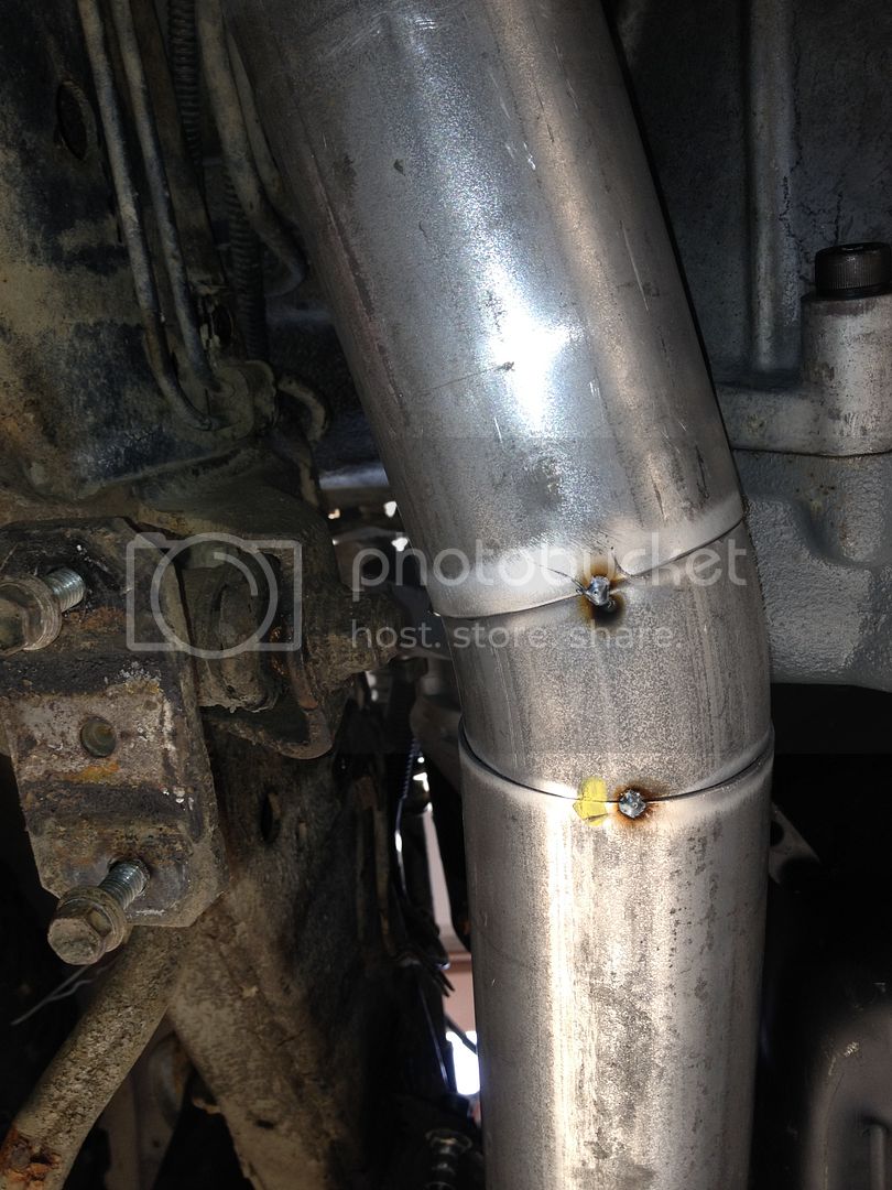

Worked on down pipe and exhaust today. Started by adding a 2.5-3" cone adapter for the jump to 3" pipe. I was originally going to put the V band right there but I realized it would eliminate any chance of removing the starter. So I moved the V-band about 6" down and in the middle of a bend.

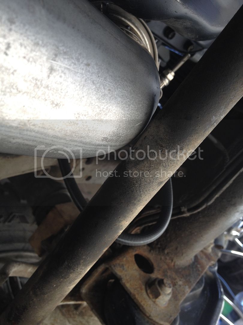

Very close to the tie rod at full bump. I'm going to lower the bump stop another 1/2" and clearance the pipe a bit. I could not get it any further away with out running into clearance issues somewhere else.

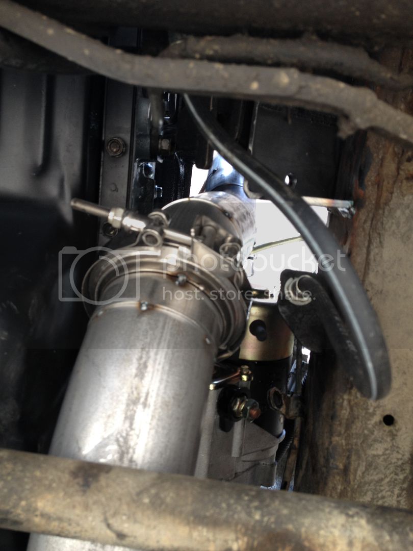

V-band placement here it allows easy removal of the down pipe to allow removal of the starter.

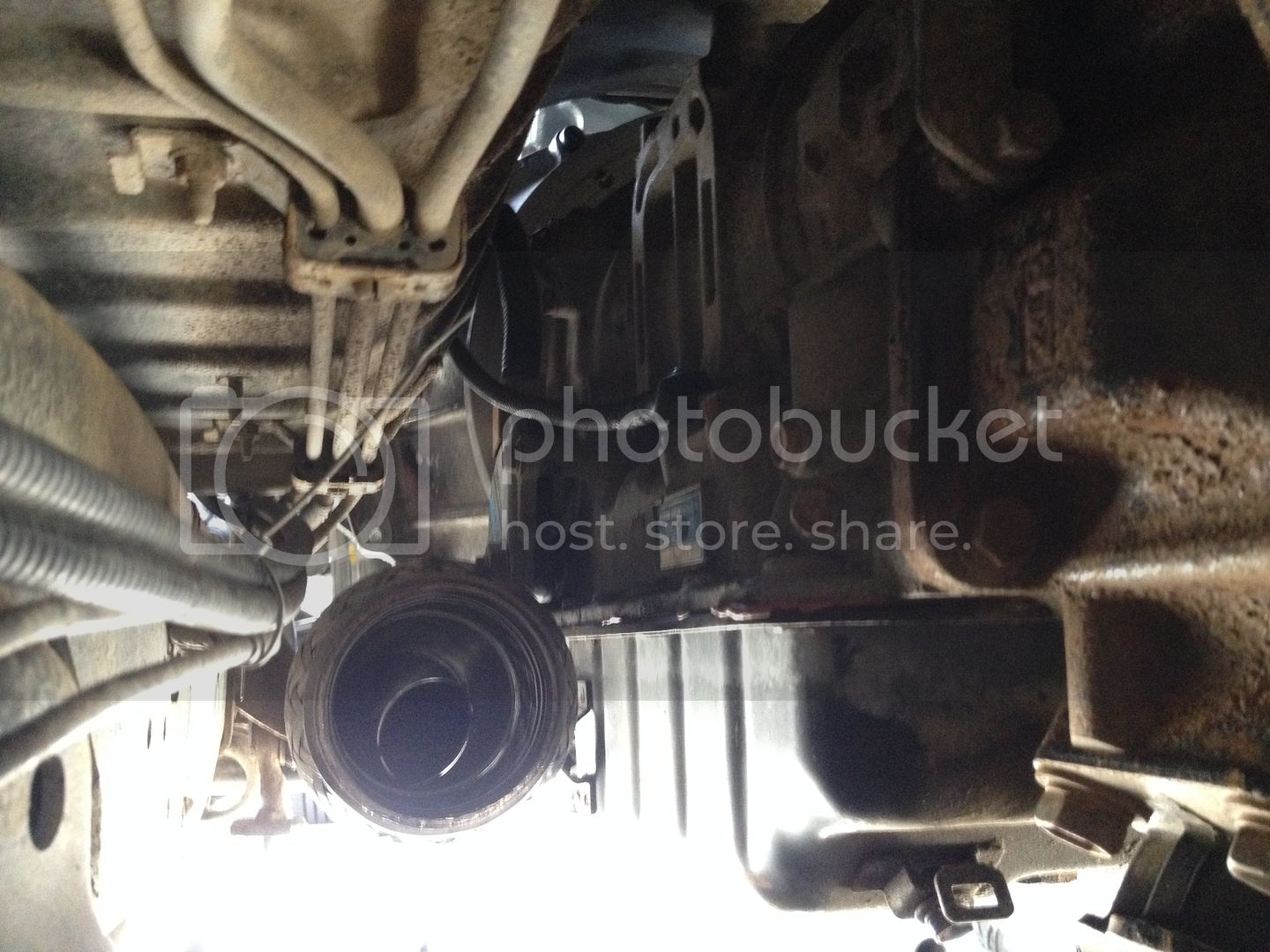

Got it snaked around the sway bar mount and bell housing.

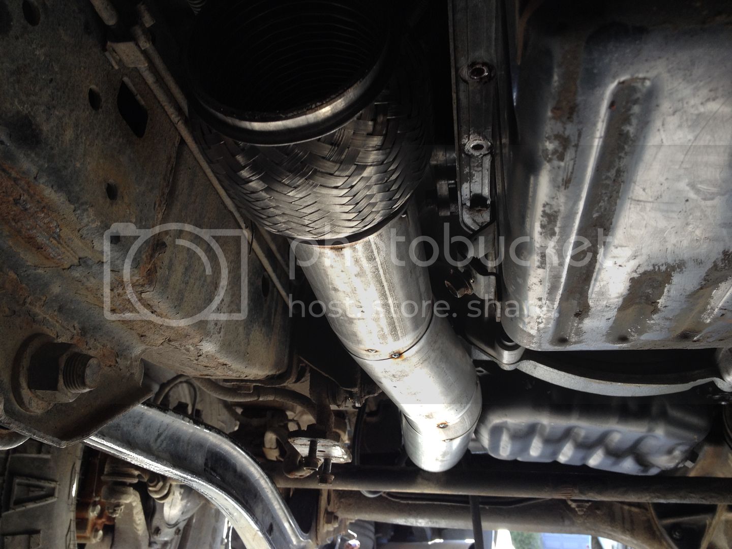

Then down the transmission to the flex pipe.
From there I will build some exhaust mounts and put in the exhaust brake about 11" back from the flex where I have room to mount it. Its big and surprisingly heavy.

Your clearance at full bump made me think of the guy I saw at the mud drags. Big power and too much motor movement put his exhaust into the tie rod and steered him out of control, rolling the rig.
In retrospect he could have probably just gotten out of the loud pedal but he panicked, and things went pear shaped.
At full bump I doubt the two would contact for more than a brief moment, but it's something to keep in mind.
Yes I am hoping to have 3/4" clearance when done. The engine also will pull the exhaust up and away under power so I should be fine. I cant see being at full bump for any more than a moment at a time and even those are few and far between. I do not jump, race or otherwise drive at excessive speeds off road. There will always be a time when I do not see a cross ditch and hit full bump but I can count on one hand how many times that had happened.
Its always in the back of my mind as I built this that us why its got no springs or shocks and it at full bump.
Thanks for making sure though and thanks for the story.

Exhaust is looking nice. I would suggest a solid mount to the transmission or bell housing just before the flex joint, then install a much longer flex joint. The flex joint you have may dampen some vibrations, but they allow/absorb very little lateral flex or shuddering.
I built a 4" down pipe and 3" exhaust for my hdj80 and did this. I had some very tight clearances to the chassis, less than 3/8. I used a 14" long flex joint after the transmission, I had no issues with the exhaust contacting the chassis, even with a violent engine shudder at shut down.
The factory exhaust knocked on the chassis at shut down, I was determined my system would not, hence the long flex, and it worked a treat.
