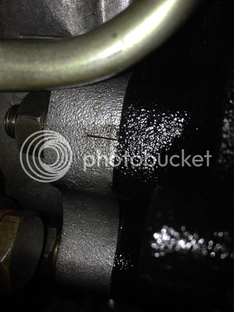

So got the pump back on and spill timed (really cool when you have a clue how to do it). The timing when I started was at 6-7 deg so I got it set to 13 deg spec as per the manual. Not sure if thats enough to cause the issue I had but it was not right at any rate. Did not have enough time to get it all back together so the test run is tomorrow night. Fingers crossed! Here is a picture of the factory timing marks. Sorry hard to see the one on the black metal. Anyways when I started they where lined up and now they are 3/16th off from each other (spill timed at 13deg).

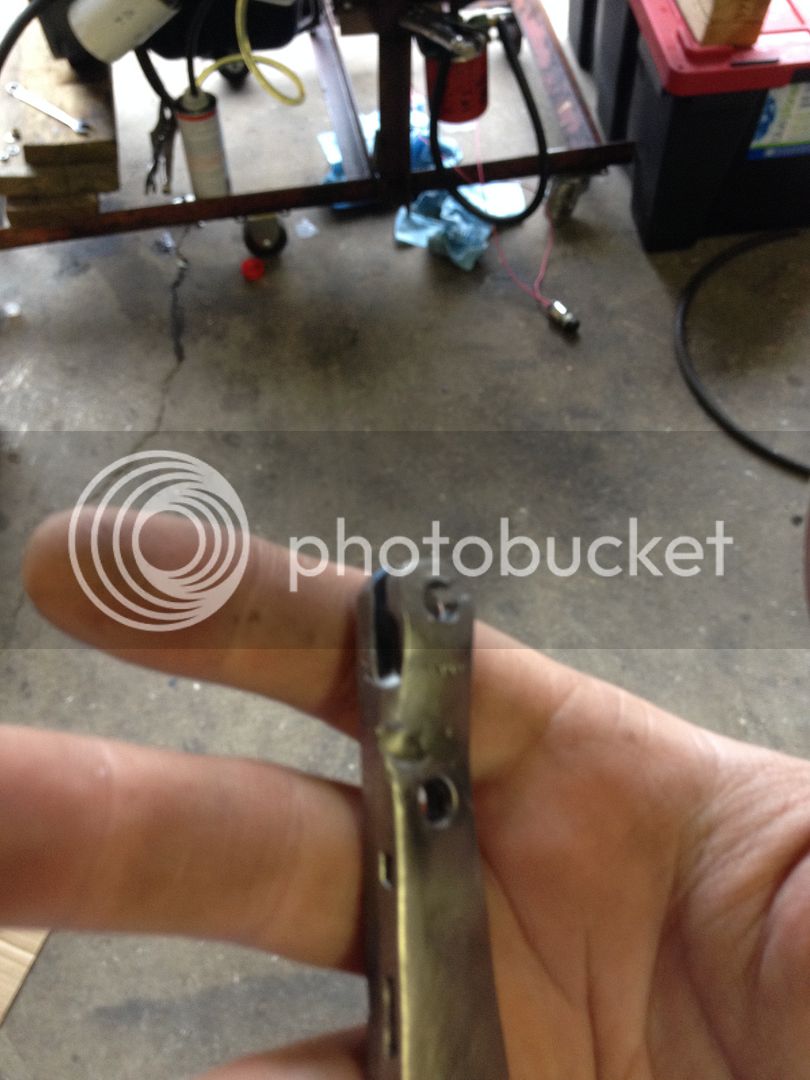

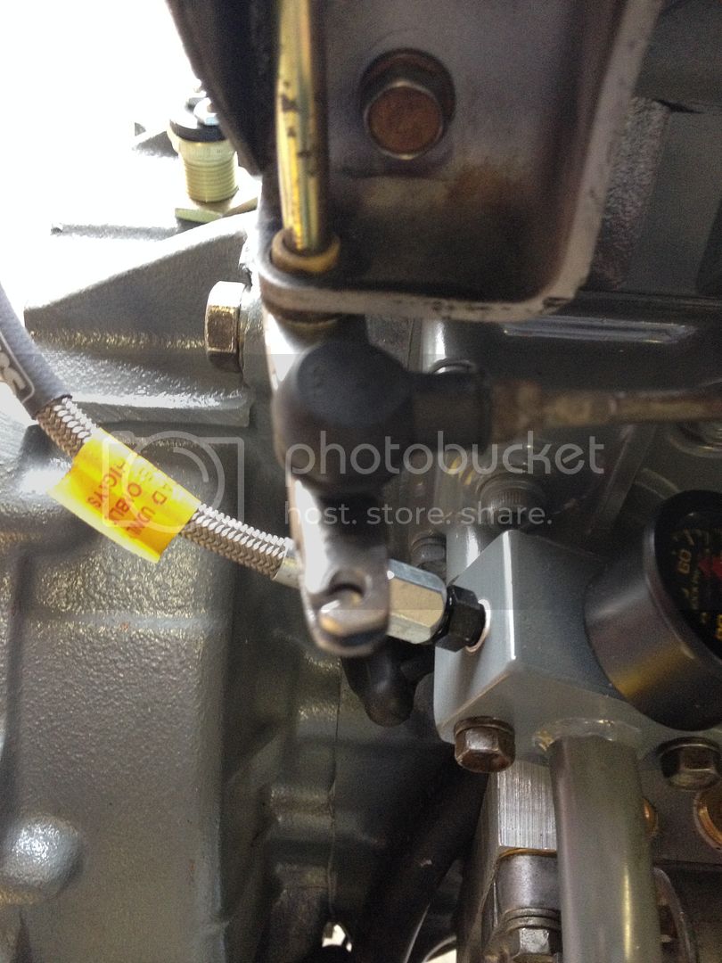

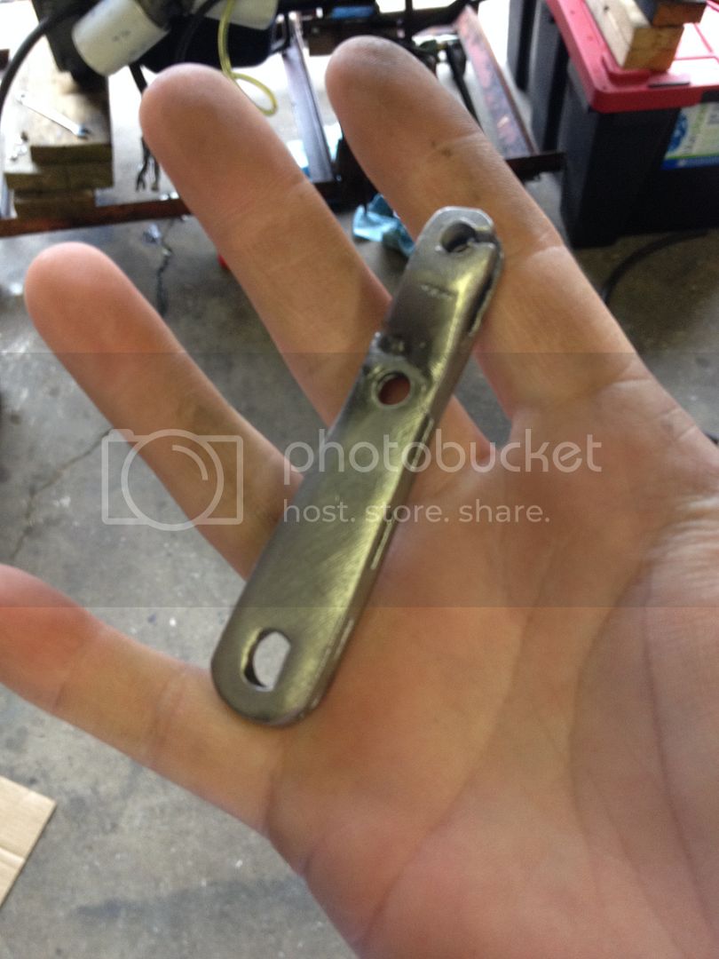

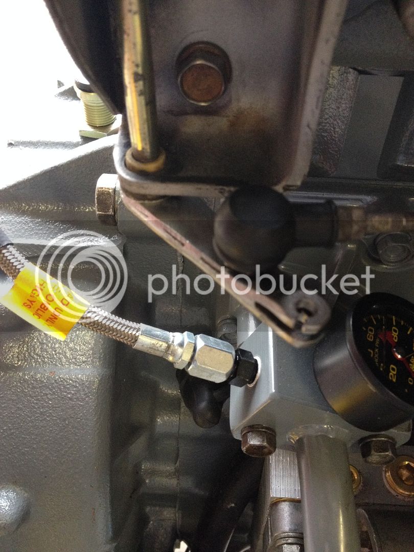

After that I spent the rest of the day making a cable connection at the throttle for the kick down cable.
What I did for the kick down was use the arm on the bottom of the throttle shaft (best way i can describe it). I then took some scrap 1/8th I had laying around and made a second arm that i would weld to the stock one. I drilled the holes for the stock connections and then measured my arm sweep. I know that the trans needs to see 1.47" of sweep. So I made the arm long enough to account for that. Then I took another pice of 1/8" and made a top part of the cable attachment. Then I drilled the hole through both for the cable end.
Throttle closed.
Throttle open.
Still need to make the base cable securing bracket. Plan to mount that to the back of the pump.
I plan to make the same kind of mount for the cruise control cable but on the upper arm.
