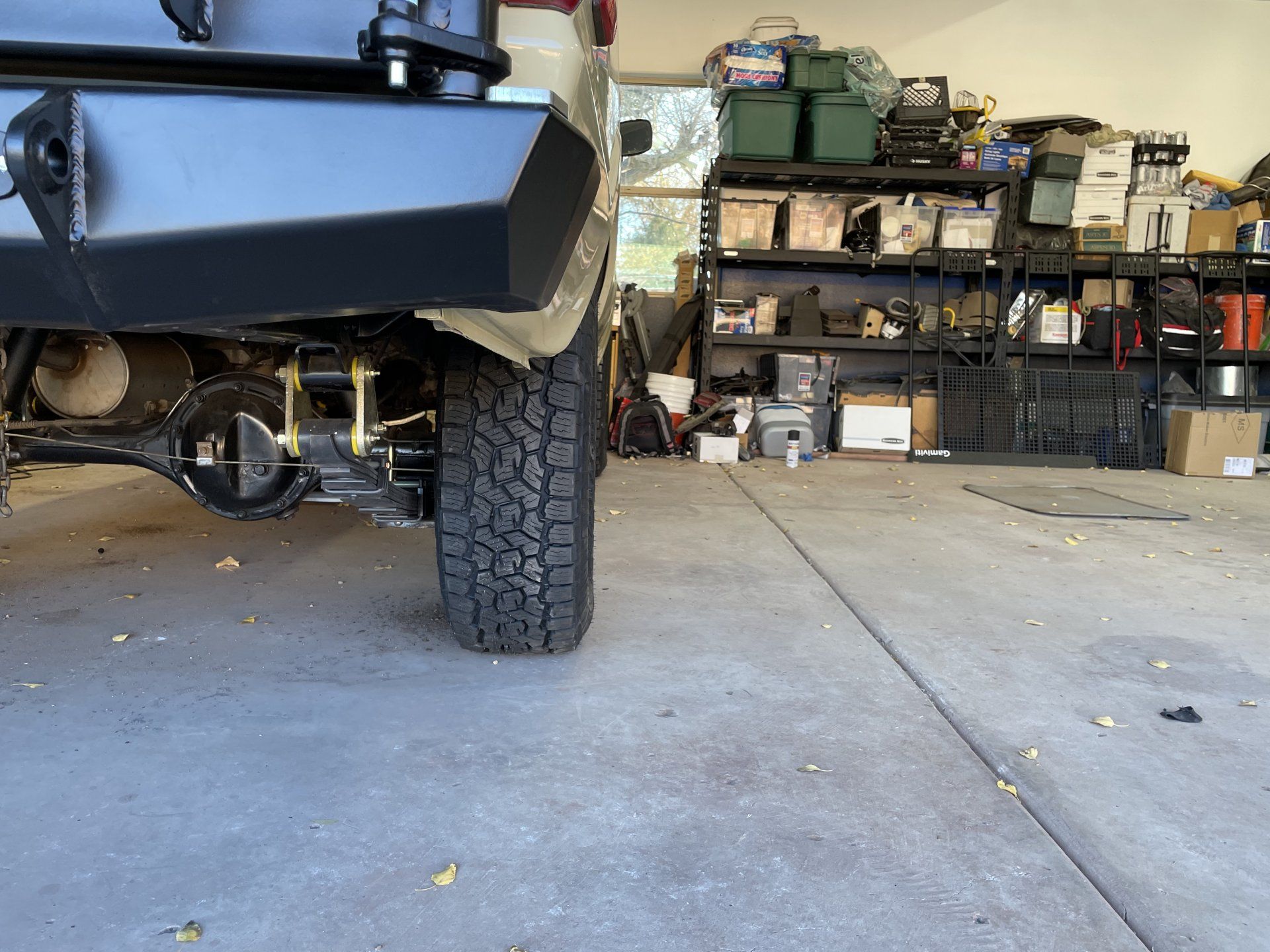

It is a 4plus bumper out of AZ. i’m very impressed with the quality of this bumper. Not shown is a Jerry can holder on the right and a ladder. It took about 4 hours to get the crossmember out, but this has a better brace then original crossmember.
Decided to go with the TRE Pro wheels! I didn’t want to use spacers and couldn't find the right back spacing.
How did they fit? Any rubbing in the front? What was the back spacing on those?
they fit really good! No rubbing and it’s has 5mm/4.2” backspace it’s only a 7 inch’s wide. I tried putting my wife‘s 80 series 16” American racing wheel in 285/75/16 ( 32.8 “) and it was rubbing. Not to mention the wheel wouldn’t seat because of the tie rod hitting. These Toyos measure 31.7” .
Dang that 60 is looking purdy! Who painted it, was it you? Also, can I get a closeup and manufacture info on those rear bumper lights? Are they single color or dual color LEDs?
