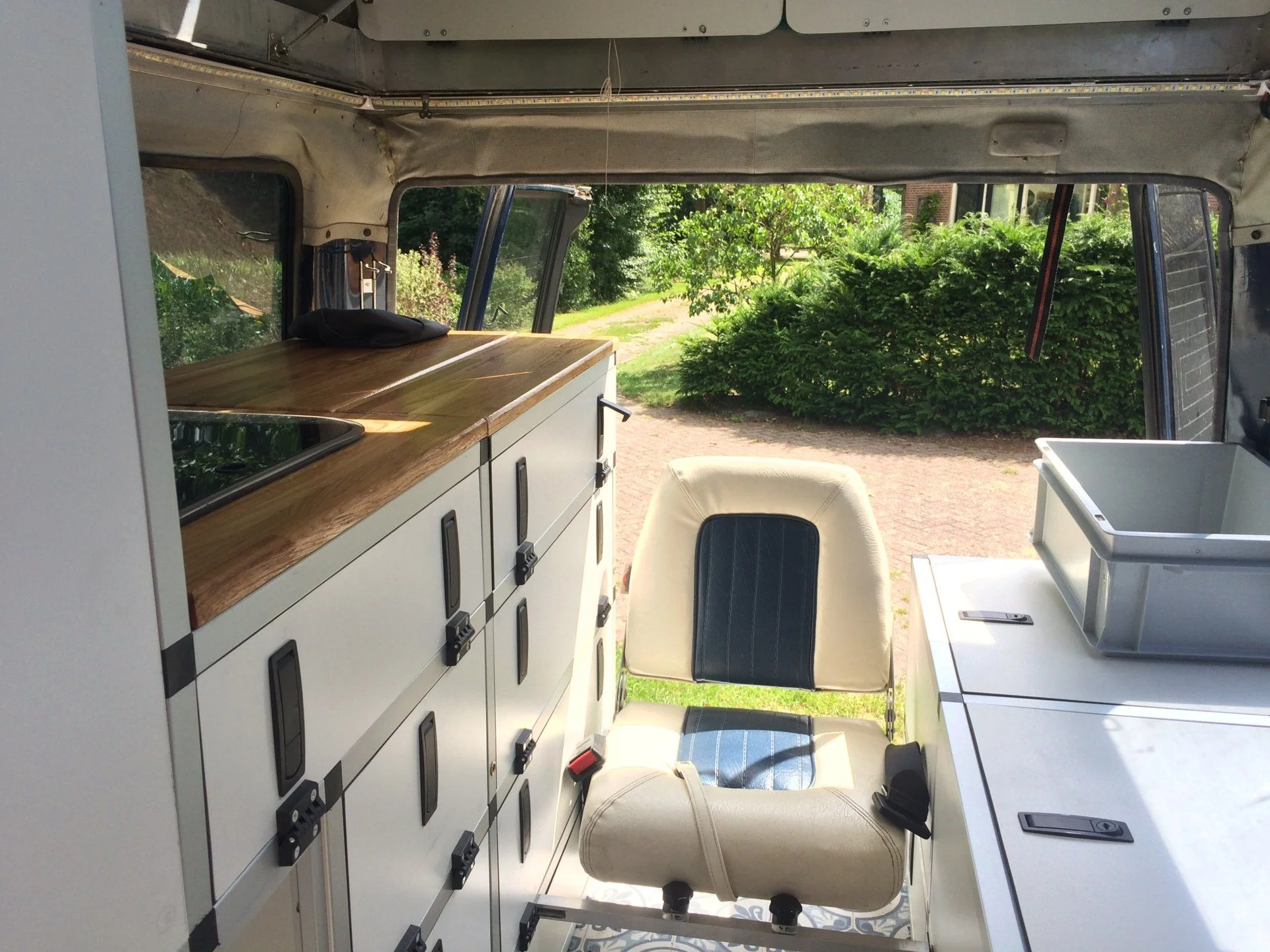

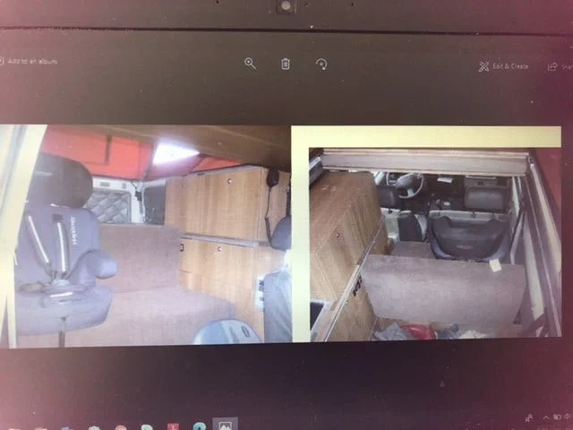

I still think you are looking at some sort of situation like this. Or even just mounts on the floor for the car seat. You could mount this as close to the back of the front seats as possible so you can reach the child. Then you just pull/remove the setup when you camp for the night.
img_3740-jpg.1735899
Funny, that's a photo of the rear of my car! I threw that seat out as it was a total pita to install when we had a temporary passenger and didn't feel secure as it was mounted to the furniture instead of the floor.
Might investigate the spot behind the front seats - i'll need to move the Engel to another location.

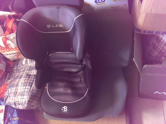

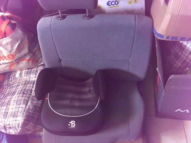

Hi Paul, i have installed 2 scheelmann as well on my 76. I have the original bench if you need (I am in Geneva, Switzerland).
I don’t have a baby seat but only a toddler one. Will try to send you a picture. Cheers
Is there anybody out there who could do a quick test fit with a child seat + adult on the front bench and take a photo? Would be awesome
