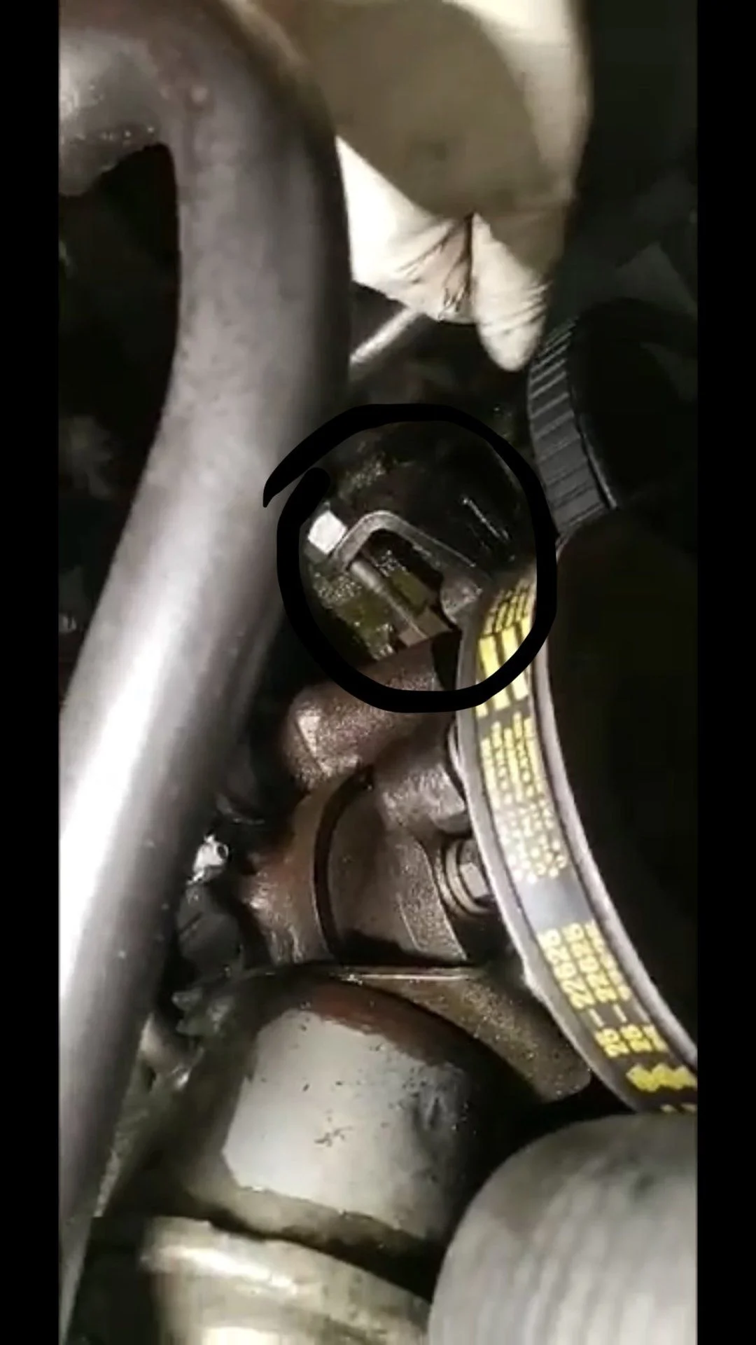

Having a hard time finding these parts but I’m new to land cruisers and probably not looking in the right places. Also here’s a pic from my mechanic showing the part I need. Tried to upload a video with a better view of the part but wouldn’t work. Hopefully you guys can tell from the picture. That is the pump tensioner pulley that needs to be replaced correct? TIA.
That’s the water pump tensioner yes, but it uses the air pump to tension. Very simple design, what failed? bracket looks like it just needs to be bent straight and then adjust accordingly. If it’s a little stuck, loosen air pump lower bolt and upper adjuster lock bolt and use adjusting bolt to tighten/slack.
I haven’t seen it in person yet but In the video my mechanic sent me that bracket is very loose and wobbles around. He’s saying it’s broken and looks like it’s been rigged with some simple hardware. From what you’re saying though it sounds like it might just need to be tightened.
