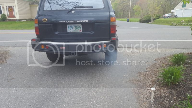

Hey guys,
My wife drove the Landcruiser today, which gave me a chance to look at it from the outside while it was running. I noticed that, when she started it, there was a little white smoke coming out of the exhaust. Then, when she accelerated onto the road, I saw this:
Is this smoke something to worry about? Sorry for the NOOB question but this is my first diesel

Thanks for the reply. The temperature was about 50 degrees F when this happened. I took 3 pictures right when she pressed the gas and this was the smokiest one. Before and after, the camera couldn't pick up the smoke at all. The pump was rebuilt, as were injectors, by the previous owner. But, I can't remember how many years ago that was. I'll have to check the receipt stack.
A puff of dark smoke from these is normal as you hit the throttle from standing start.
You can tune it out to a certain extent, but will affect performance. you need plenty of fuel available as you come off idle to get decent throttle response and to give the turbo a decent shot of exhaust gas to help it spool up.
If what you were setting was just a puff that dissipates almost immediately as your wife moves off, I'd say it's as it should be.
You usually can't see this while driving, sometimes you'll see it if a cars headlights light it up on the right angle.
It can be helpful to follow behind while someone else is driving your truck to see if and when it smokes.
A bit of a puff taking off, or a bit of sooty smoke on initial hard acceleration is normal, or on a hard uphill run, unless you've tuned it for grandma Lumpskie to drive it.
Note, a puff is not a big cloud, nor a sustained cloud

Thanks for the info, you guys. It's definitely just a puff of smoke, not a trail. And it seems to be more pronounced at startup. So, for now, I'll worry about something else. ...and maybe shop around for a different station for fuel, just to see if it makes a difference.
