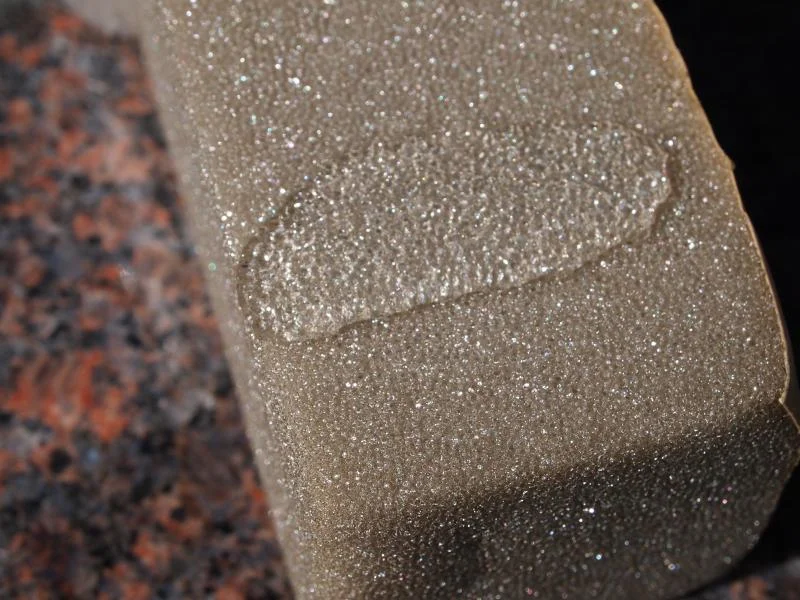

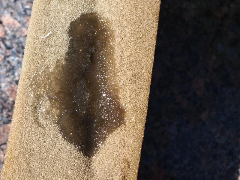

Upon comparing the used coolant packing with the newly purchased one we see old soaking up water and new (warehouse aged) coolant packing does not:

Did the used coolant packing break down over time or was it always sponge like, I can’t say (EDITE 10/8/13: apparently breaks down over time, Toyota states no material change)
The new one appears to be close cell & water repellent but will it keep these properties over time, wil see. (EDIT 10/8/13 Doubtful.)

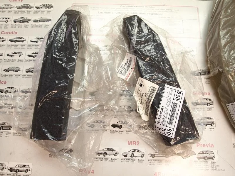

The series 200 use a two piece coolant packing, water repelling foam, black and three times the cost. This indicts Toyota engineers’ recognized the need for a change and the need to keep it in the design.

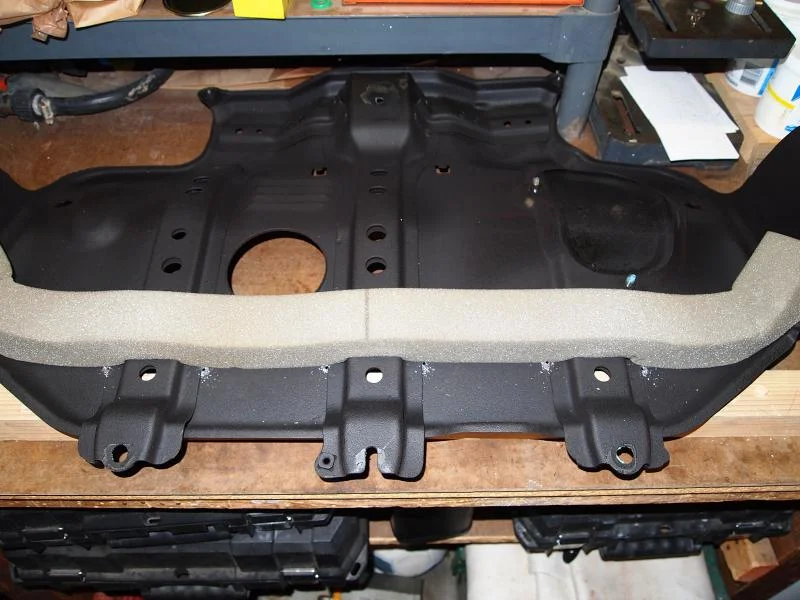

I used rubberized undercoating after de-rust as much as practical, then attached new coolant packing, drilled weep holes and sprayed some additional undercoating.
I RR skid plate & foam as part of my periodical de-rusting & rust prevention program.:banana:
Unfortunately I found the issue too late; it will rust out and be replaced in the future. That will be a great time to go with Slee's undershielding.:bounce:

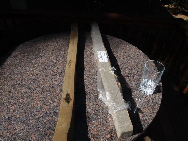

On the subject of the "Coolant Packing". I'm going to replace with a piece from the hardware store, or better yet auto parts store if I can find something that works. Any suggestions?

If your determined to replace it- I might try some skid plate foam suggested earlier in this thread- UNI-Filter makes sheets of it and it's pretty cheap- just fold it over to get your desired thickness-and zip tie it to keep it from unfolding. On my off-road bikes I've made prefilters out of this stuff-& splash deflectors, and stuffed in cracks around the skid plate on muddy days -its good stuff. Its porous so it will drain water, but the fibers won't absorb water.

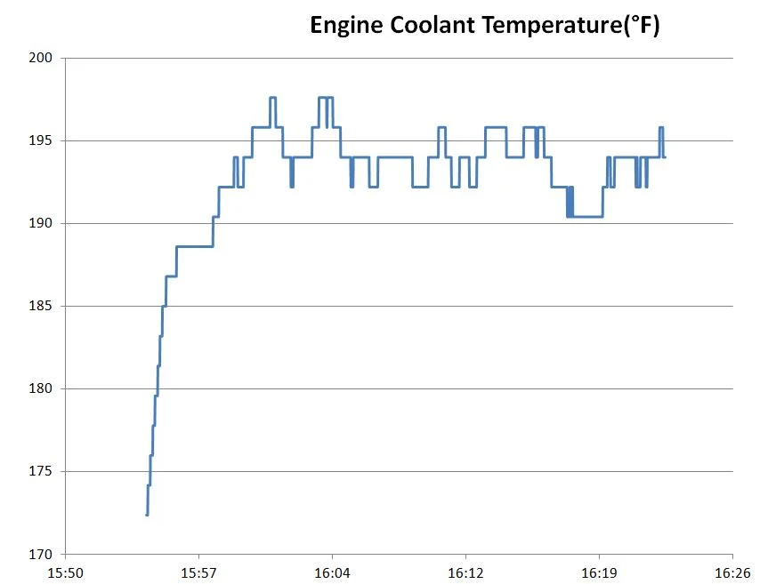

We'll find out Friday. Suoposed to be over 113° here. I'll check temps on the commute home. I have 6 month-old t-stat, heater tees, brand new radiator (original cracked at 240K), new fan clutch, new timing belt and water pump, OEM red coolant, OEM pusher fan (normal on my 2000), diff drop with associated gap in the foam, and Torque pro to measure the temp. So far, it's staying between 185 and 190 with the new gear. Of course, AC on max F/R this time if of year. My money's on it doesn't make any meaningful difference in temps or vibration noise, but we'll see.
Based on your temps, makes me wonder if my temps are abnormal. According to my scangauge I'm running @ 193-195f in 85-90deg air temps- if in stop n go traffic it hovers around 198 sometimes 200 (rad fluid is fresh)
I would "guess" that yours are typical fire for older parts, and not too far off from where mine were. T-stat opens fully at 185°, and my 185-190 temps are with a squeaky clean, brand new radiator, new fan clutch (with audible start-up roar) replacing what I believe to be the original clutch with 240K on it, new fan clutch bracket and pulley, and a brand new water pump with new factory coolant - basically a totally refreshed and optimal cooling system. With grime on the fins, slip in the clutch, and wear on the pump, I can easily see temps going to your range as pretty typical, and doubt they'd have any negative consequences.

113 deg ambient air temps Friday afternoon on my way home from work. Air intake temp 120-130 deg. Fresh everything in the coolant system, rad, thermostat, tees, fan clutch, fluid, water pump, etc. At 80 deg ambient air temps, it's between 185 and 190.
