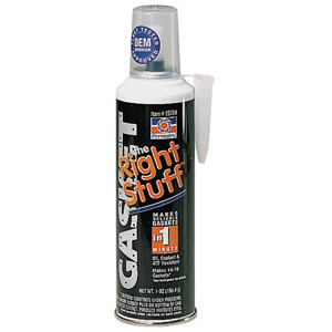

The Right Stuff works so well that I'm willing to buy the aerosol cans even though I know that once opened they have a short shelf life, and its not inexpensive.
